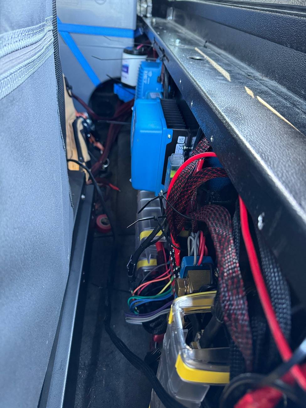

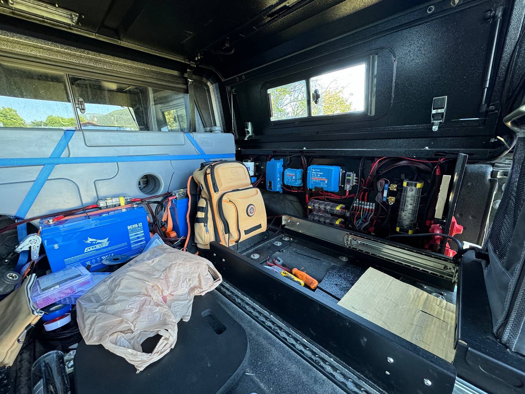

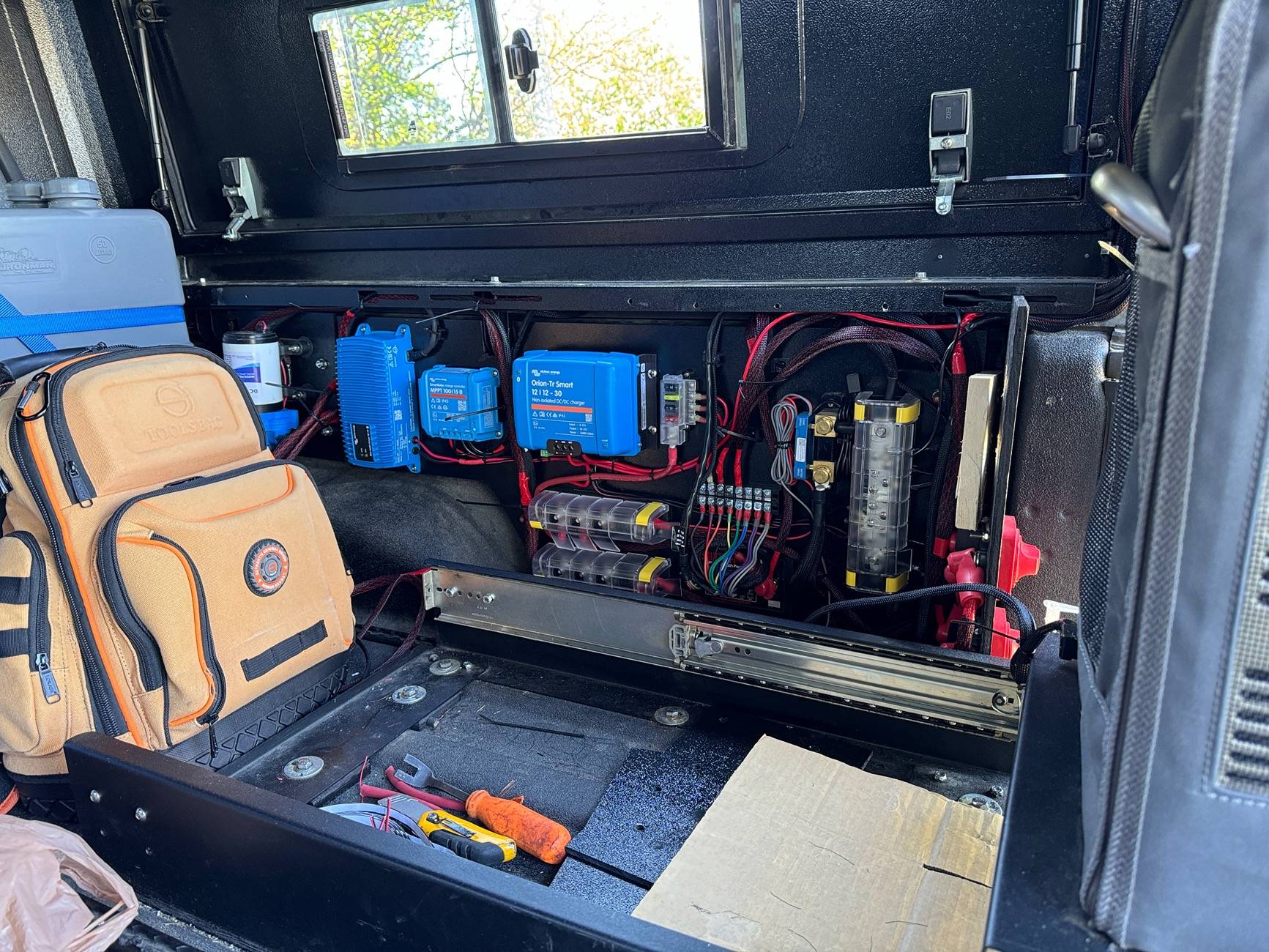

Here you go. My batteries are AGM. But my system design can utilize AGM with a DC/DC charger, AGM directly connected to the starting battery via smart solenoid, or dual lithium batteries. Currently I have 2 115ah FR DC batteries side by side. It also includes a solar controller and a shore power tender/charger than can also be switched into 'power supply' mode if your at a campground with power.
it sits probably an inch behind the wheel well. I am debating making a cover or not. A cover would keep the sun off of things but would also keep heat in and these components do make some heat.

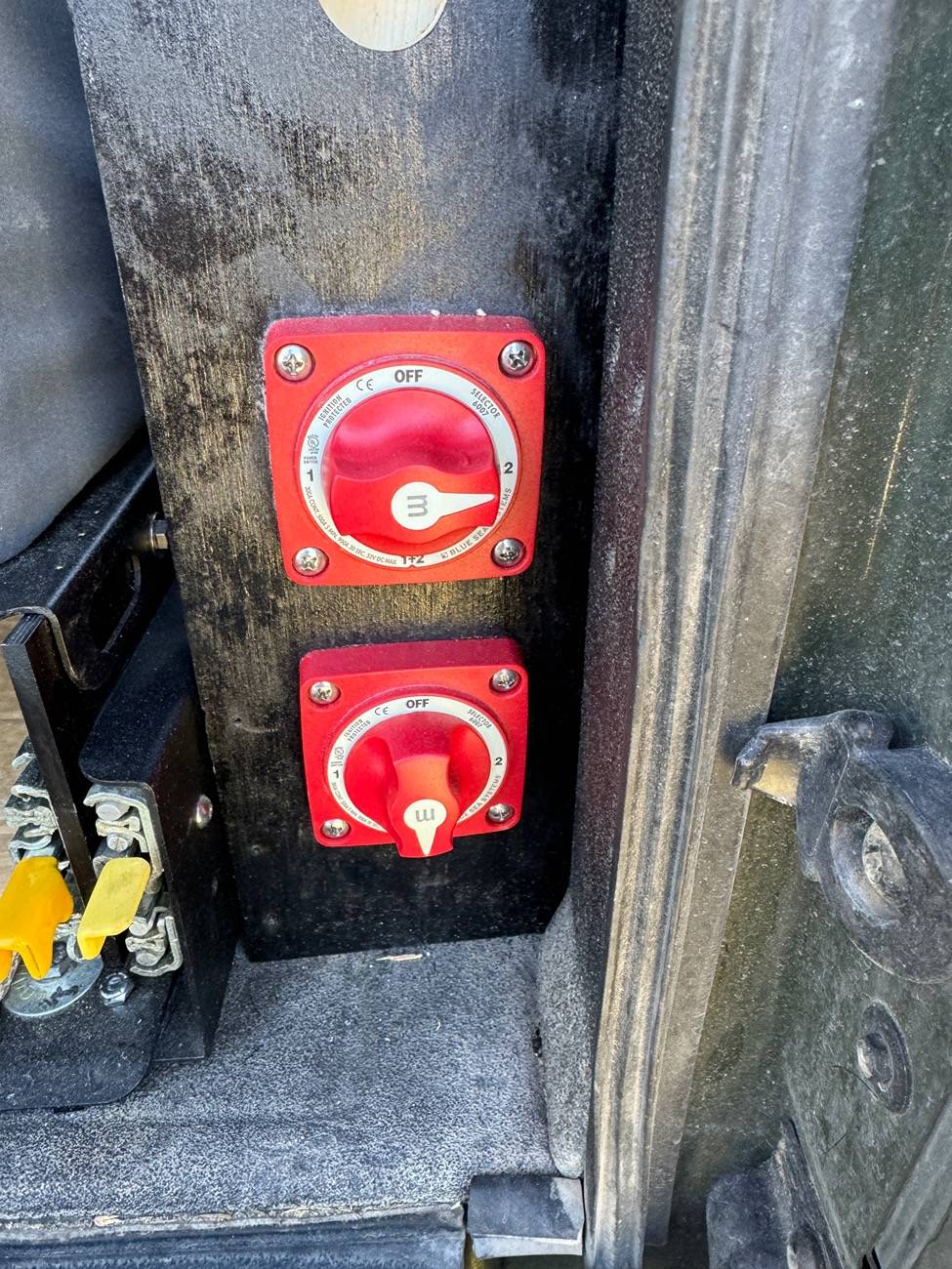

The bottom switch is for the two AGM batteries so that I can have one, two, or both connected in case one needs to be removed or for troubleshooting. The top switch is routing power to the Switch Pros system. So power can come from either #1 which is the starting battery, #2 which is fed by the switch below, both, or none. In the picture above, the bottom 3 terminal fuse block is for the main starting battery to feed to the DC/DC and run the compressor. The 3 terminal block above it is for the switch pros system, inverter, and input from all 3 charging options.
I am currently using dual 115ah Full River DC series batteries. My location is not conducive to lithium and these batteries can be run to 30% SOC / 70% DOD which is more than sufficient. With the way my system is built I can easily run lithium or AGM with no modifications needed, only adjusting via phone ap the charging profiles of the victron components. The batteries sit in front of DUAL 13 gal water tanks and I oriented the batteries side by side for even weight distribution. The water tanks dictate my setup is not conducive to putting on the back wall. I am somewhat contemplating relocating the batteries in the cab under the rear seat delete but that will be a winter project if it happens.

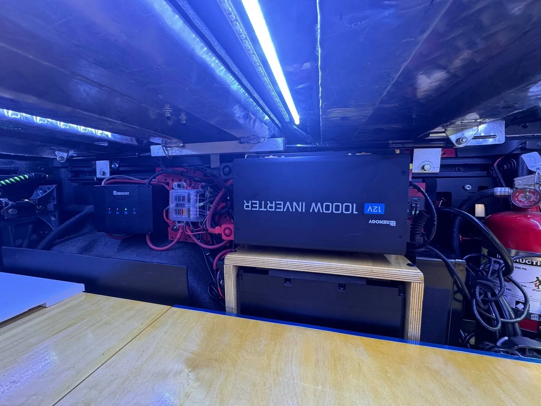

Jeep Gladiator Lithium Battery Mounting Suggestions for the Bed IMG_4311
Jeep Gladiator Lithium Battery Mounting Suggestions for the Bed IMG_4313

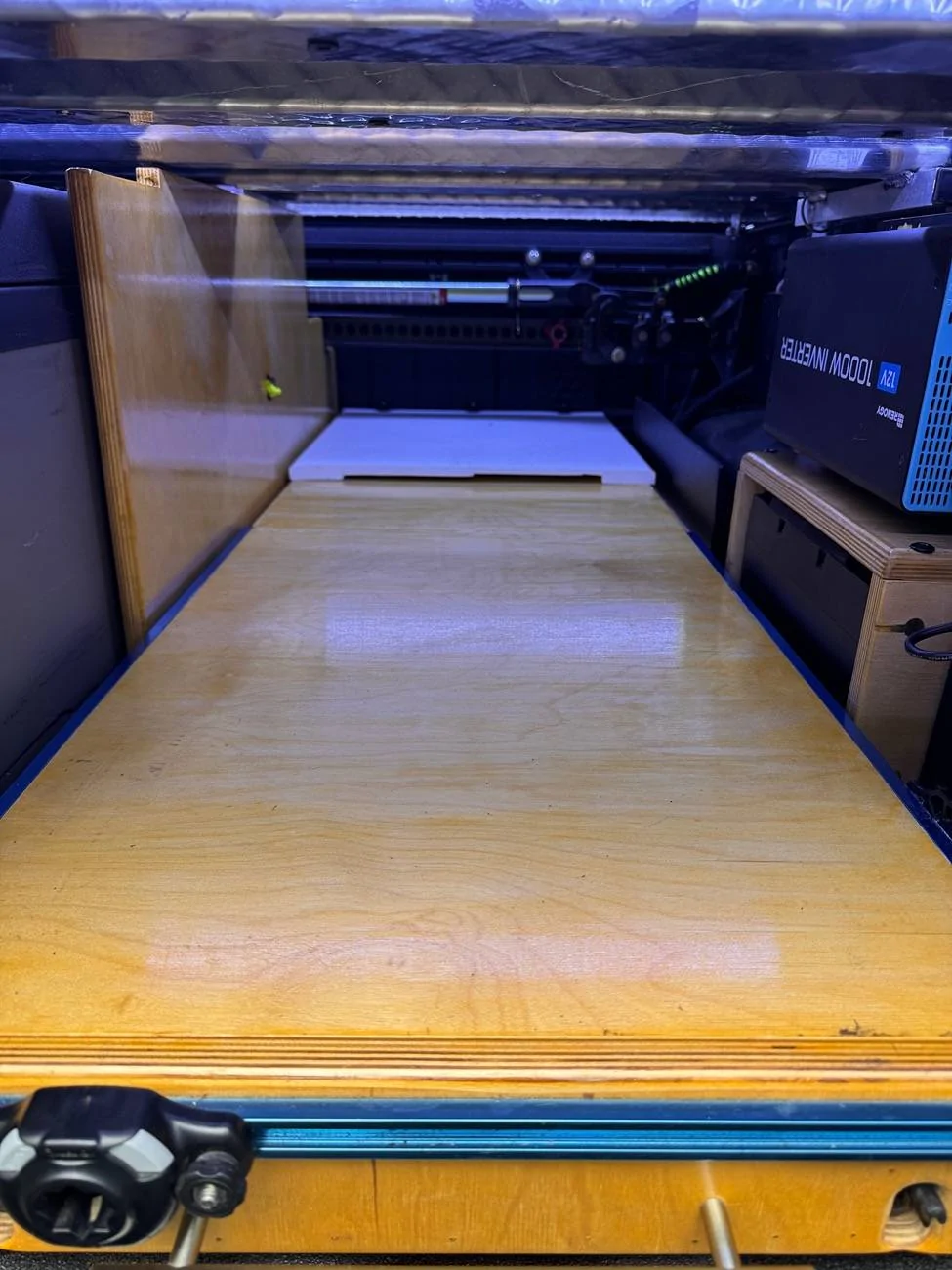

That mess of cables on the right my power and lighting boxes. I still haven’t found a really good way to stow those. The power box is the black thing on the right side of the battery box held on with Velcro
Jeep Gladiator Lithium Battery Mounting Suggestions for the Bed IMG_4309

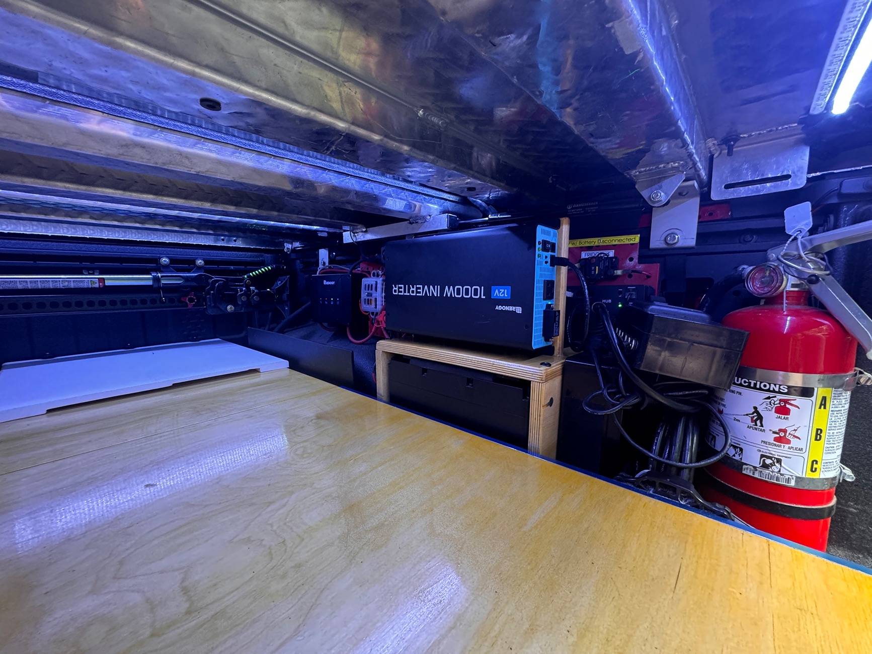

I used a 100AH battery and originally a plastic battery case. I wasn’t happy with that at all and wasn’t impressed with what was out on the market, so I made my own tray out of 14mm baltic birch. The top is held down with M8x60mm bolts in barrel nuts inserted crosswise in the sides of the tray. They’re held in with beeswax. Nothing screws into the wood. I used a combination of high density, compressible foam, and HDPE to hold the battery down tight. This is as solid as you can get. The tray is bolted to the floor of the bed into M8 rivnuts. The holes in the bed were painted, and the rivnuts, rtv sealed. They’re above the spare tire and protected from mud, rocks, etc. Everything is finished in waxed shellac and French polished.

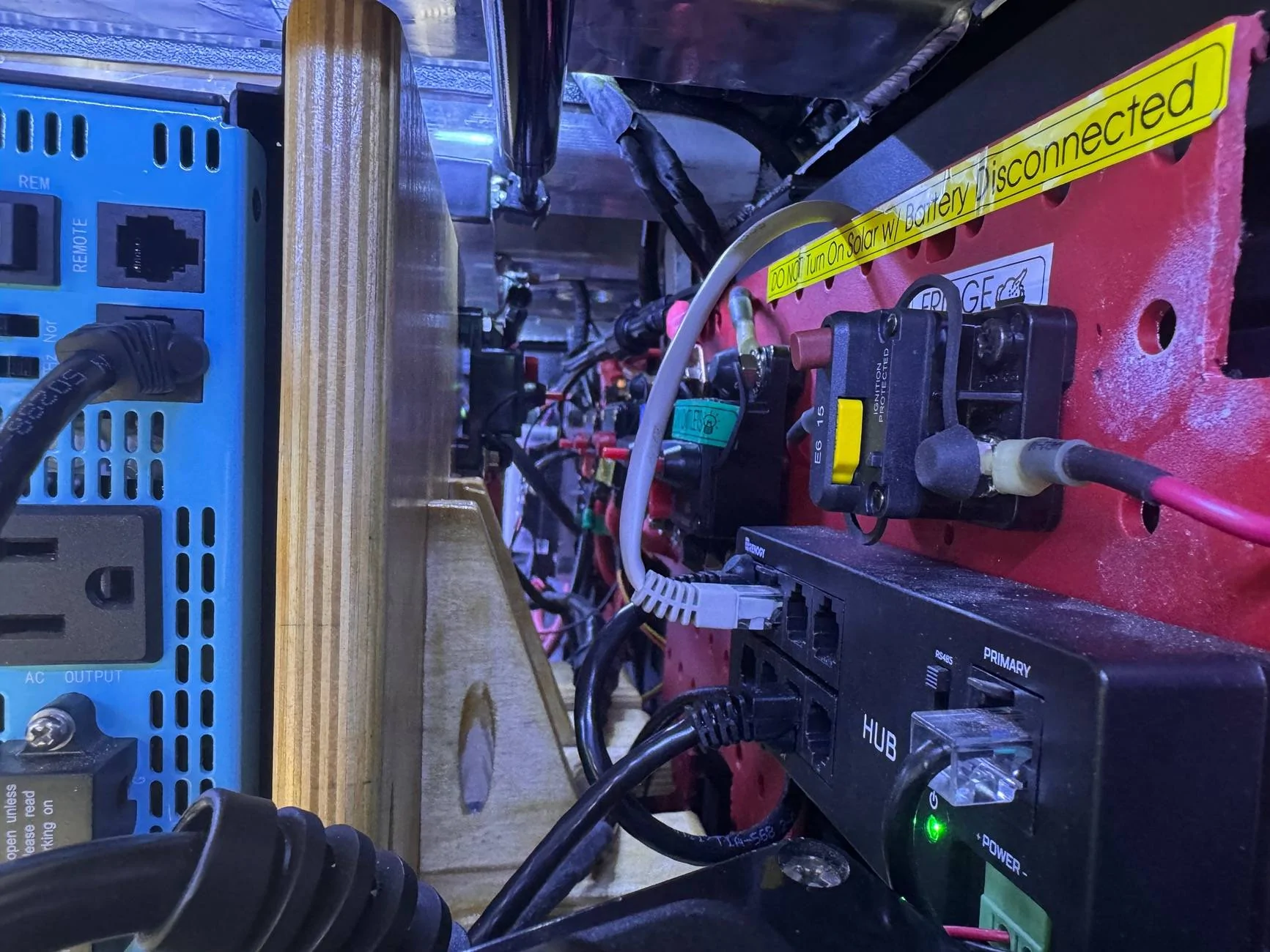

The studs for connecting to the battery are accessible, but protected on the backside of the top behind the inverter mount as are the 2 comms ports on the Renogy self-heating battery.
Jeep Gladiator Lithium Battery Mounting Suggestions for the Bed IMG_4312
The tray along with all of the circuit breakers, dc-dc charger and distribution blocks all stand off from the side of the bed with air flow all around them. The breakers, charger, and blocks are mounted to plastic pegboard which is mounted to JCR molle panels. Wiring is run behind the pegboard.
Solar panels plug into an external water sealed outlet that’s mounted to the underside of my Front Runner rack There’s a power box with 2 60w USB-A/C charges and 2 12v sockets on a 10ft cable and a 6 port lighting control box with dimmer on another 10ft cable. The ARB screw in socket is mounted to the other side the bed.
I’ve found that my 63qt ARB runs essentially indefinitely on solar power with this setup using about 10% of the battery overnight along with lights, fans, etc. I carry 300w but find that the 100w mounted panel is usually all I need.

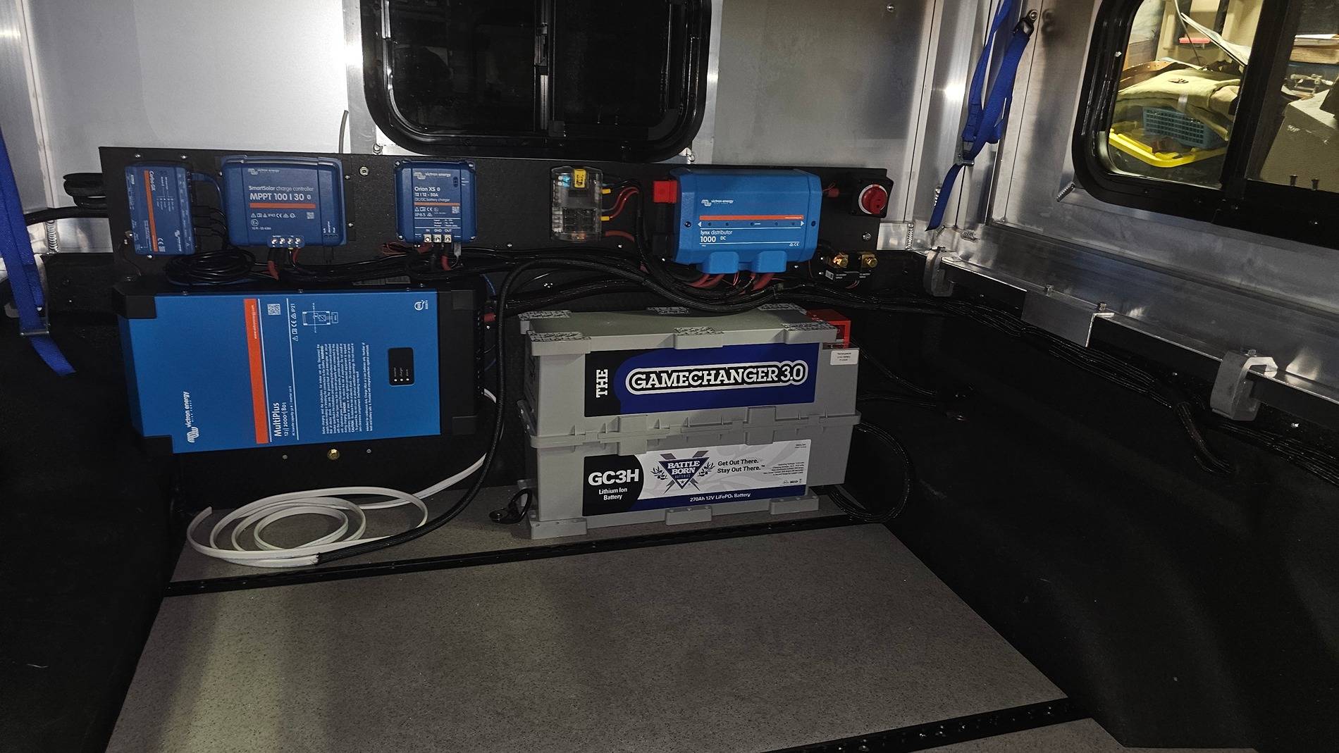

I see you got it back! What solar panels did they go with?
They used the Sol-Go 115w flexible panel. We were hoping to squeeze four of them on the roof, but ultimately settled on three. The fourth would have had a section exposed to road debris so we decided against it.
