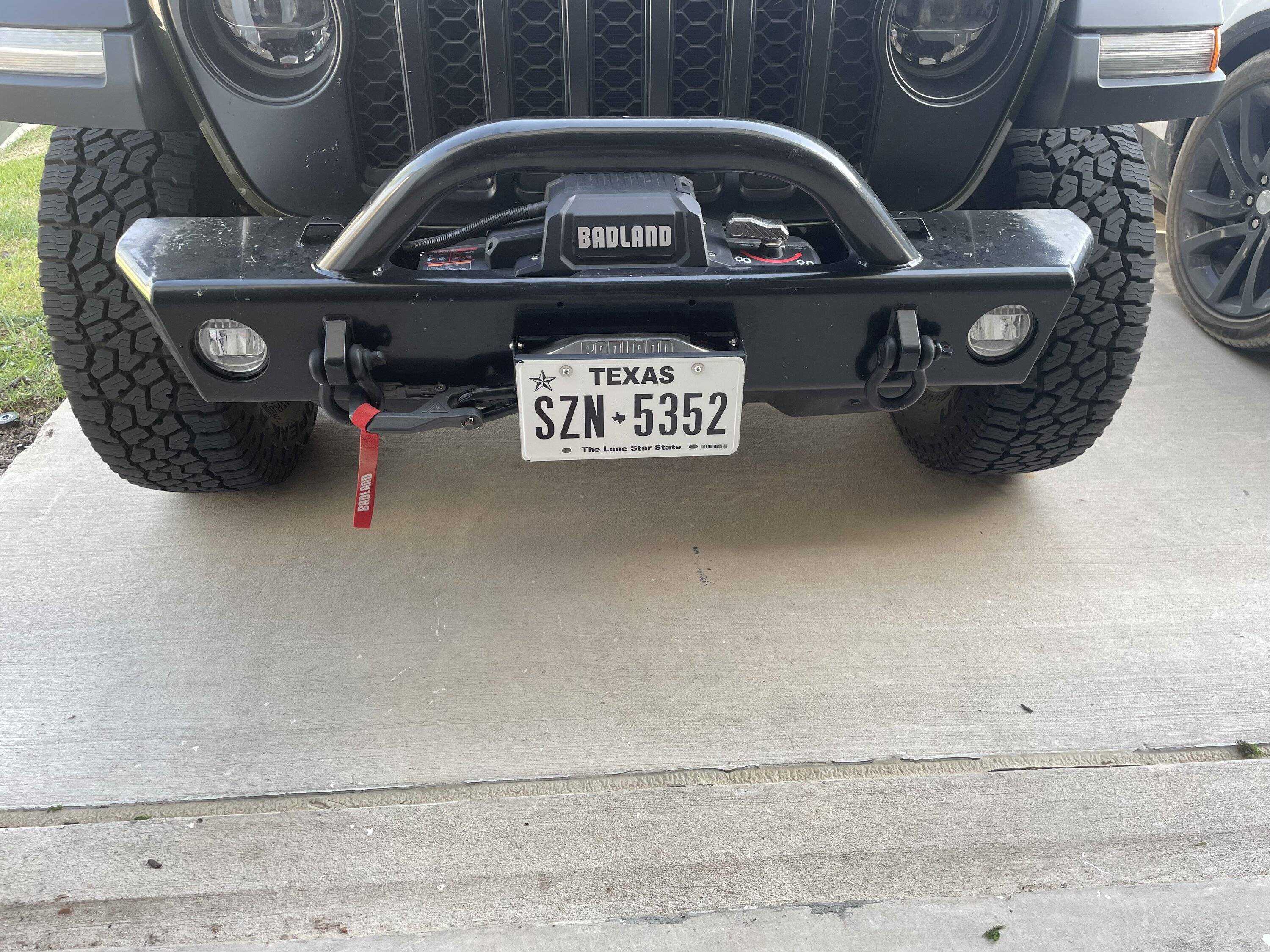

The winch will server you well without question. I've had this model and have used it several times without issue. I did have to return one for warranty but this was for me pinching a wire and not a failure of the winch itself. I can share more on that if you are interested.
As for the bumper, I think I will pass. First and foremost, the 12k winch will pull hard and the bumper you've selected puts the winch at a mechanical advantage against the frame by sitting above it. I personally went with a bumper from Schrockworks (now out of business) that puts the winch in between the frame rails. Another issue to consider is airflow with the winch sitting in the center of the grill and in front of the radiator and A/C condenser.

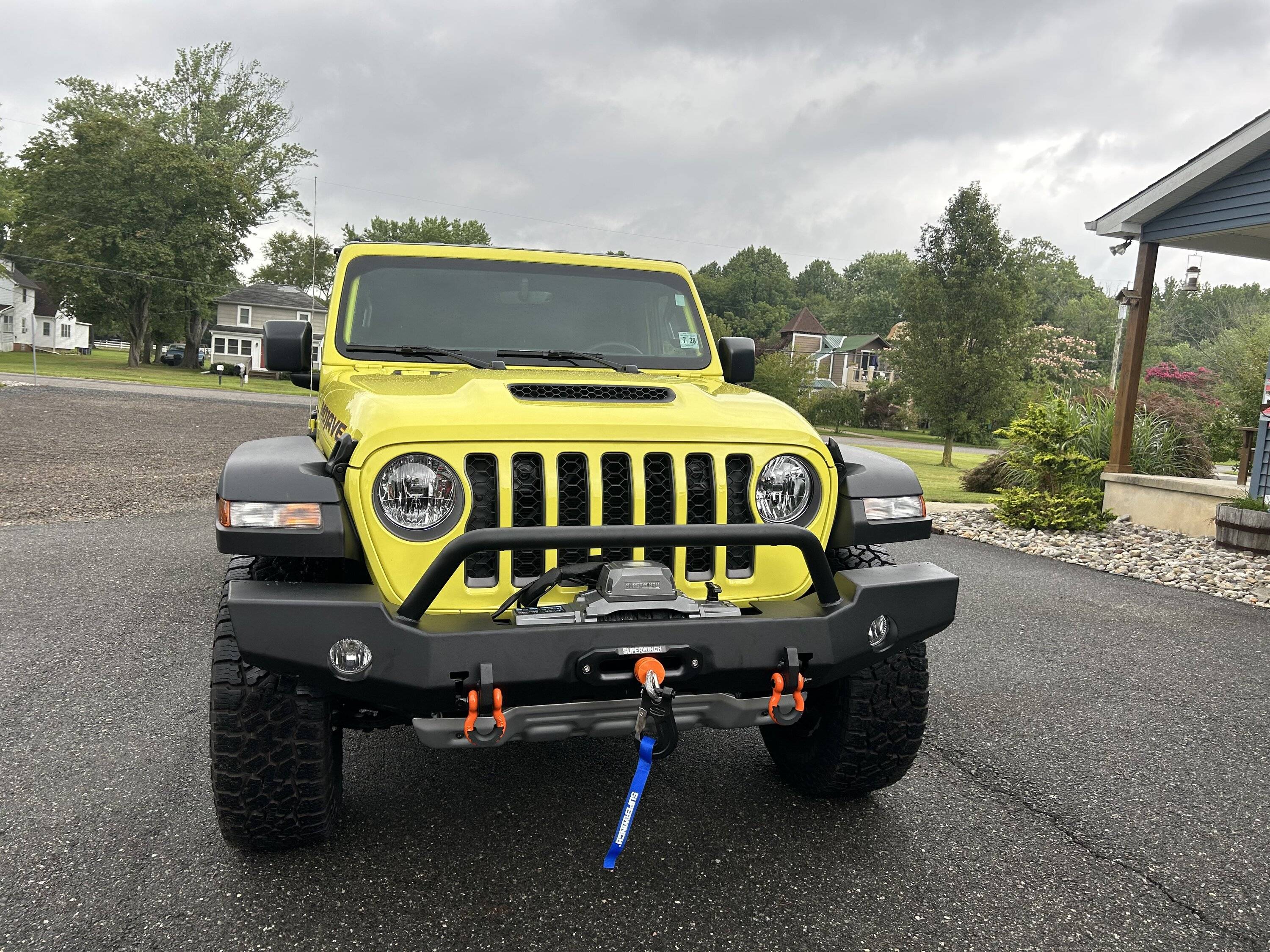

I installed a full Westin with 12,000 lb superwinch. I added a 1” Terflex puck to bring the front back up as it sagged. Everything went on easy…factory lights, skid plate, etc.
HipFish
Keith
Aug 1, 2023
S. Jersey
2023 Jeep Gladiator Mojave
Jeep Gladiator Looking to replace my front bumper with............Thoughts? IMG_1330
They make a shorty as well.
