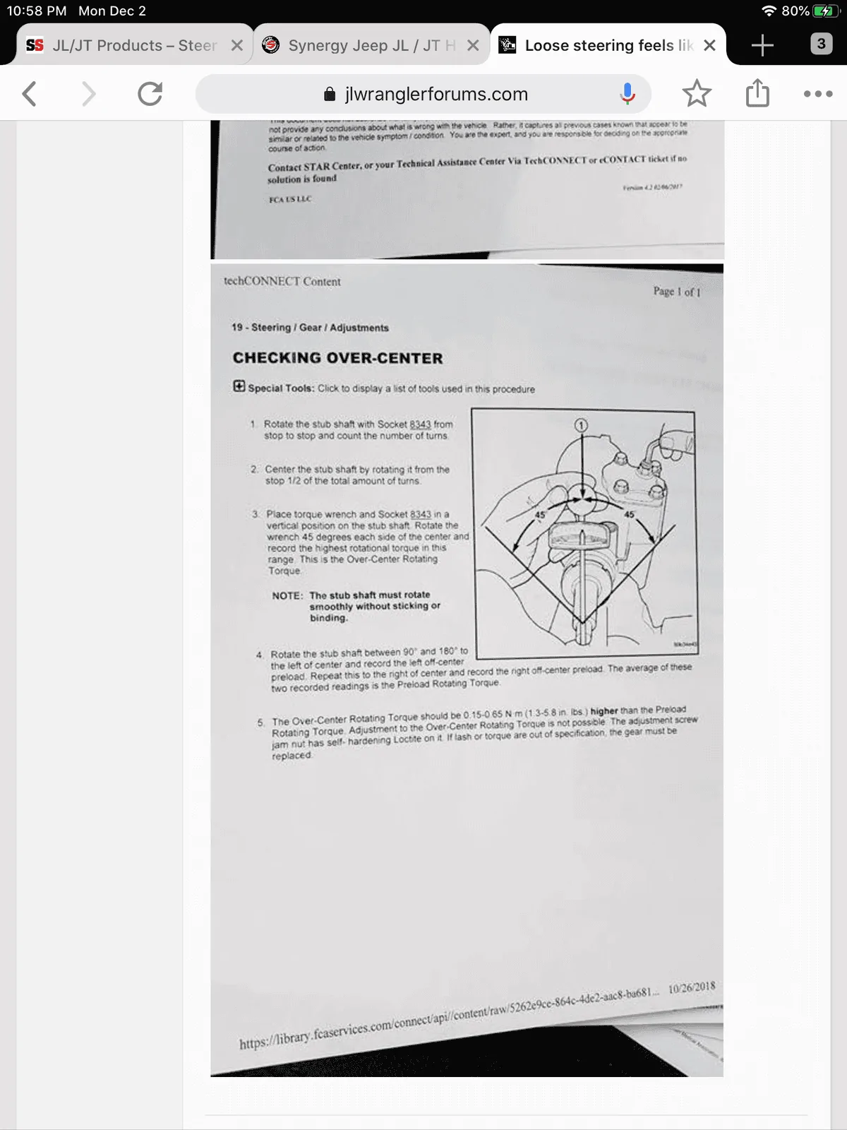

Jeep Gladiator Loose Steering? 15CA65AC-FF48-4BD9-874F-5116087A5B84
Slalom
Jan 4, 2020
Georgia
Jeep Gladiator Rubicon
Let's just start out by saying I am very reluctantly posting this for obvious reasons. I am absolutely no expert. After FCA denied me on getting a new steering box and wouldn't give my dealer authorization to make an adjustment I took matters into my own hands. My steering is now fixed. I felt that I had read enough and consulted with enough people that in my case it was the right thing to do. My steering was never bad enough that I felt like I was putting my life or someone else's life in danger. It was just aggravating enough to where I hated driving it and was almost ready to sell it. Been driving Jeeps most of my life but this one sucked for one reason, the steering.
Please don't ask me how I fixed it there are enough threads on that. I will say that I had help from a friend that owns a shop next to where I work but that was mainly for moral support. I will say that the Allen screw is not aluminum, put a magnet on it. Also, at least on mine there was no loctite. The steering now has the slightest bit of play, maybe about an 1/8 of an inch. Probably a good sign it is not too tight. I am completely satisfied.
