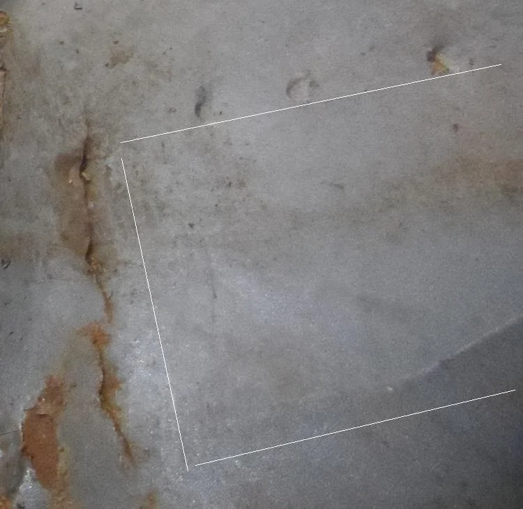

Yeah, some videos show enough flex I'd be wondering about metal fatigue later down the road - maybe not so bad stock, no or little lift, 33s, etc. but more tire, more lift, more stress.
Even steel can only handle so much.
Here's how a floor cracked both sides behind frame rails from flexing - VERY VERY slight movement of the structure and finally it couldn't handle it any more.
Jeep Gladiator Loose steering-dealers response right-floor-frame_3827
