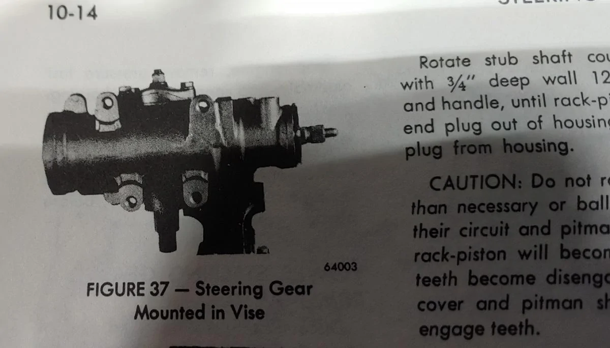

That thing YOU call a steering box IS the steering gear.
Those factory trained or those who have worked in the parts department (which I have done) will say steering gear or steering sector when referring to that thing the pitman arm is on.
The terms are used interchangeably - meaning you can say steering gear - and it MEANS steering sector.
In short: Steering GEAR = steering sector
No manual, no parts listing I have ever seen will have "steering box" -that's shade-tree, or slang, used on the internet when people don't know what it really is called.
If anyone wants, I'll go pull out my big fat thick parts books.
Below are pics from one of my TSMs. They clearly show the steering gear as being what some on the web call the steering box.
If a mechanic says steering gear, they are referring to what YOU say is the steering "box".
Box is slang. Box is easier to say and covers a ton of possible configurations - power, non-power, and more. The correct technical term is "steering gear".
There won't be any confusion in the shop.
To ease your concern, please see below - I can also post entries from parts books showing that the whole shootin' match is the steering gear.
Here's the steering gear in a picture - note, the FACTORY calls this thing YOU call a box, the "steering gear" ->
Jeep Gladiator Loose Steering? 20200826_074035
Again, called "steering gear" - also note they talk of "steering gear repair" on the right - you don't repair actual gears, so they are referring to what novices call the "box"
this is how to take it apart, service and repair it ->
Jeep Gladiator Loose Steering? 20200826_074016
I also have entries from parts listings if needed.........

I can confirm after just returning from the dealership and having the work done as specified in the TSB, they do replace the entire steering gear (what you see in the image, figure 37). Steering is more responsive and there is no longer a huge dead spot. I have not had the vehicle up to highway speeds where I was having the most issues. Will report back when I do. I look forward to no more white-knuckle Mr. Toad wild rides on the highway.

Only you are confused, trust me, the shop won't be.
