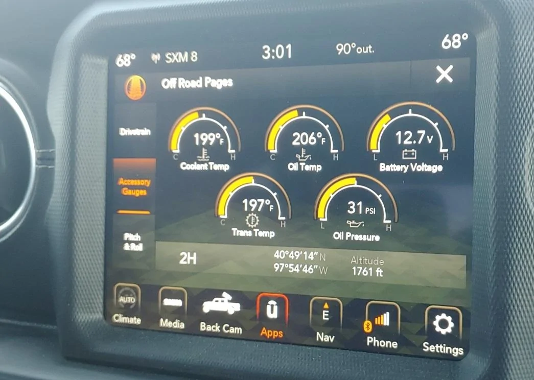

Apparently its normal for the Gladiator, and we should be concerned primarily if a battery icon shows up while driving. I received two charging system email warnings now, but had two dealerships say everything is normal. Highway driving is 12.7-12.9V... coasting or braking and it jumps to 14.X. I always turn off ESS.
We used to consider a fully charged normal battery as being 12.6 volts. If the JT system is showing 12.7 or better, it means it's keeping ahead of demand and the battery needs.
If I saw 12.5, I'd be concerned. 12.6 might make me wonder if it was having trouble staying cool.
I saw temperatures of 230 on this trip - but everything was working absolutely perfectly - AC, lights, everything. No errors, ESS worked fine. This was taken over a month ago and it's still fine ->
Jeep Gladiator Low charging or paranoid? 20210613_150145
