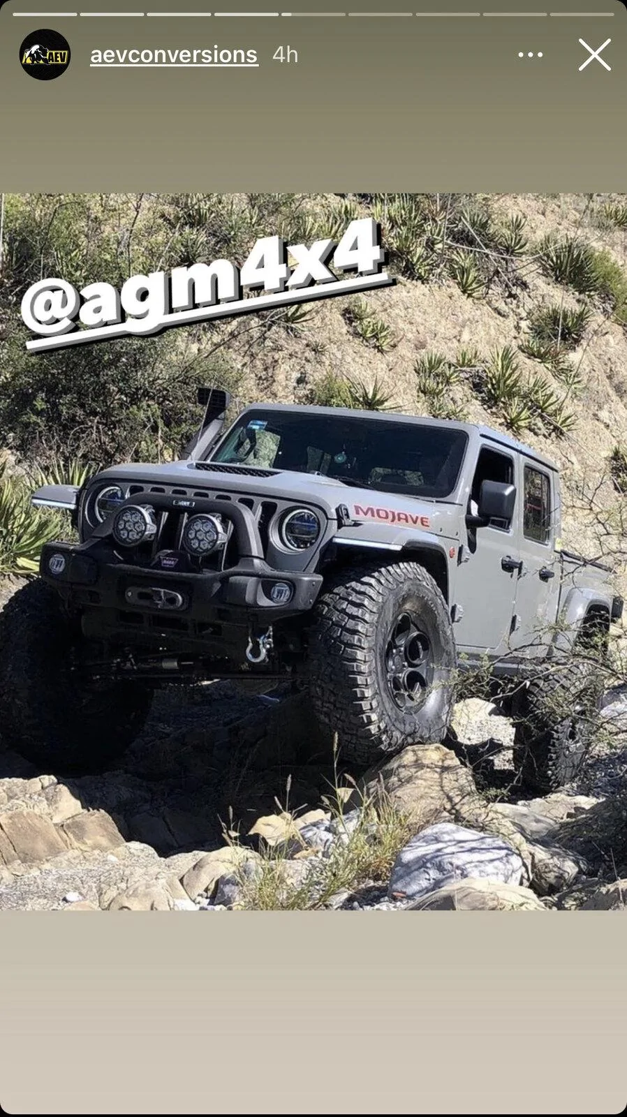

Not fully true. See above. Weā€™ve seen both the Holley and the AEV fit the Mojave. Details are sparse on how, but its possible.
Holley never shipped mine so I ordered the AEV. I know it fits, its just a matter of making it.

The AEV and mopar both will fit the Mojave and more then likely others like it, with slight modification to one of the brackets. Itā€™s really not that big of a problem to solve. Then the only thing to worry about is cutting the hole in the hood.
The hood sits higher so you will not be able to use the exact template they supply.
When I do mine, I will install everything first and get the snorkel secure and then work on cutting the hole last. If you measure well you will be able to get it were you need it to be. I would start small and work my way out until I get a nice tight fit around the snorkle.

Iā€™m aware of what the website says. Im telling you and showing you that AEV has posted photos themselves of it fitting on a Mojave, it obviously fits. But as Rubi-zero said, its the hood cutout that is different. Thats the only part that could be different. It would have to be a custom cut. Any shop with an ounce of confidence could install it nicely.
