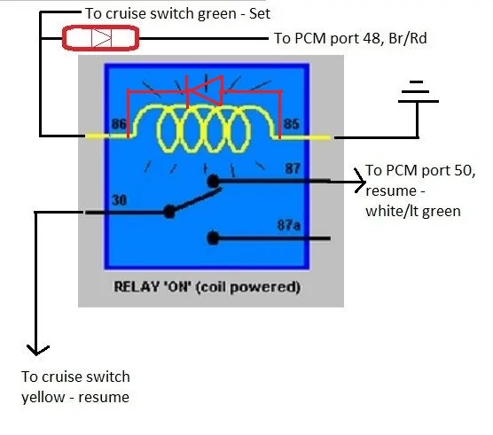

I did an entire engine change, PCM, PDC and custom engine bay and dash wiring harness to get cruise in my 82.
Then I found the NOS turn signal stalk with cruise control switches worked almost opposite of what the donor Jeep's PCM was expecting, so had to make a circuit to convert the switch signals and put in a VSS between speedometer cable and transfer case to get cruise in my car.
Jeep Gladiator Manual to auto headlights question cruise-relay-on-diode-3

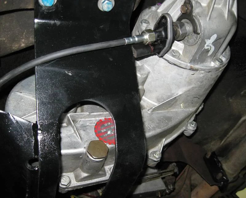

VSS from a Dakota -
Jeep Gladiator Manual to auto headlights question sx4-060
But now I have cruise in my car with a T5 manual transmission.
