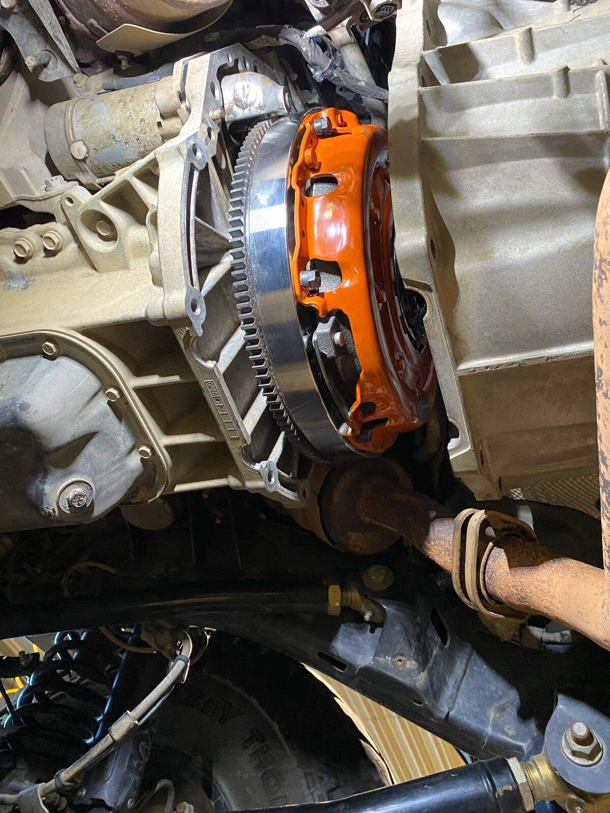

I did consider south bend but all I saw was another dual clutch /dual mass flywheel (complicated) clutch and I was looking to go to heavier flywheel, a gripper clutch to simplify and improve offroad and towing. My Centerforce clutch is in and I’m breaking it in now. So far it’s great - it engages lower in the pedal travel and more positive. I can backup without throttle. Once the break in is done I’ll find some time to do the 20degree hill test and offroad test to report back. Here is the stock clutch in a 20degree hill at idle for the before video.
Well, Sparty, I have now called every South Bend dealer in Middle TN. Two of them have dropped their dealer relationship with SB and two said they don't see anything noting their clutches compatible with the Gladiator. That was enough for me to decide to focus on the Centerforce.
Not saying that SB doesn't make a fine product but if they have a lot of dealer turnover AND don't keep their records updated to note what is compatible with a Jeep line that is going on it's 3rd year of production..... well, you get the picture.

Good luck. I’ll be pushing a new video soon showing initial impressions and part 2 hill test. Spoiler alert - this is how the clutch should be. It has a bit of effort and you can feel the engagement but it’s not tough or unrefined. It’s just better all around.
here's the new video . check it out!

One other question, if I may. You state in your "unboxing" video that the Centerforce flywheel, with packaging, weighs around 44 lbs, if I remember correctly. Do you remember what the OEM flywheel weighed after removal??
I haven’t weighed it yet but I suspect it a fair amount lighter. I haven’t had a chance to unbolt it but I’ll be sure to do this soon a d report.
