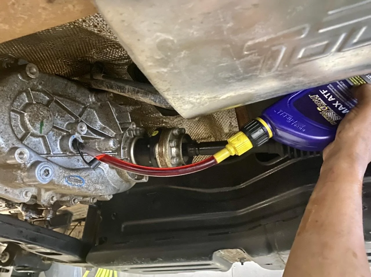

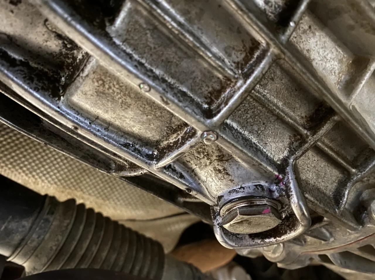

A little later than I was hoping for, but finally replaced the fluids and new sealant for the leaky trans plug.
Does feel nicer with some new fluid in it tho and up to proper fill again.

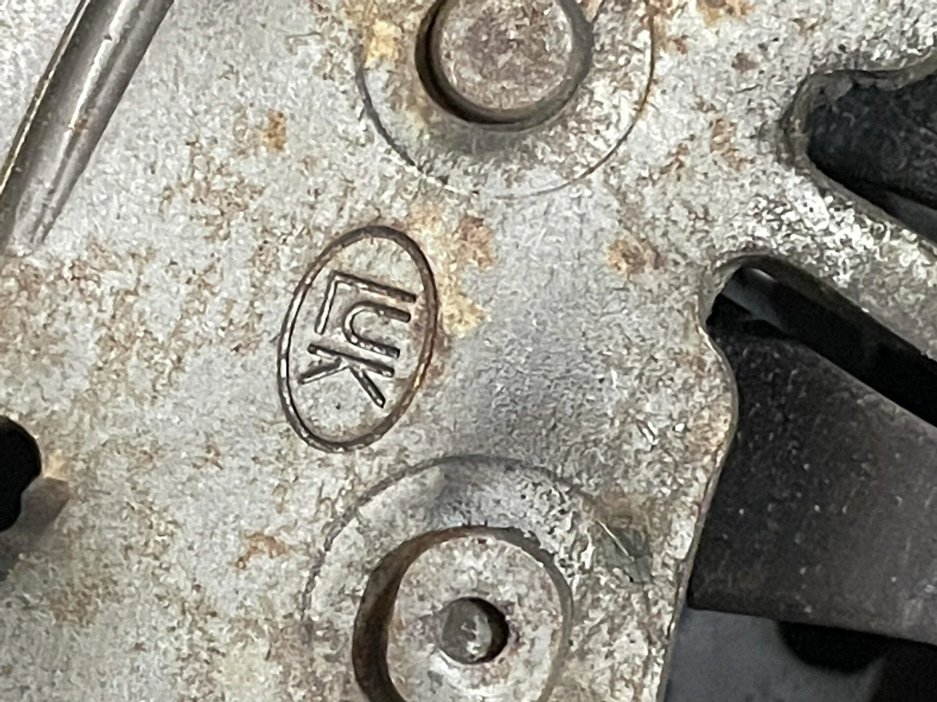

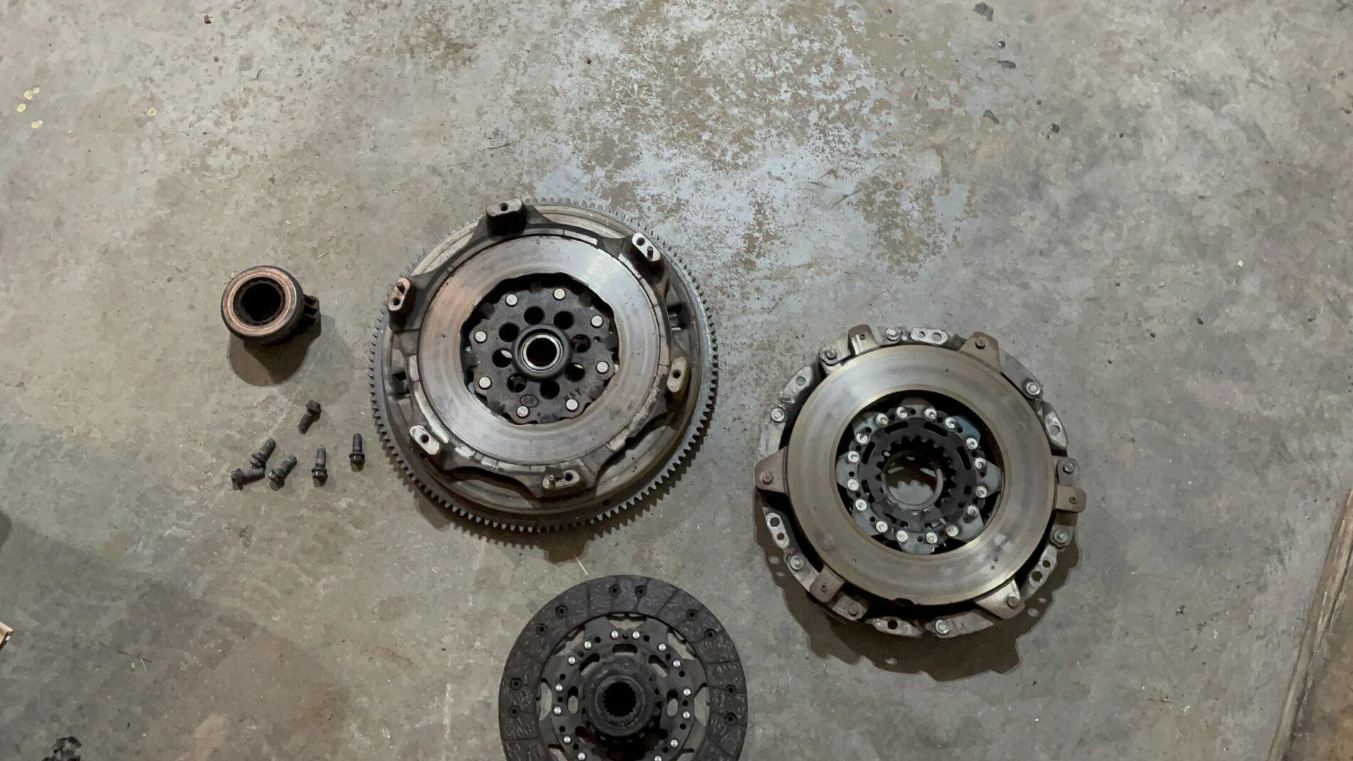

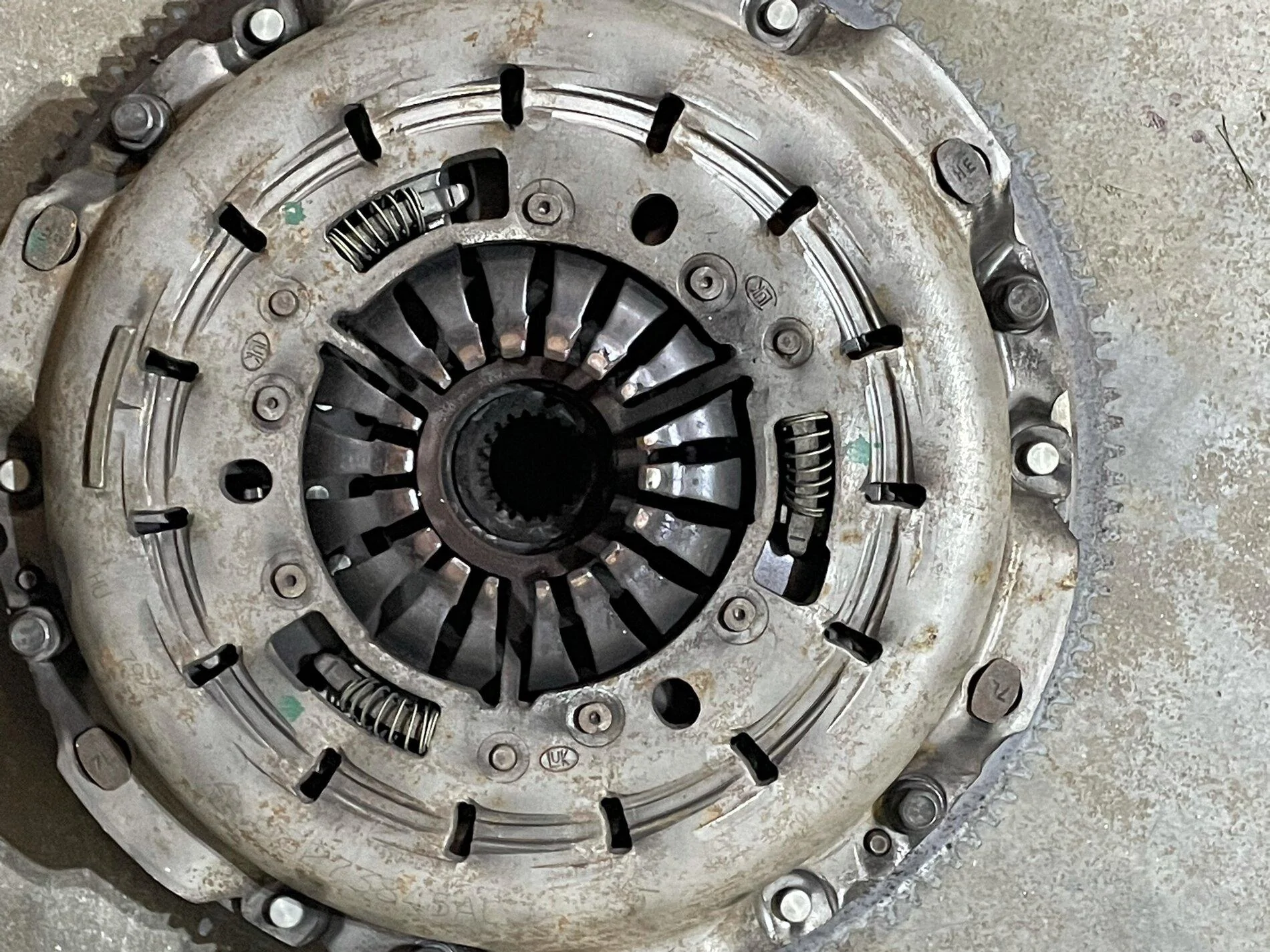

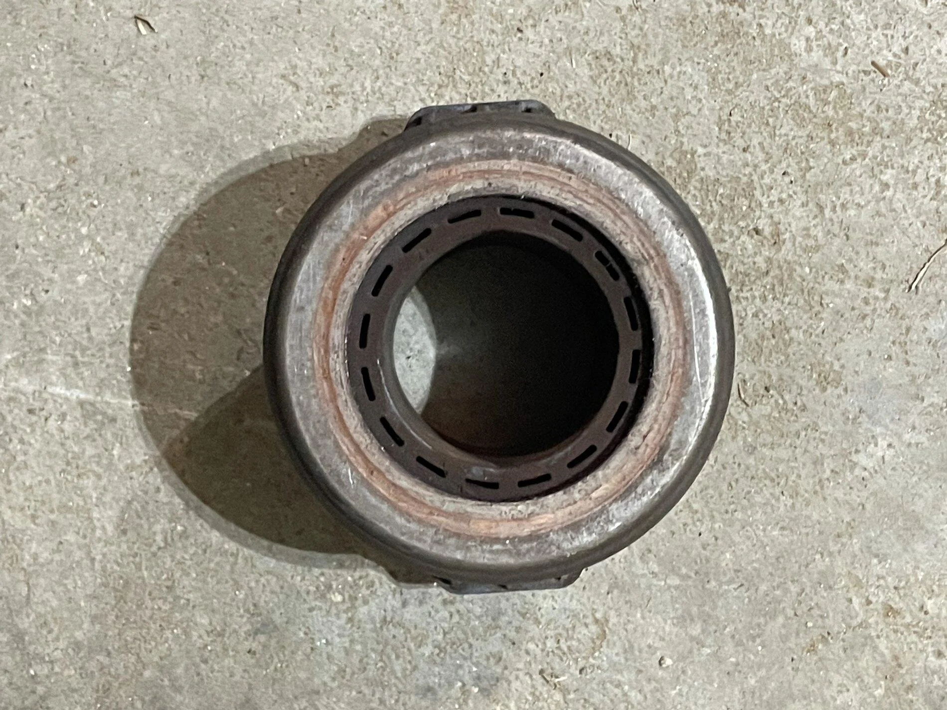

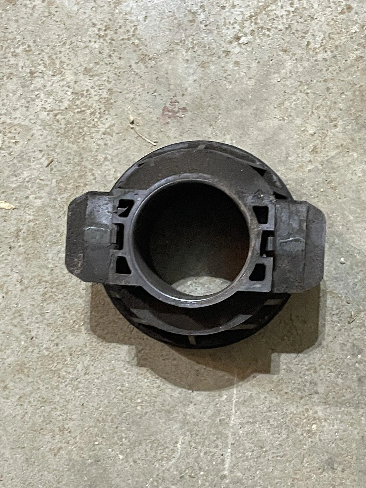

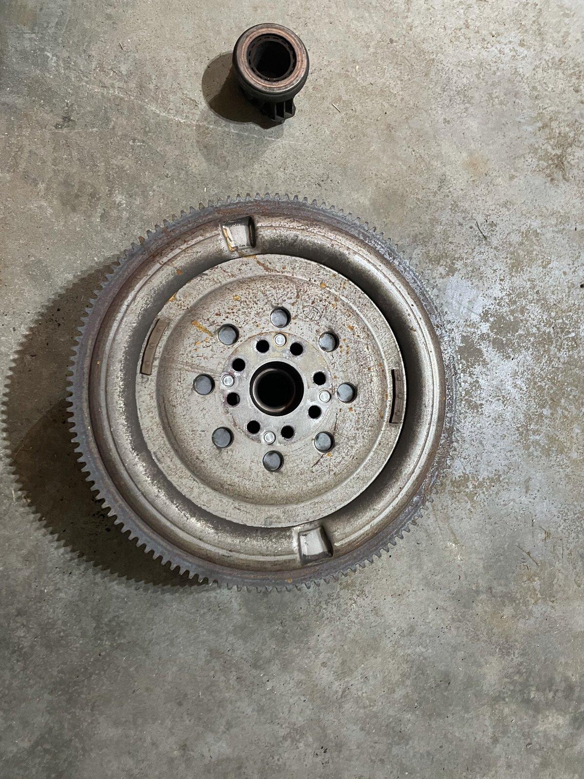

Some pics of the stock clutch in case anyone is interested. It’s LUK brand.
Jeep Gladiator Manual Transmission Club 5B5E9B5A-7B16-4526-8CCF-15021839C5CE
Jeep Gladiator Manual Transmission Club 88924E00-4FE7-40A9-9116-2ABA99013A27
Jeep Gladiator Manual Transmission Club 5CAC219E-ABD8-4620-B019-3DFC250AD804
Jeep Gladiator Manual Transmission Club 14A6B79E-4953-4750-9DFE-2B37F78A3A0C
Jeep Gladiator Manual Transmission Club CCEC2151-9869-48D1-BDCE-42B6A4AC4012
Jeep Gladiator Manual Transmission Club 7C0F9E46-317C-4AC5-85C4-D212C347CC9E

I did consider south bend but all I saw was another dual clutch /dual mass flywheel (complicated) clutch and I was looking to go to heavier flywheel, a gripper clutch to simplify and improve offroad and towing. My Centerforce clutch is in and I’m breaking it in now. So far it’s great - it engages lower in the pedal travel and more positive. I can backup without throttle. Once the break in is done I’ll find some time to do the 20degree hill test and offroad test to report back. Here is the stock clutch in a 20degree hill at idle for the before video.
You know what?
You mentioning the SB clutch was also dual mass - I didn't know the JT has a DMFW, but now the stalling in your video makes *perfect* sense!
I work for an OEM as a "tuner" (powertrain calibration) and I know that we have an algorithm that will kill ignition to the engine in case the RPM goes below a certain point. Even if the engine will run there, we don't want it to because too low of an RPM can excite the dual mass flywheel and damage it.
Hopefully, the heavier solid flywheel will keep you out of this area, but if you do still stall - I wonder if @DAVECS1 can look into the MT trans cals and see if this is something that can be changed.
Looking forward to the next video! ?
