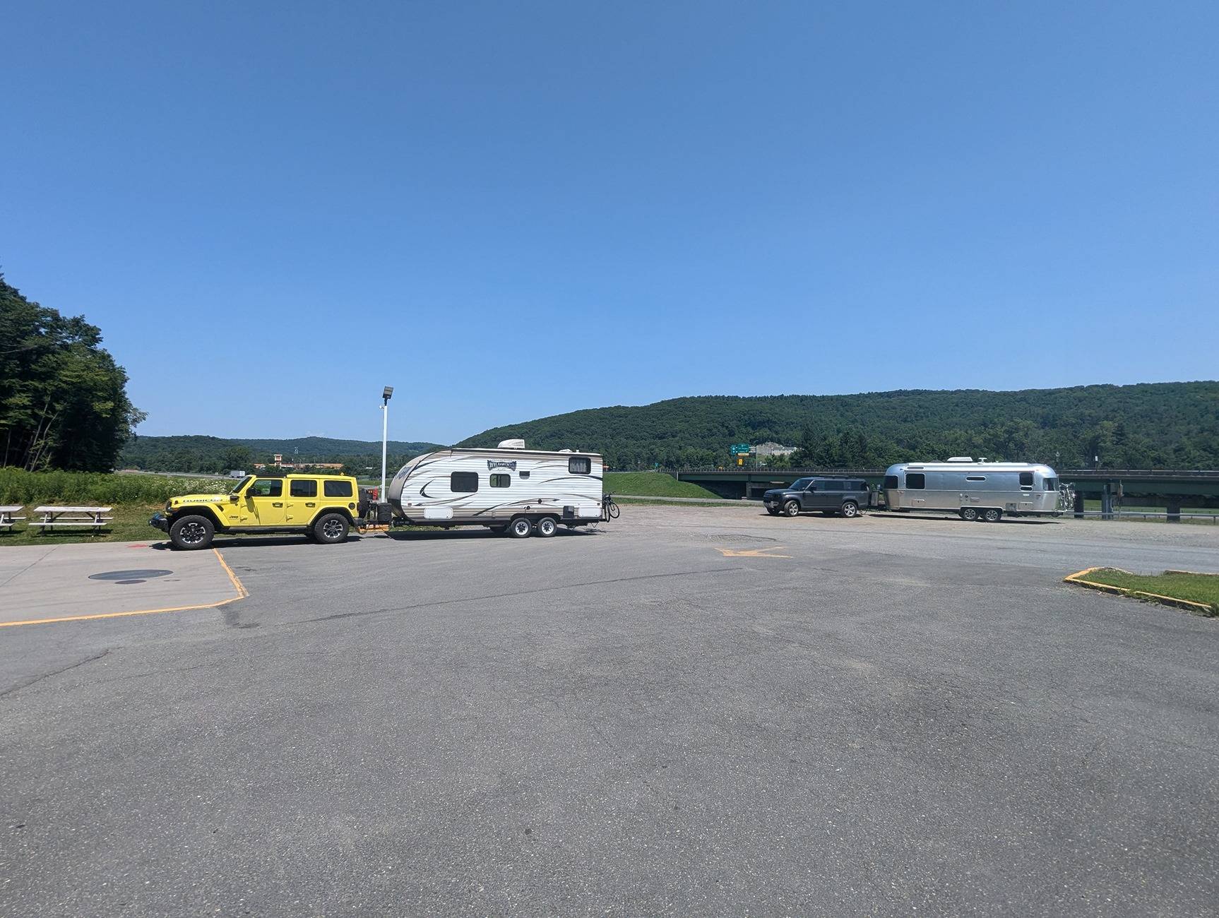

Having a Wrangler 4xe, everything is the same as the 5000lbs rated Wrangler versions but the limitation is cooling, so I don't really see how they can get the gladiator to 6000lbs plus towing given that limitation. I hope they do, I'll buy one
I've towed 5000lbs with my 4xe and had to slow down some on really big hills in 80 degree plus weather due to heat. On the mass tpk there's a stretch that goes from 200' elevation to 1700' in a straight climb and on an 85 degree day I had to gradually slow from 65mph to 55mph to keep the engine temps under 240. That was the only limitation, otherwise it has tons of power and no stability issues. Trans never got over 205 degrees, battery power never got reduced. It's purely cooling limited. 9mpg average on a 2k mile trip towing a 5000lbs loaded camper from VA up into Canada and back in July.
No, it's not the same......... the rear axle is different.
You'll only tow a load with the engine running. We've discussed this to death on the dedicated 4xe forums. The electric motors on these can't handle a sustained load at highway speeds and will kick the engine on to reduce the load and amperage draw on the electric motor. Otherwise, even just driving in hot weather that engine may kick in now and then to reduce the load - and temperature - of the electric motor sitting in the front of the transmission.
Imagine that sort of a load on a 2.0 turbo and that sort of heat - 240 degrees, that oil has to be suffering.
That's not a Wrangler I'd want to buy used.

What? Of course the engine is running, but it gets hot. I didn't get reduced battery power but had to slow to keep the (gas) engine under 240.
The '24 Rubicon 4xe has the full float rear axle. https://s3.amazonaws.com/chryslermedia.iconicweb.com/mediasite/specs/2024_JP_Wrangler_4xe_SP.pdf
Notice where it says rear axle: Dana 44 hd full float (Rubicon 4xe).
Prior to '24 doesn't. The 392 and 4xe have reduced towing because they are cooling limited. It's a bummer because the 4xe drivetrain is excellent for towing, lots of low end torque. It works well and does not cut power. I think this is why the gladiator 4xe has been delayed for so long, they are trying to get the cooling to where it's not severely limited in towing. I don't have high hopes tbh.
