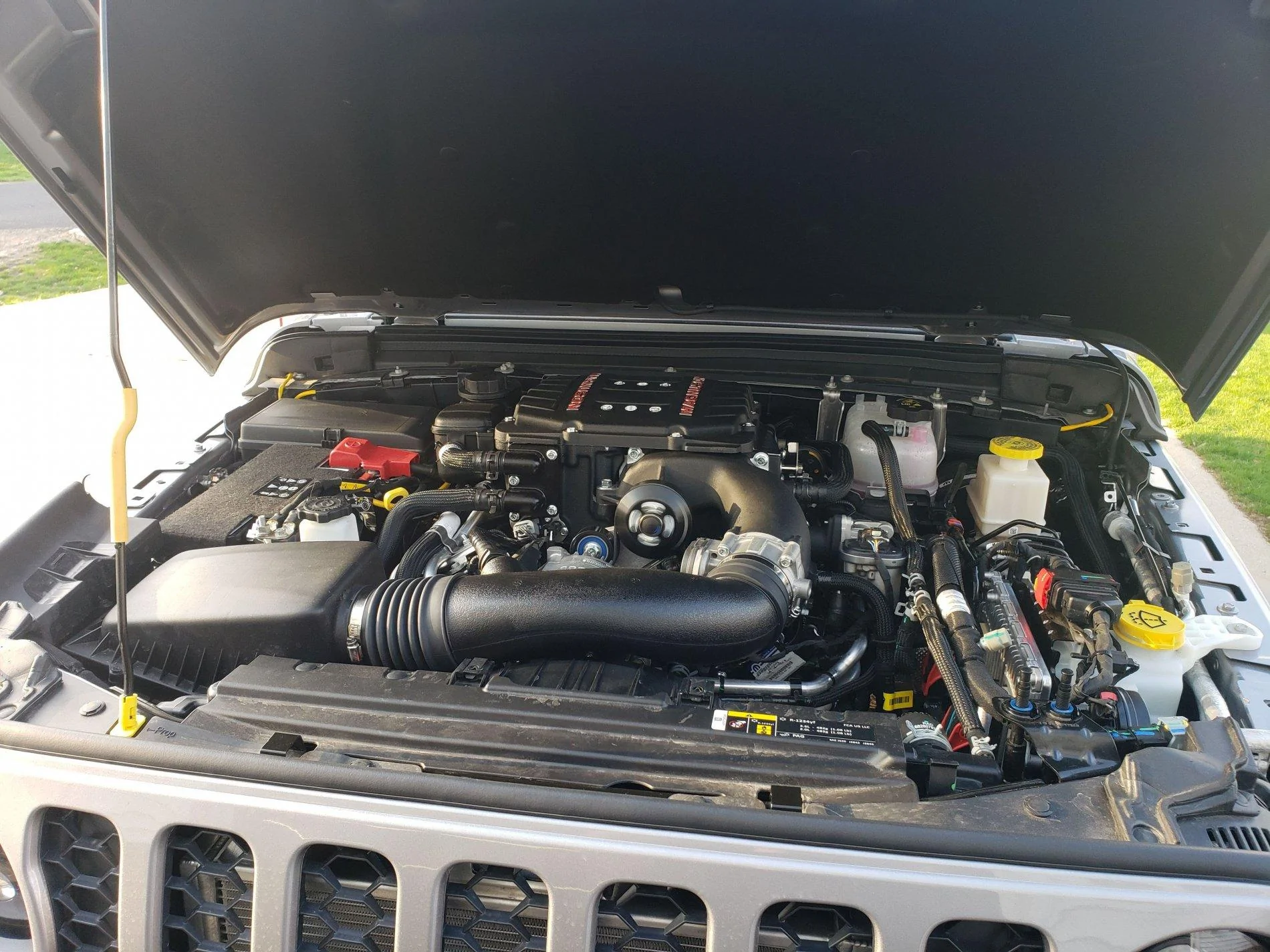

My application is a bit different and a tad bit juvenile, but it is my jeep so I figure it is alright lol. I have added a bit of additional power to my ride, and it is not cool only leaving one strip so to speak lol. On a serious note in inclement weather I would appreciate a lsd.
