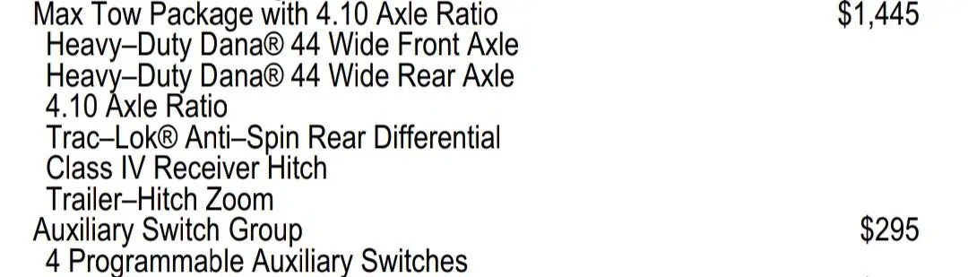

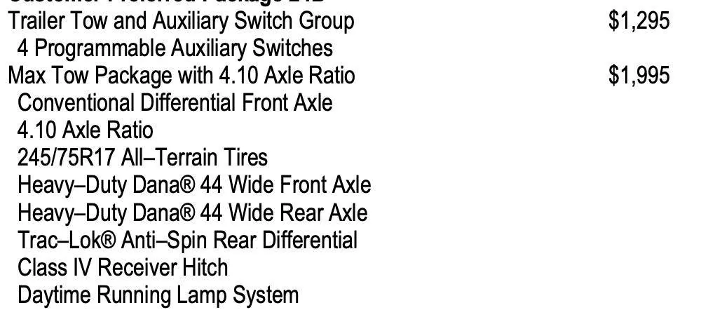

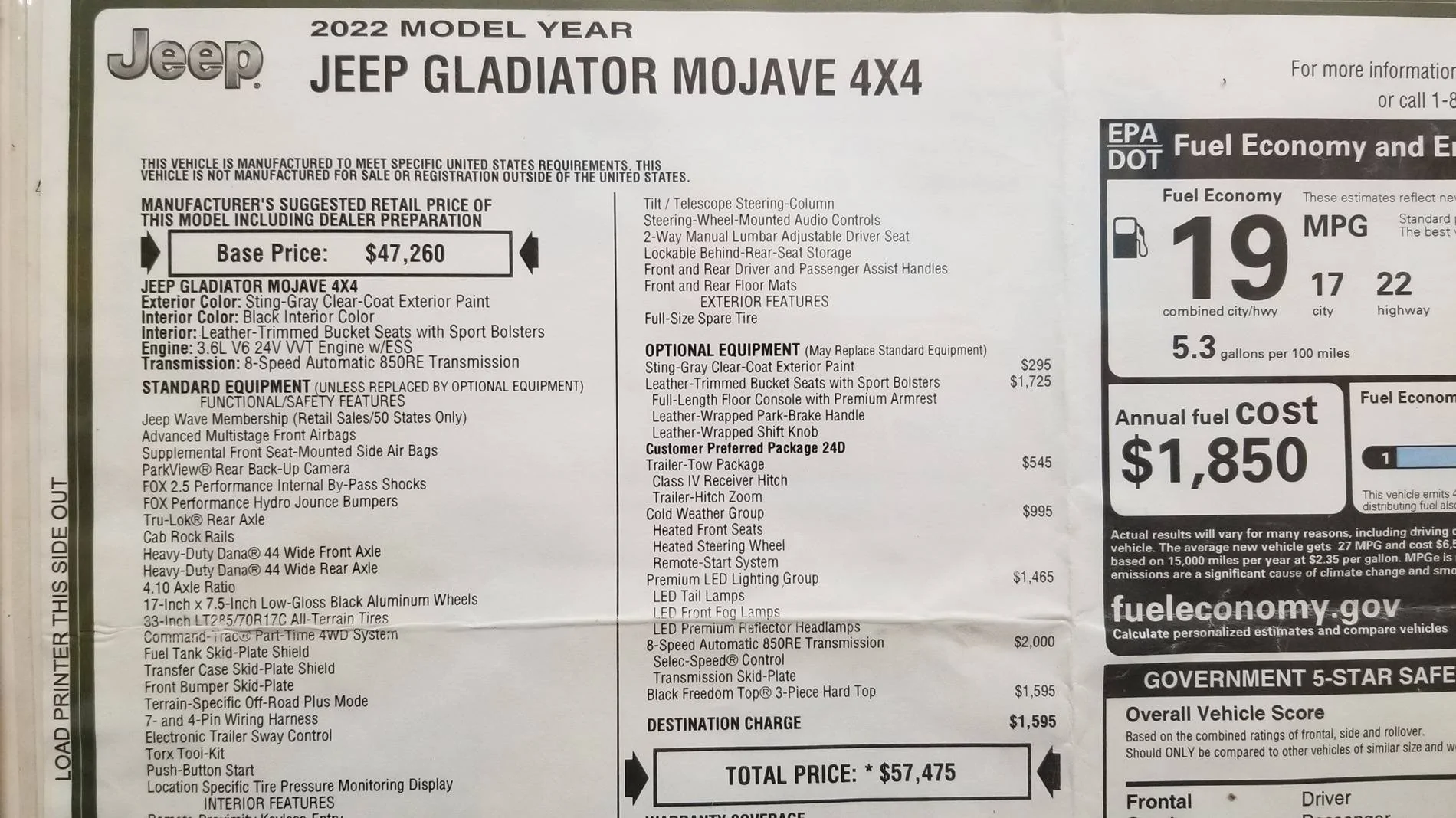

Mine too. Mojave has the cooling package, wide axles, 4.10 gears. Not sure why it wouldn't, but it's clear as mud.
Missing the max tow springs, for one. Your suspension is too soft for the maximum towing with the Max Tow package.
250
40,599
54,279
I've also heard there can be some difference in the brakes but that might be BS.
Brakes are the same.......
You're missing the heavy duty wide axles.
Wider but so far, the HD part is the same on standard vs. max tow.
They are all listed as HD axles.
Definitely different rear springs. If you install a lift kit with replacement rear springs in a Max-Tow you likely won't get as much lift as listed. In my experience.
I had max tow rear springs under my 2020 JT Overland. The springs were a lot shorter than the overland springs, but the truck sat at nearly the same height (dropped by maybe 1/8"?)
I wasn't expecting a lift out of them, just better handling of 500 pounds of trailer tongue. Meh, went to air bags on my 2022 as the max tow rear springs were disappointing on the Overland.
There's so many threads on "what is in a max tow package" - it's a lot of things, the sum is greater than the individual parts. Tire size was also taken into account - people don't realize that.
I think the NightHawk package with the wide axles is to accommodate the 20" wheel and tire combo offset and nothing more.
What's the tire diameter? The wheels wouldn't matter (unless they were different backset or offset, etc.), but the final tire diameter may.
