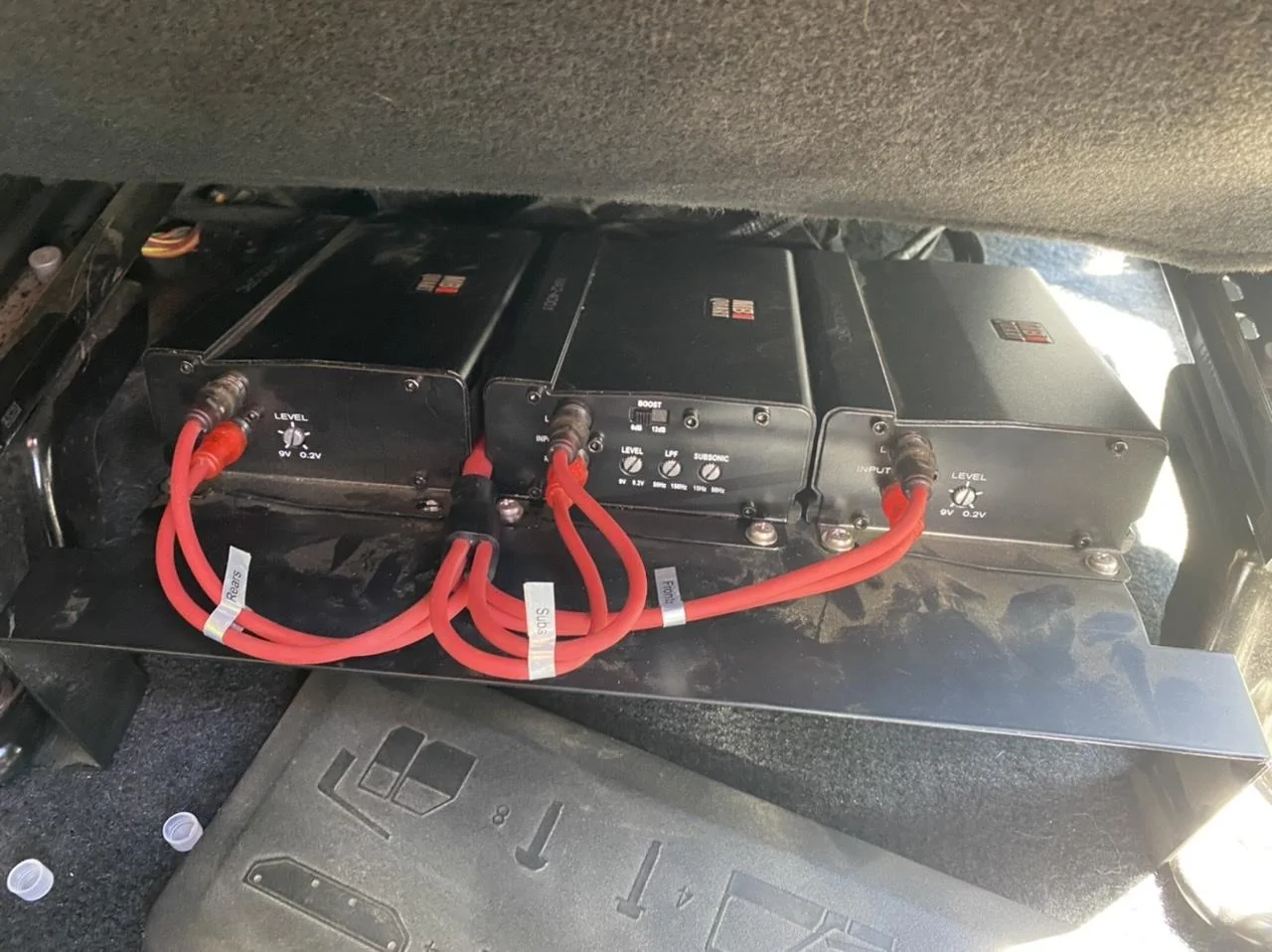

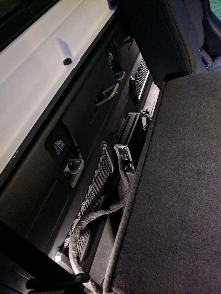

Eagerly started by getting the rear cleaned out along with behind the seat. I got the rest of their kit, and it has solid power wires with a 70amp maxi fuse to the amps already per the main kit so it should be a easy drop in. I also got some poly fill to stuff the enclosure. Will see in a few days!

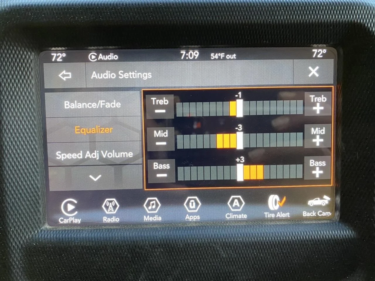

follow up with my 6x9 experience. I mounted the MB quarts and lost practically all bass that i normally hear. I kind of expected that when i removed the bass 'port' cutting out the template. That being said, mids and highs are phenomenal and i can hear everything with all doors off doing 60mph+ now.
I play mine around 28-30 on the volume knob factory 5" cheapie factory stereo.
bass: even (sometimes two down if an r&b song comes on or Knocked Loose)
Mids: plus one
Treble: Plus six
Balance/Fade: Center.
Ill put either two 8"s or a single 12 eventually to gain back those lows.
TL:DR Mb quarts 6x9 im happy with overall.

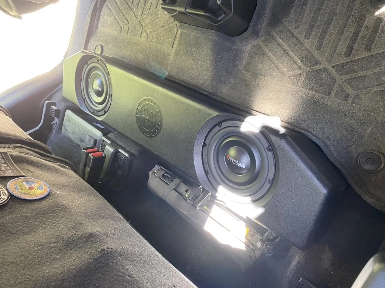

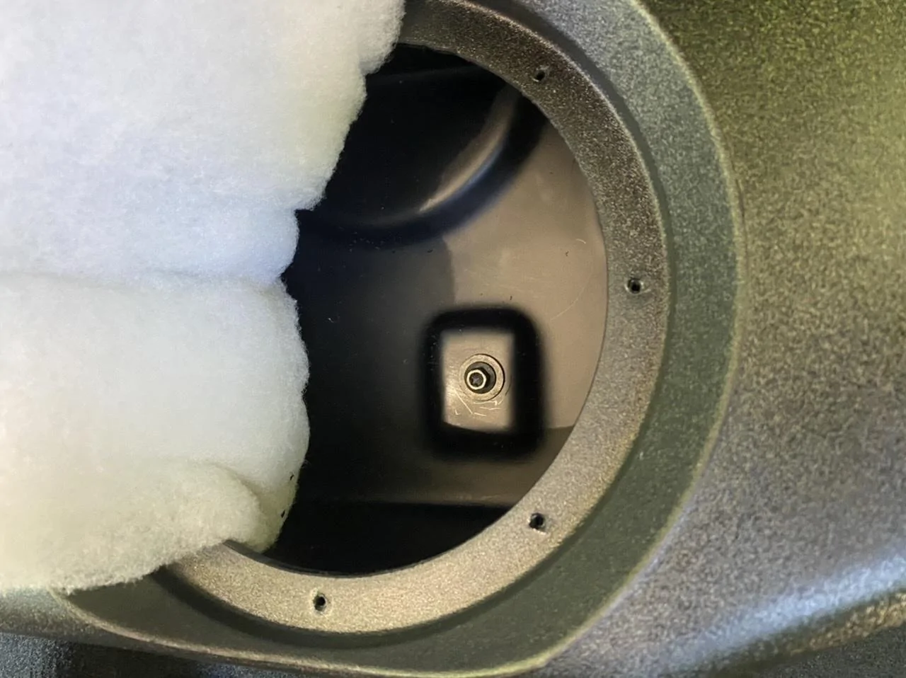

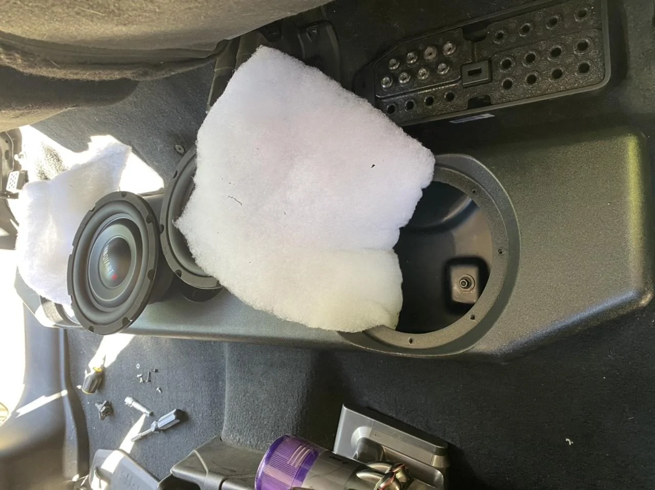

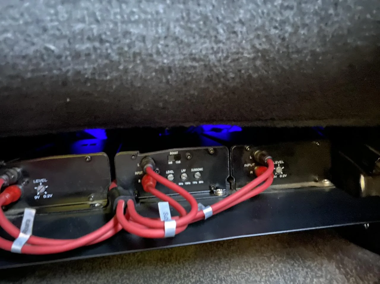

Subs are in and mounted.
Everything went in just as smoothly as the rest of the system.

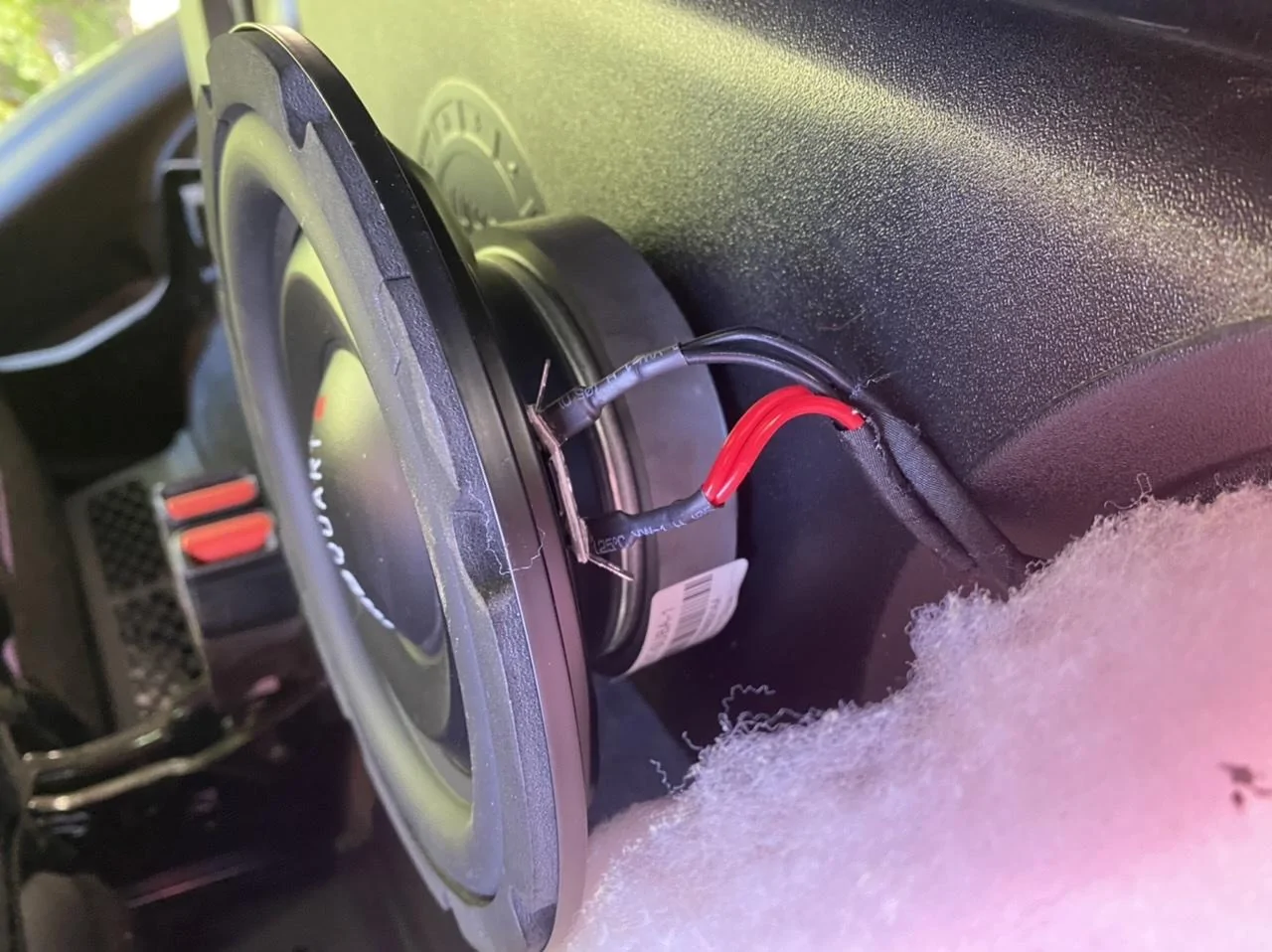

One point of note is the speaker wires running from the amp to the sub was included in the full system kit. The wiring included with the sub kit was a short little double ended number that you need to splice and add your own wire to. It’s assumed that if you order just the subwoofer kit, you will provide your own mounting and power solution. I used one of these amps in my buggy as its marine grade, and the connectors work so much nicer and safer than having to use exposed screw terminals.
Sound wise it’s got good bass. I think it pairs perfectly with the amplified front and rear stage of the kit to have powerful sound. The amps are all at half-gain and at max volume it’s definitely a portable boom box, and should you be okay with some mild hearing loss, offers a ton of oomph in the cab.
As it’s 1200w in total, It’s not gonna rattle the windows and the trim off. 20-something me would have appreciated that, but 30-something me appreciates not coming off as a teenager.
Still dialing in the tuning for my music preferences, but all in all, I think its a great kit. My friend has the factory alpine system, so I will be comparing them next time we meet on the trails.

After some quick fiddling, settled on the following settings. Bass knob at midpoint. Levels on the front and rear amp just shy of 2/3rds up, and sub at 3/4.
Will tweak more, but this gives good sound for a range of music with volume knob at 12-25. At 25+ it’s loud but not quite coming apart. Good for when ya need a portable jukebox outside the jeep. Definitely want to test it with the doors and top off.
All in all, super pleased with the setup. As it has all the pieces I wanted to do aftermarket with dash pods and soundbar upgrades, and all in with the sale, it was priced under the just the Alpine upgrade kit. So win win.

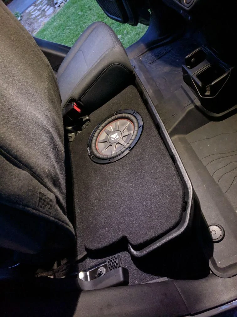

I'm pretty blown away with my setup and it's pretty darn clean and not too pricey. I upgraded the dash & sound bar speakers (just the 3.5s) for around $100 total and amplified all the speakers with an alpine KTP-445 ($150, filtered at 80hz and hidden under the passenger front seat). Running a kicker compRT 10 ($180) with a kicker 46CXA8001 ($220, 1600W/800W RMS) in a custom enclosure ($200). It absolutely pounds and is crystal clear and gets loud enough to leave your ears ringing. About $850 total (and I had about $600 of that covered with amazon credits : ]) and obviously a bit of my time installing, but so worth it. I even get to keep the driver's side underseat storage.
Really nice! Did you make the sub enclosure? I am wanting to do something similar.
I had someone else make it who is way more skilled with fiberglass. I also polyfilled a bit. Sounds awesome with good clean hits. Clear and powerful reproduction of double bass kicks, etc.

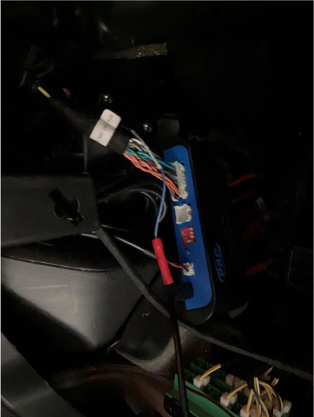

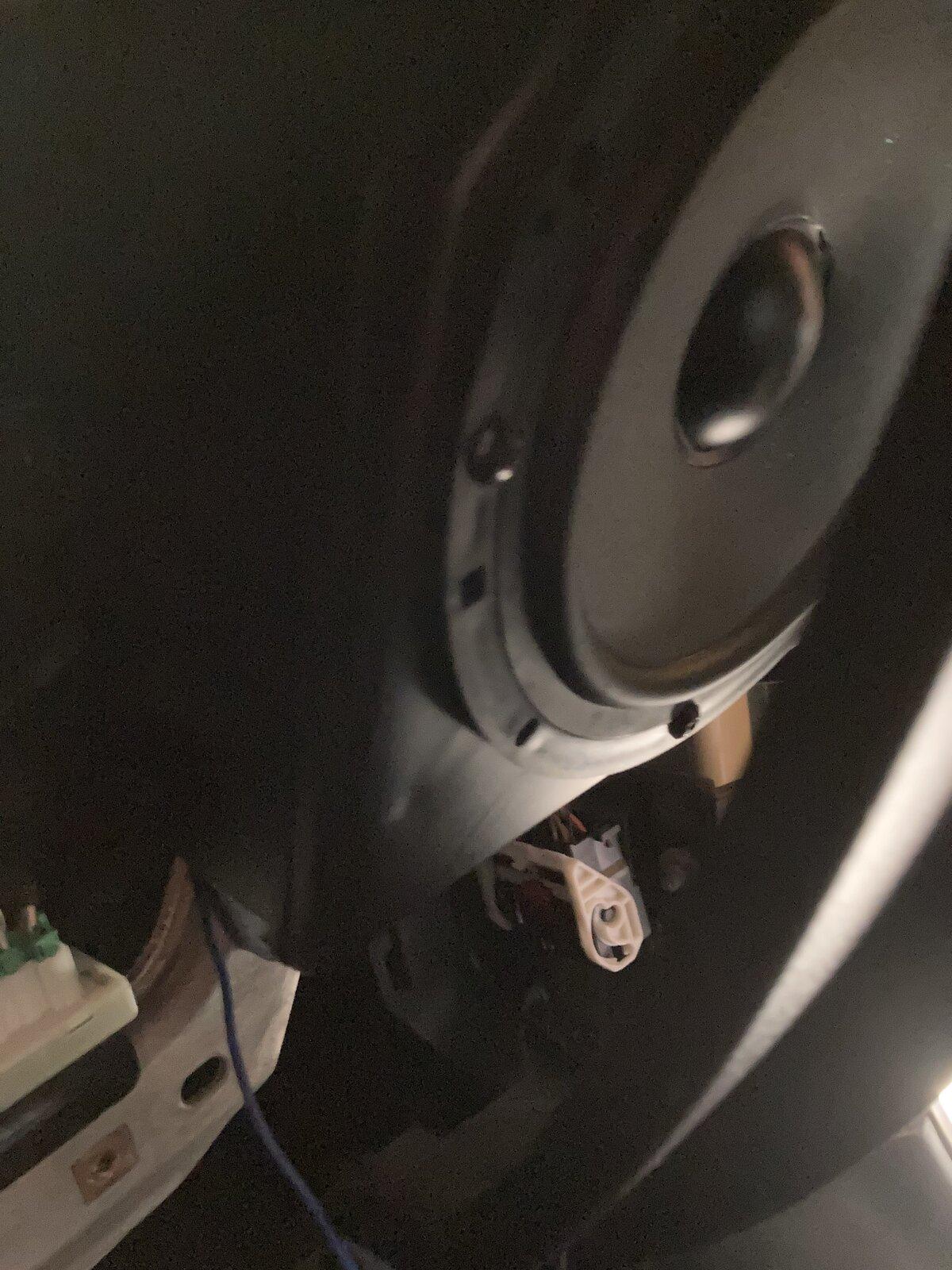

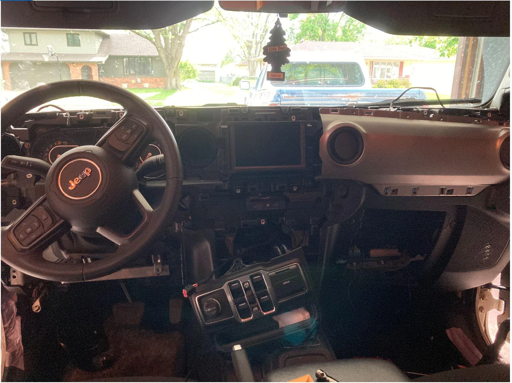

Today started to put install this MB Quart system into my Gladiator. I took it apart a few weeks ago but then had to stop working on it due to kid's high school graduation and the festivities afterwards.
When trying to put this back together one of the connectors of the control module was hiding and behind the metal bracing under the steering column.
Thank you very much to Rubi Rhod who answered some of my questions due to the vagueness of the mbquart instructions. (instructions state I could only find 1 remote wire and 1 from the pac. no idea what the extra one is that they stated below).
Jeep Gladiator MB Quart announced 'Purposely Engineered Jeep Tuned Audio Kits' at Jeep Beach 2021 1621727516410
I wasn't sure if the PAC also needed a remote turn lead attached to a power source or if the blue wire coming from the pac supplied the power for remote turn on. (Rubi Rhod clearified that the pac supplies the remote turn on power).
So far no real issue if I did this again I would make sure to remove the doors first I think that would make getting to some of the screws that hold the lower speaker pods a lot easier to get to.
Awesome!! Doors off did make it a good bit easier and made for a hella fun test drive after :)
