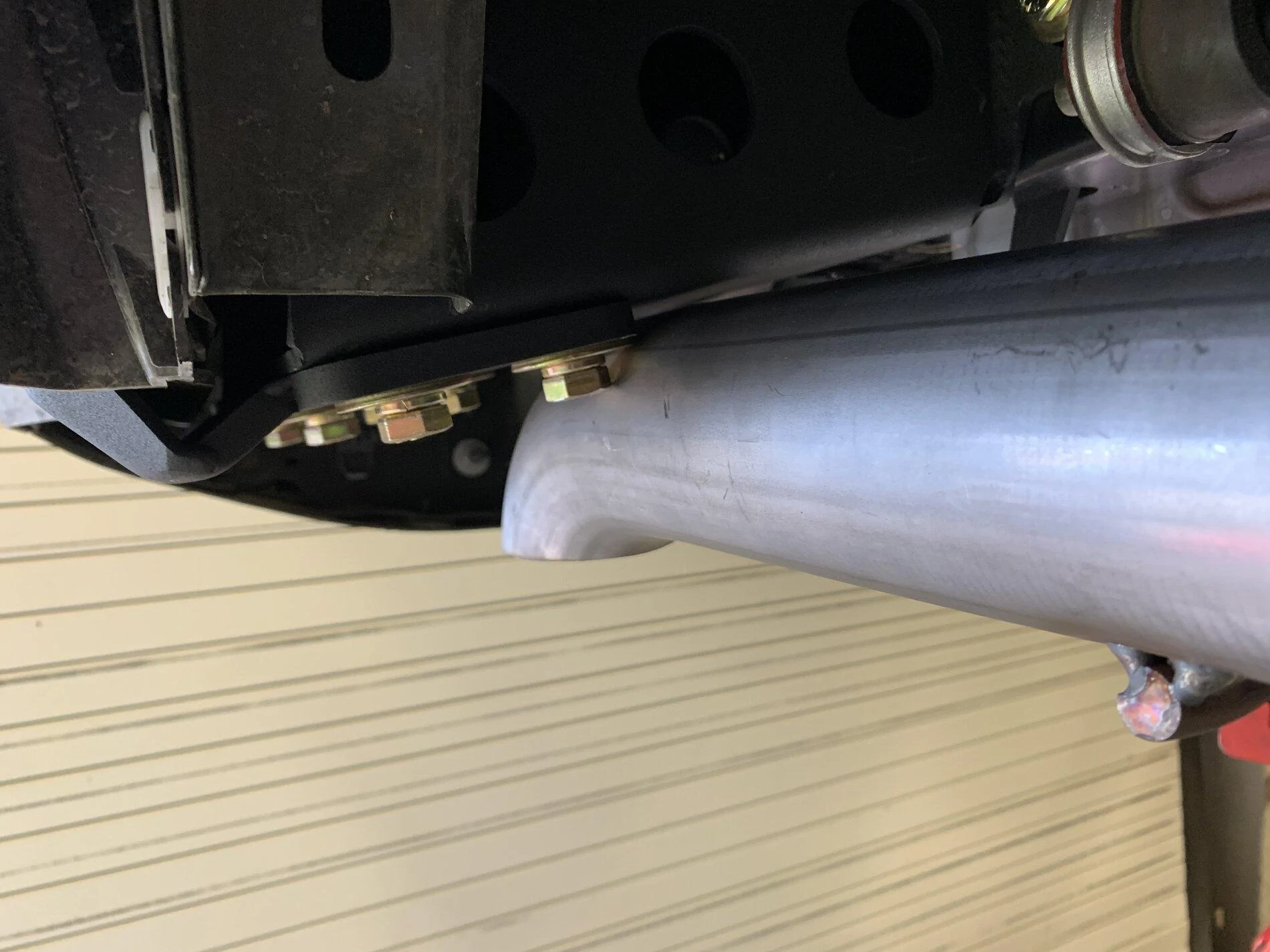

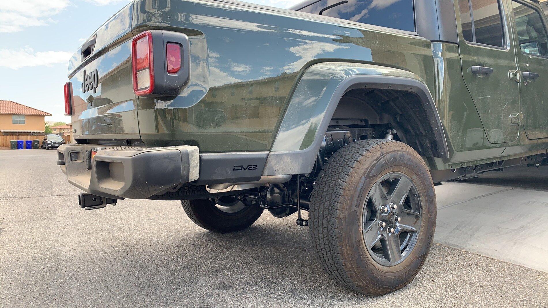

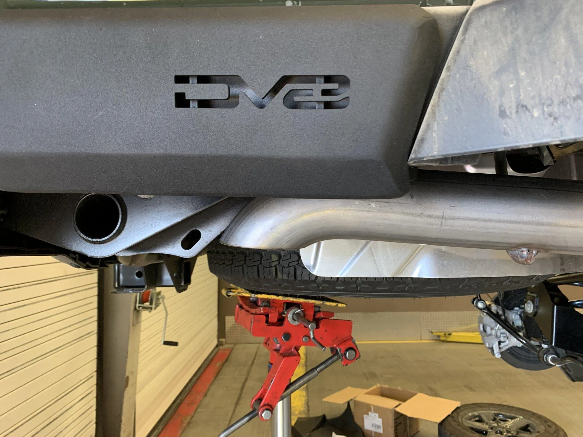

The fit was great, easy install. Made a lot more room for the bed sliders but still makes contact with one of the mounting bolts on my DV8 bed side sliders. Left it alone for now, shouldn’t cause any issues.
No change in sound noticeable at all.

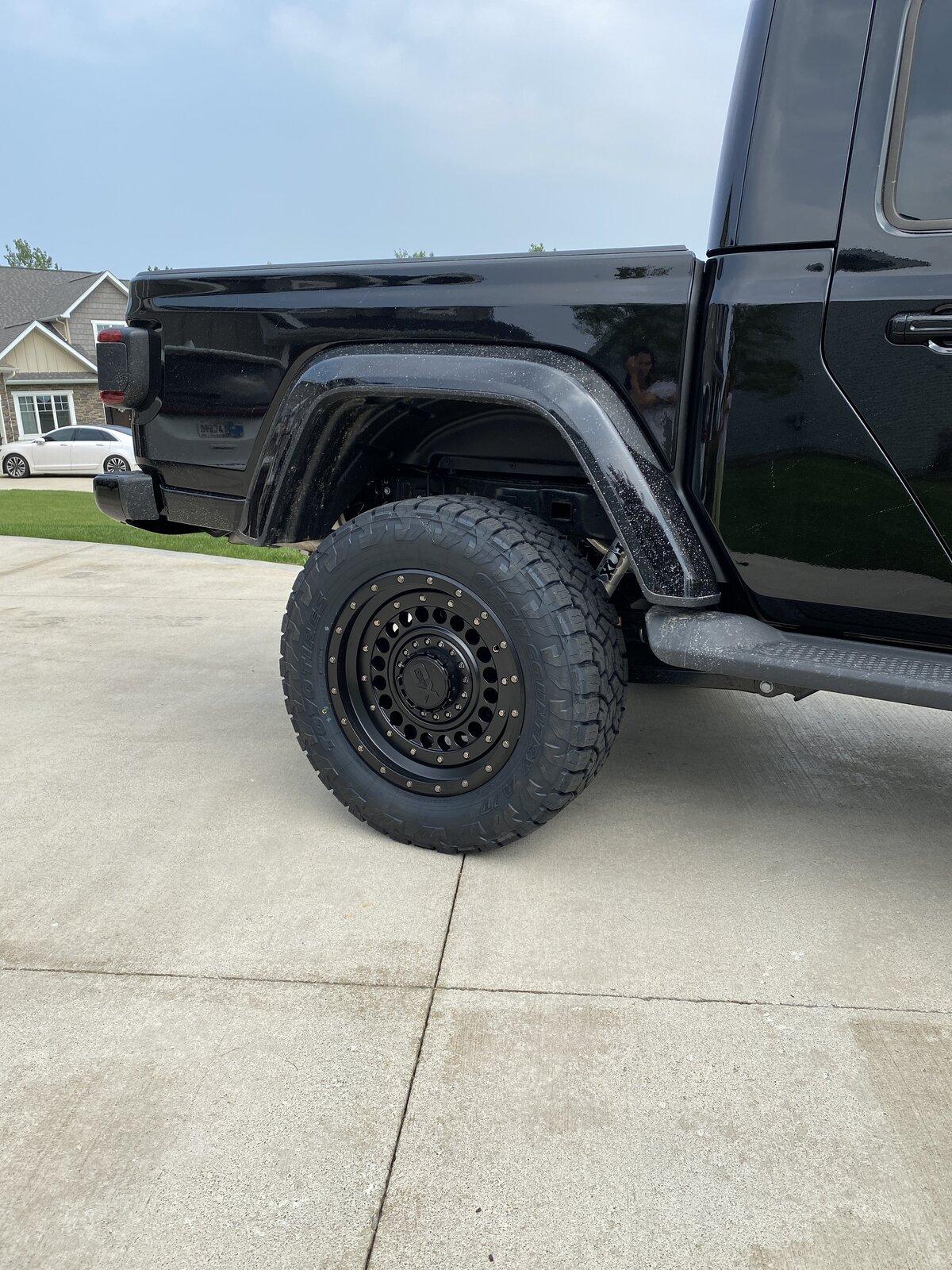

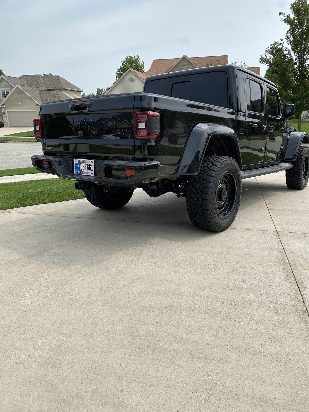

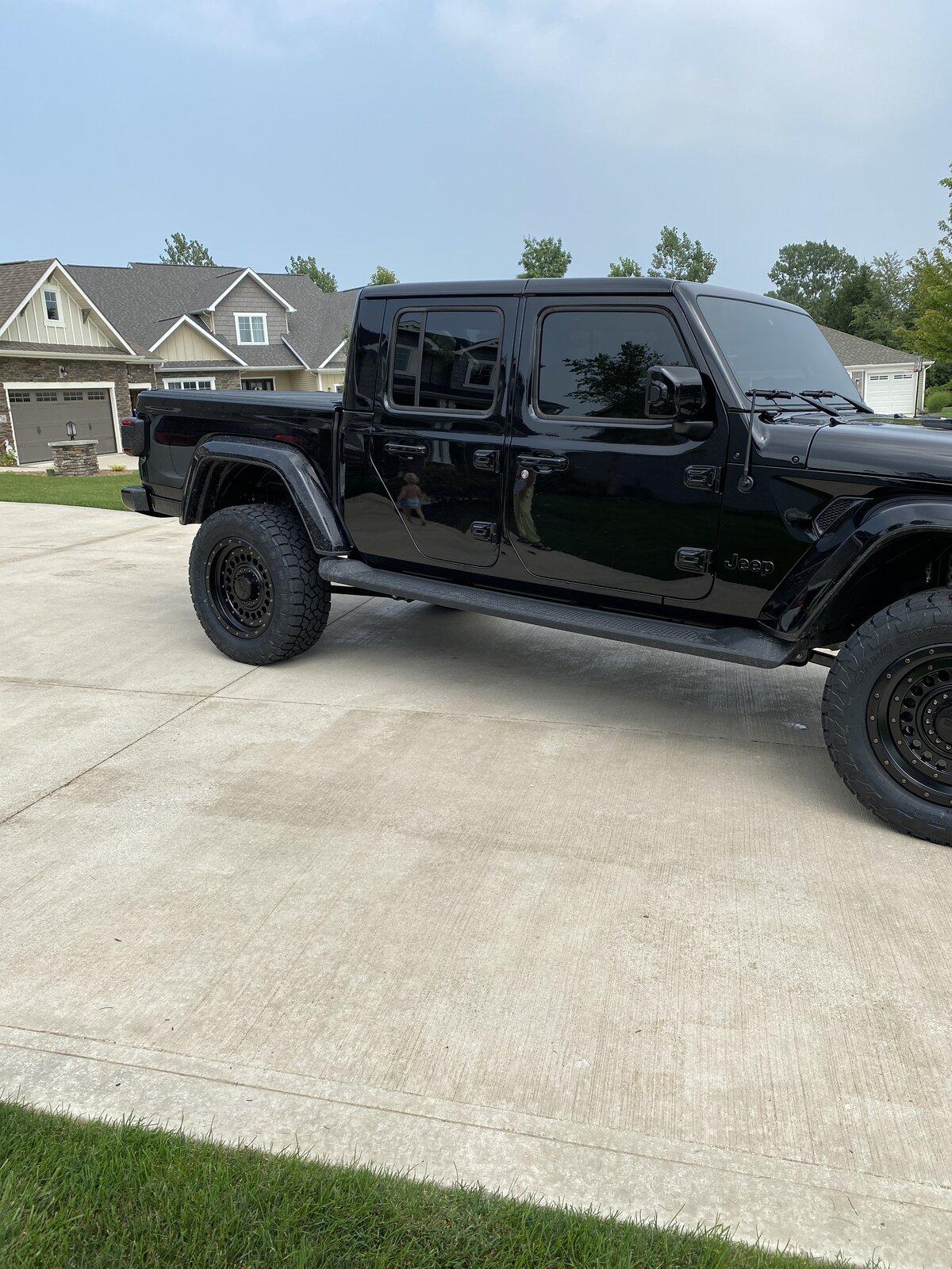

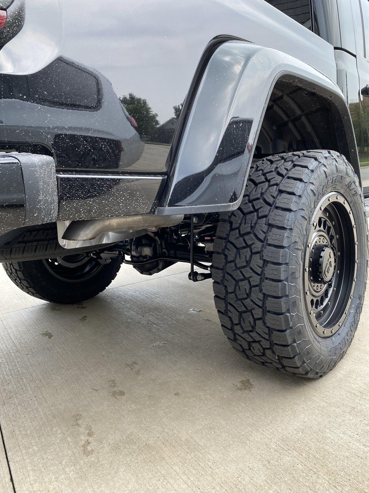

Sound difference is nil. It does tuck up a little higher for a cleaner look. Haven’t had mine installed long enough to give anyone a mileage difference. If you unbolt the track bar you can remove the old exhaust without cutting it. I just wish I painted it black before putting it on.
Jeep Gladiator MBRP Filter Back Exhaust and AFE Charge Pipes image
