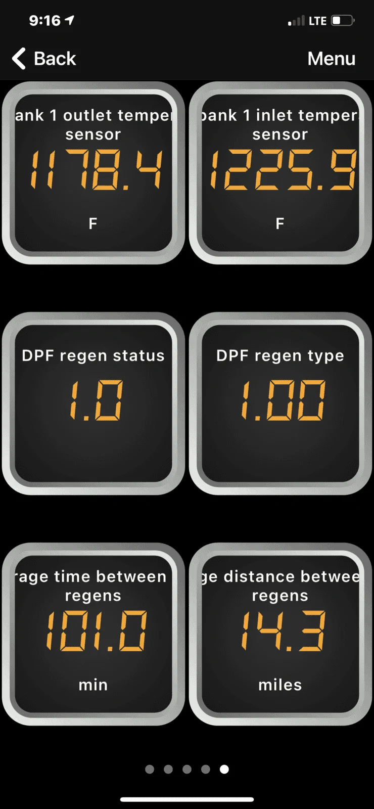

Thanks! Let me know whatever you're able to provide via screenshots/export files/etc. I'm a fairly technical person so should be able to decipher them
I'd be interested in that file, if you can post a link to it.
Hey @FutureOdin and @Shoebox, I just wanted to direct you over to the thread where I got the OBD Fusion info instead of hijacking this thread for info about gauges.
See here: https://www.jeepgladiatorforum.com/forum/threads/all-diesel-specific-talk-topics.36149/post-642081

For any Googlers out there, I've hit my first regen with a notification at 3660 miles.
And of course it's while I'm going to work at 4am.
Guess I'll be driving around after work because I doubt my 15 minute commute was enough to clear it.

Most of the time during a regen you won't get a notification. I think the notification only pops up when you've gone a few times of not letting the regen finish before turning off the engine. So there's a chance you've had a few already.
I had my first somewhere along my drive back from the dealership picking it up (1150 miles) but didn't get a notification. Only found out it had one once I got home and plugged in my Scanguage II.

I’m at 15,500 miles on my 2021 ecodiesel and I’ve never had a regen message come up- is this normal? The majority of my driving is highway
KW80
Feb 24, 2021
175
215
Illinois
2020 Pacifica Hybrid Ltd, 2021 JT Sport S Diesel
If you are driving regular on the highway it is absolutely normal to only have passive regens (no notifications because it is occurring in the normal running cycle) and not have any active regens. I commute on the highway as well and have only experienced 1 active regen before I was back to regular highway driving.
