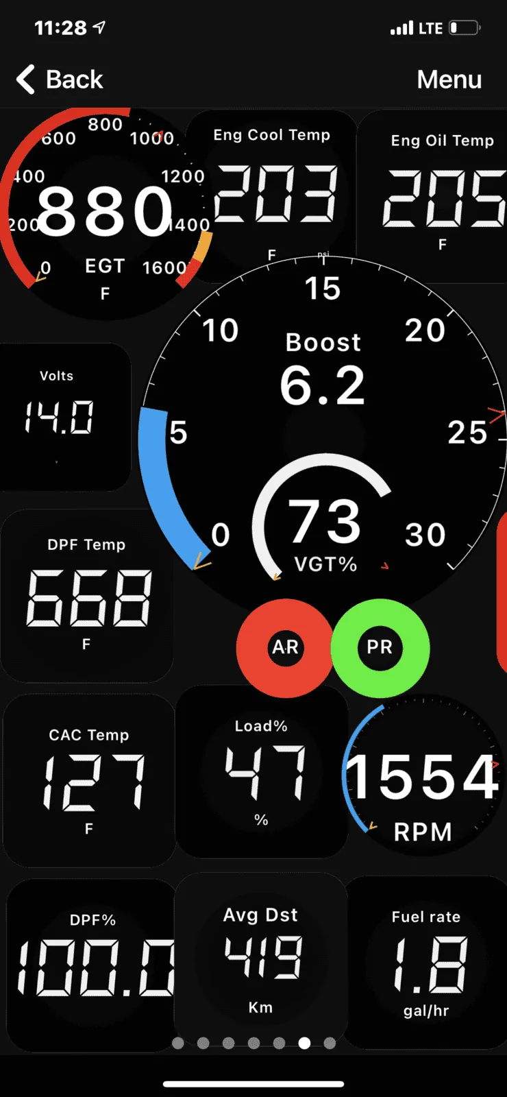

Well actually now that I look at my gauge setup, I used a stock PID for DPF regen status and another PID for DPF regen type. Regen status will be 1 whether Active or Passive but regen type is 0 for Passive and 1 for Active.
Another display configuration that I got from a forum member here that found one on the Ram forums setup a really cool colored circle for both regen types, PR fills with green during Passive and then AR fills with red during Active instead of just looking at 1's and 0's.
Here's a shot of that display during an Active regen:

Ooo that is neat. Is there any way you can share the PIDs/equations used for your gauge set up (DPF Regen Status + DPF Regen Type)?
If you have the same info for the AR/PR green/red gauges, that'd be helpful, too! Thanks

So this entire dashboard of gauges came from the RAM forums (same engine) and they exported the entire dashboard with all their user-defined PID's for the OBD Fusion app, I simply imported the file so I don't have a full understanding of everything that went into creating this dashboard although I am incredibly appreciative that they shared it because this dashboard looks like hours upon hours of work.
Without having OBD Fusion I'm not sure everything would apply to a different app other than the PID's. Let me see what I can dig out.

Thanks! Let me know whatever you're able to provide via screenshots/export files/etc. I'm a fairly technical person so should be able to decipher them
