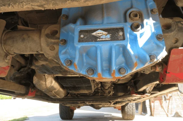

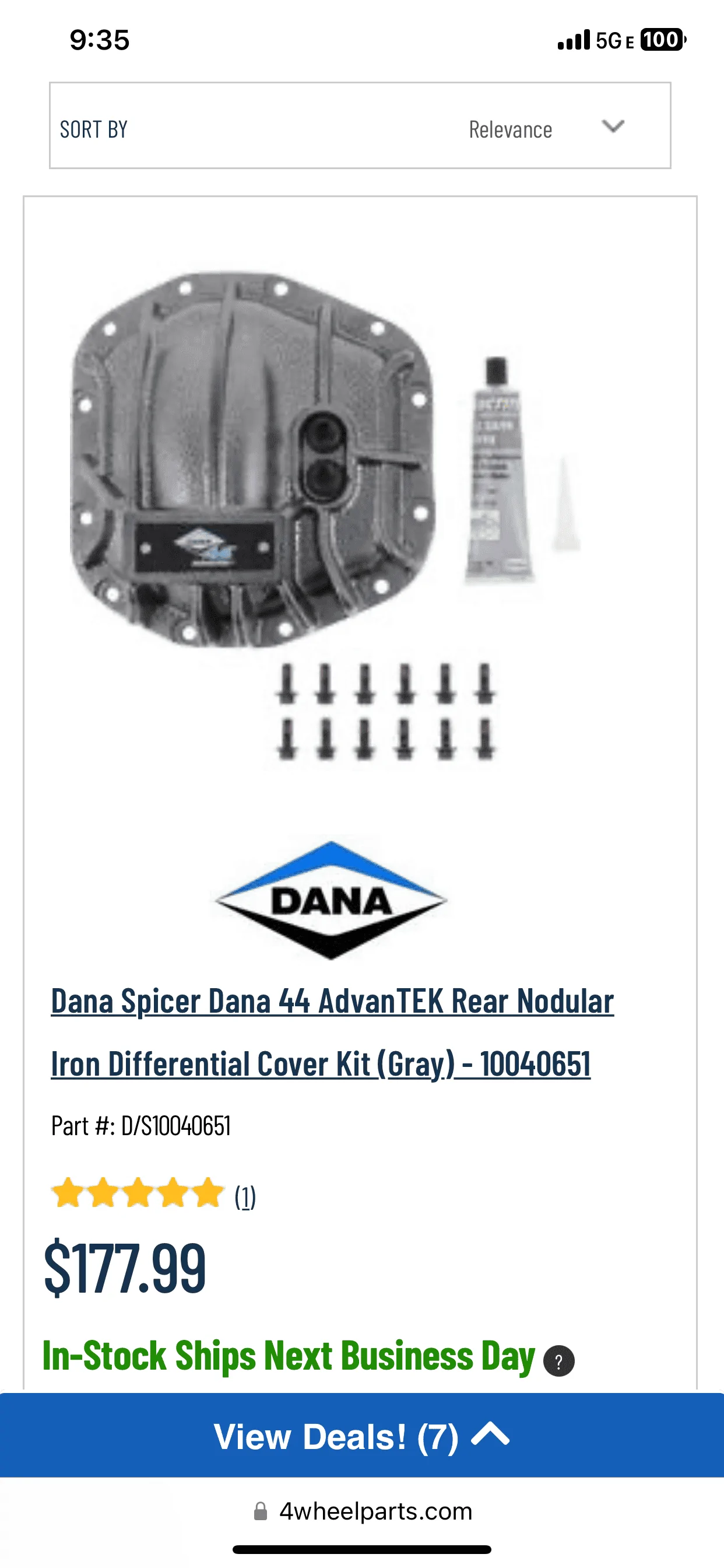

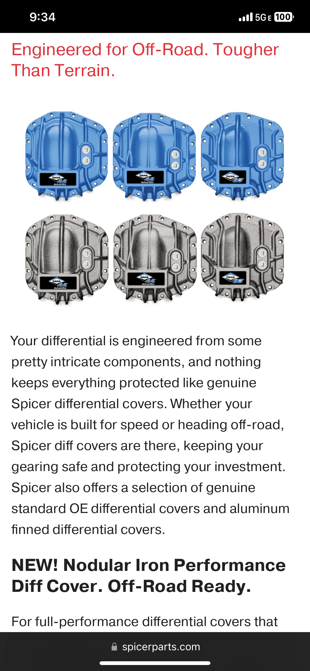

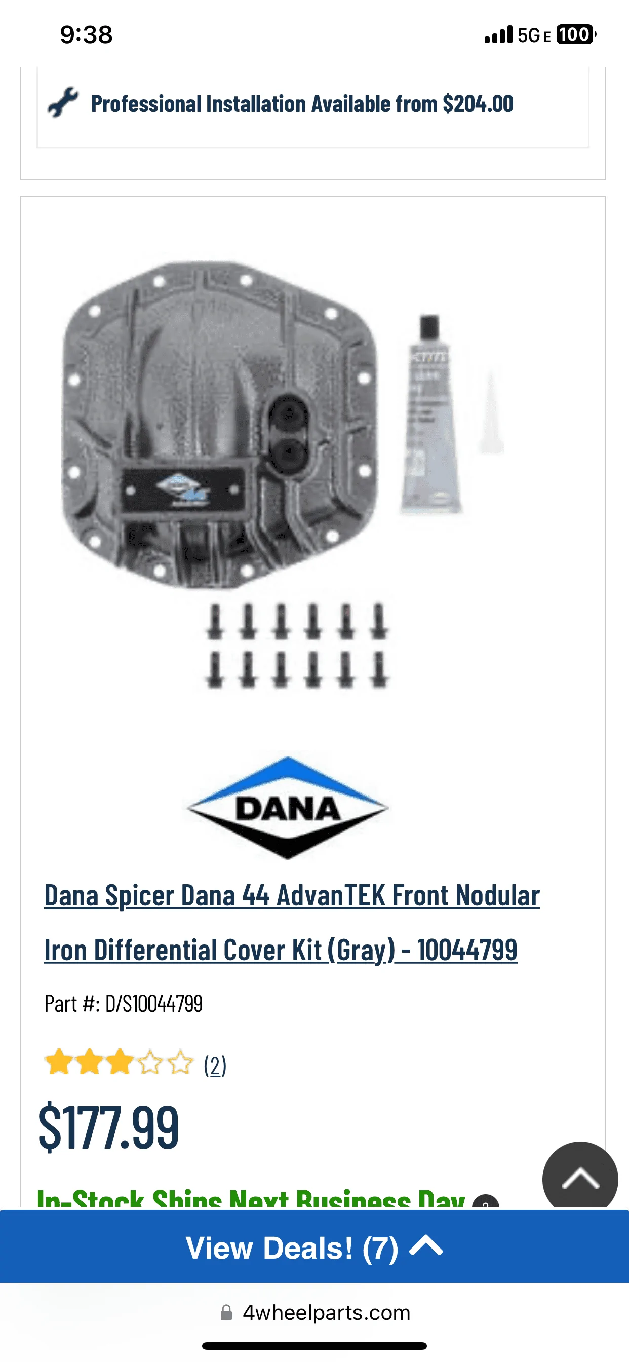

Wonder if the Dana iron covers have an issue? It’s their axle and steering gear after all…
The cast webbing appears to be a little different on the front.
6,424
14,655
I have the Dana covers with the stock linkage. Plenty of clearance. The only thing the Dana covers hit are rocks.
Jeep Gladiator Metalcloak Front Track Bar and Yukon Diff Cover 1676774257992

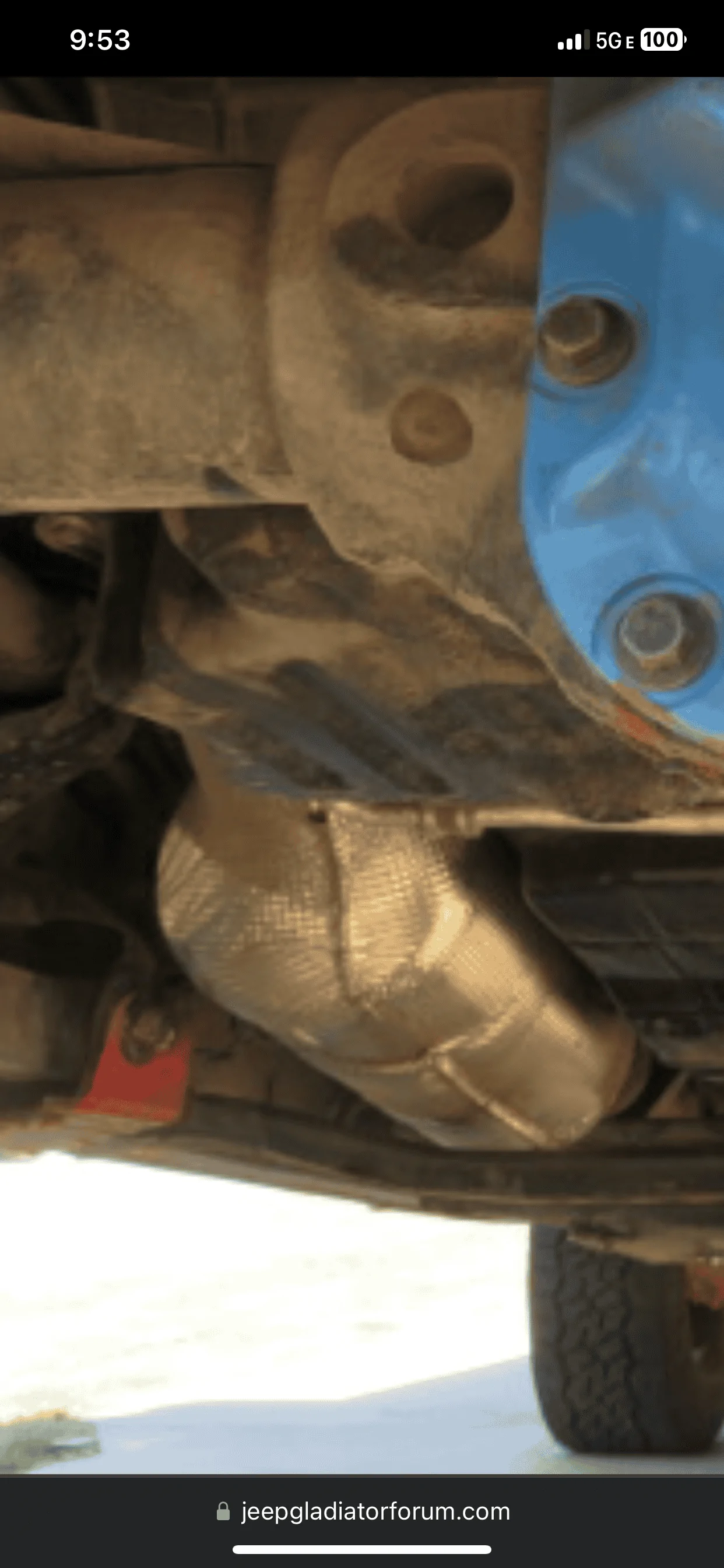

Is that just the image…or is the oil pan mooshed?

Now I have to go and take a look at it tomorrow. Damn you.
I hate how low that sucker sits! Also, do you think your cover would get away with upgrading the tie rod diameter with one of the aftermarket heavier duty units?

Ok........I took a look at the oil pan and tranny pan. Everything is fine. No dents in either one.
The Dana diff cover. Have about 2.25" of clearance between the stock tie rod and cover.
Now......if you follow the rib up from the 2 fill holes The stock track bar has been hitting on the top radius of the rib. Looks like if I grind down that section of the rib. i should have enough clearance. I'll do that when I install my lift with a Core 4x4 track bar.
Jeep Gladiator Metalcloak Front Track Bar and Yukon Diff Cover 1676828177475
