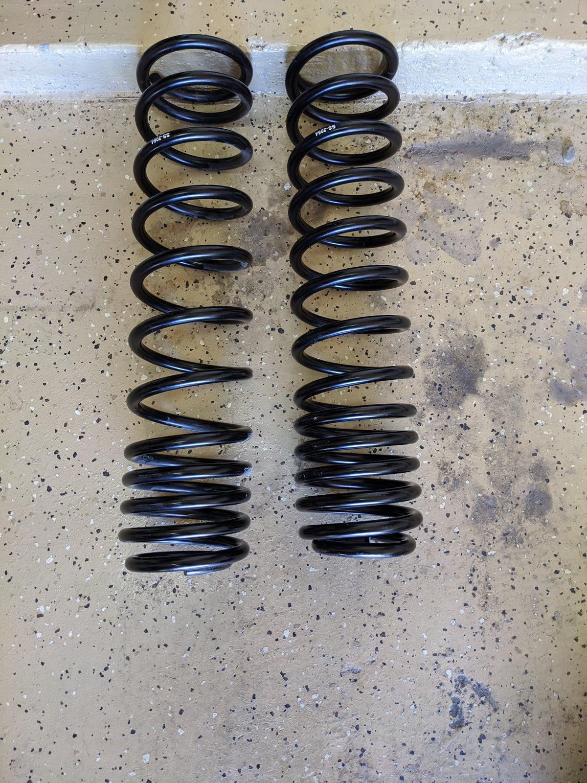

I just installed my 3.5 game changer. After everything was done, I noticed one side was 1 inch lower in the front. Took the springs off and compared... They don't seem the same. Anyone else have this issue?
Left side has 12 coils and right has 14
Something isn’t right there... did you call Metalcloak? Maybe shorter one supposed to go on the left side so you don’t get the right side lean??? Or did they send you the wrong coil??? Too many questions.
Just heard from Metalcloak. They are sending new springs. They don't know how or why they are like that.
I love their customer service
