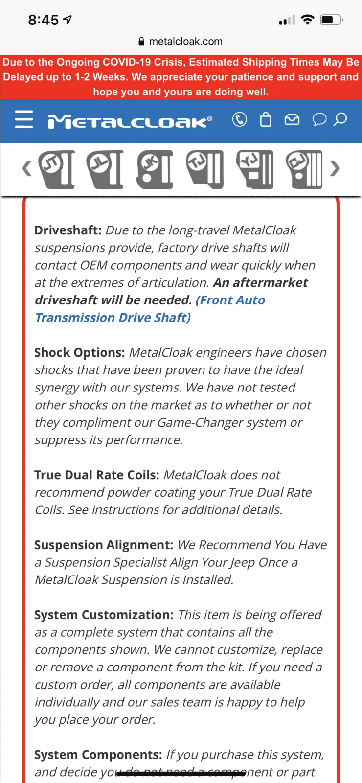

I have the 3.5 dual rate kit coming with the Rocksport shocks, just curious, how many of you have replaced your front drive shafts? Not planning on maxing out the flex anytime soon, and wondering if I can get away with the stock front driveshaft for a while.
I did replace mine with the full 3.5” GC lift
With my last JKU, I got away with about 3 months without changing the driveshaft. My installer told me this, “ at some point the driveshaft is gonna go... it could be in 5mins or 2 years... depends when it decided it’s done”
Just an FYI... in MC’s notes... it does tell you to replace your front driveshaft.

Saw that in the notes, hence the question. I know it will have to be done if I plan on using the suspension to it's full capability, but was unsure given the number of different "3.5 inch" lifts that dont call for a new driveshaft.

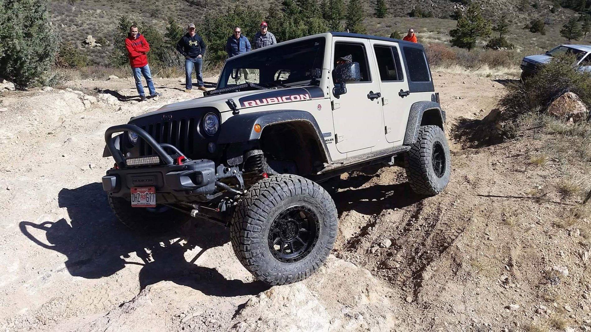

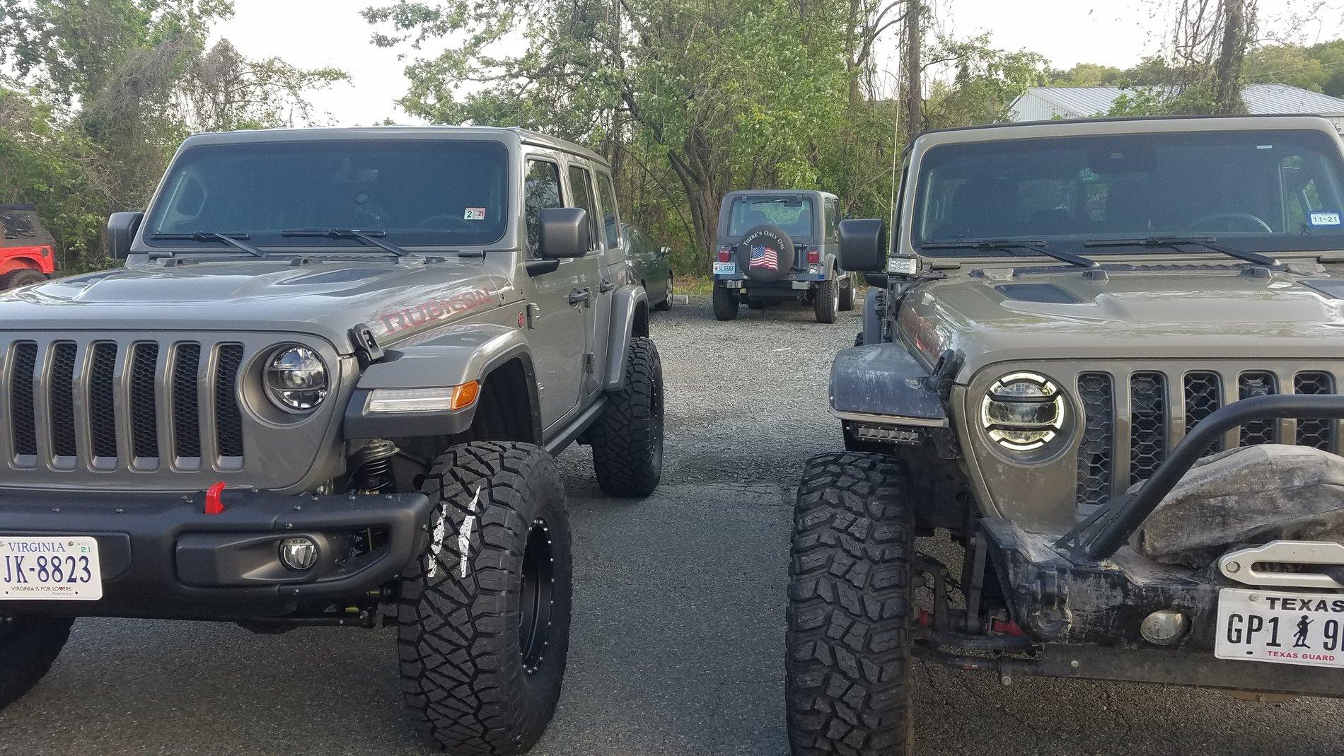

So I managed to run across a JL that just got got a 3.5" game changer installed. Now granted mine has settled and I have a steel bumber an winch, but it really looks lower. (Both on 37"s)
I've also noticed it doesnt look much bigger than a 2" mopar lifted JT either.
I'm starting to wonder if I got 2.5" springs or if metalcloak lifts run small on the JT.
Can some of yall measure the loaded spring height m on your metalcloak or other lifted Jeep?
Basically from the top to the bottom of the springs on a flat surface.
Im at 13.8" both front and read

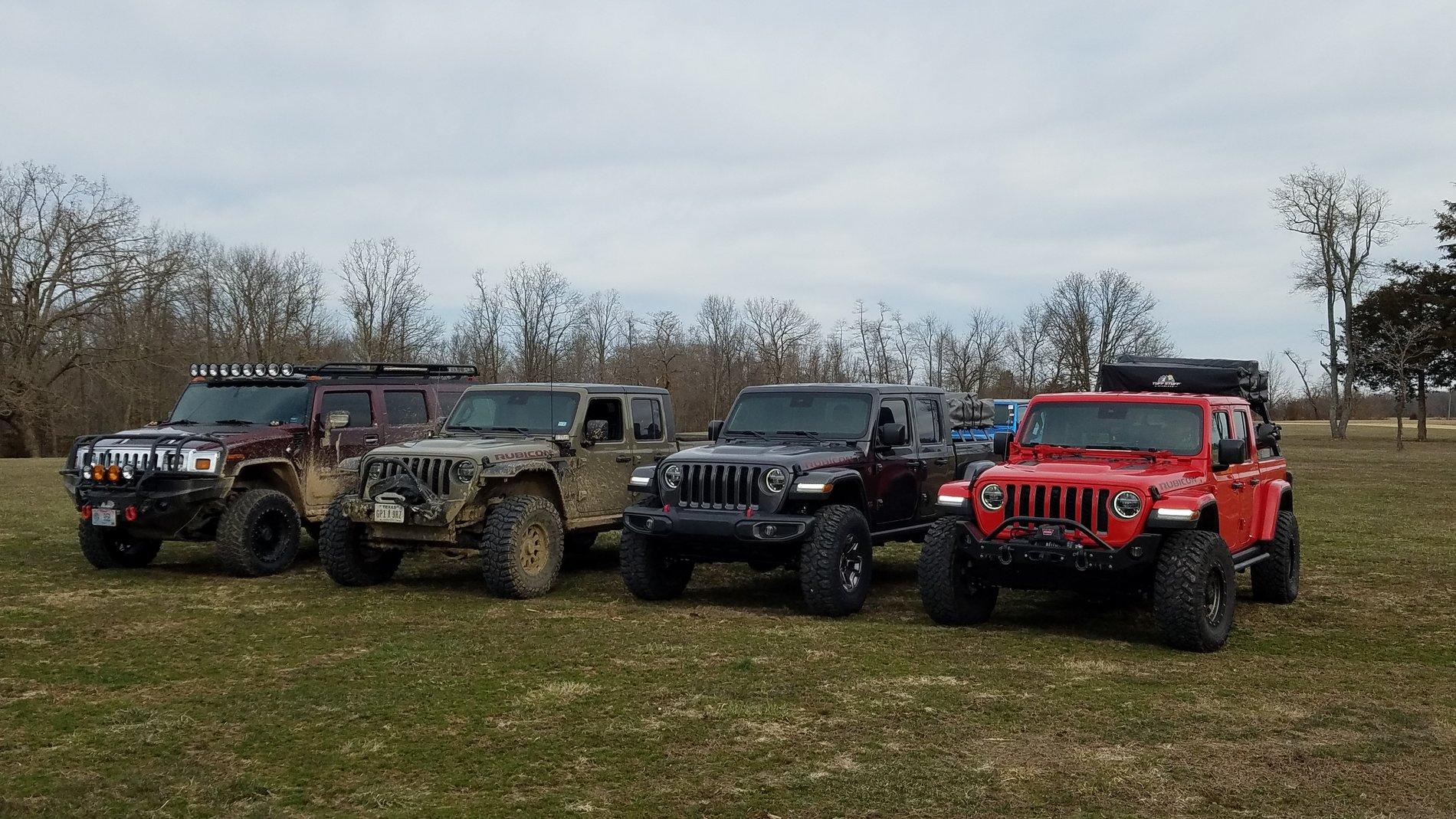

I've been thinking the MC lift looks short for a 3.5 lift.
Whats the specs on the other two JTs in the bottom pic? The black one looks taller.

i have seen few people with MC springs on a JT and it does look lower than most manufacturers that's why i went with EVO 2.5" and MC arms.
