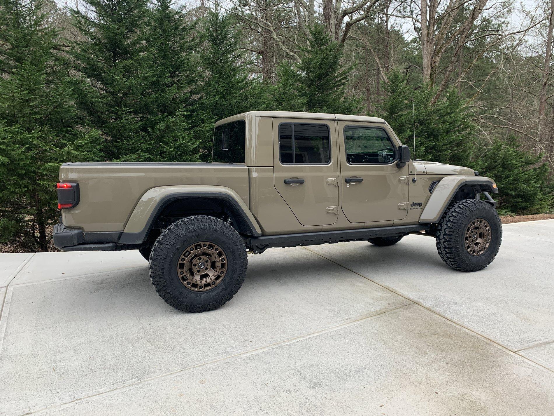

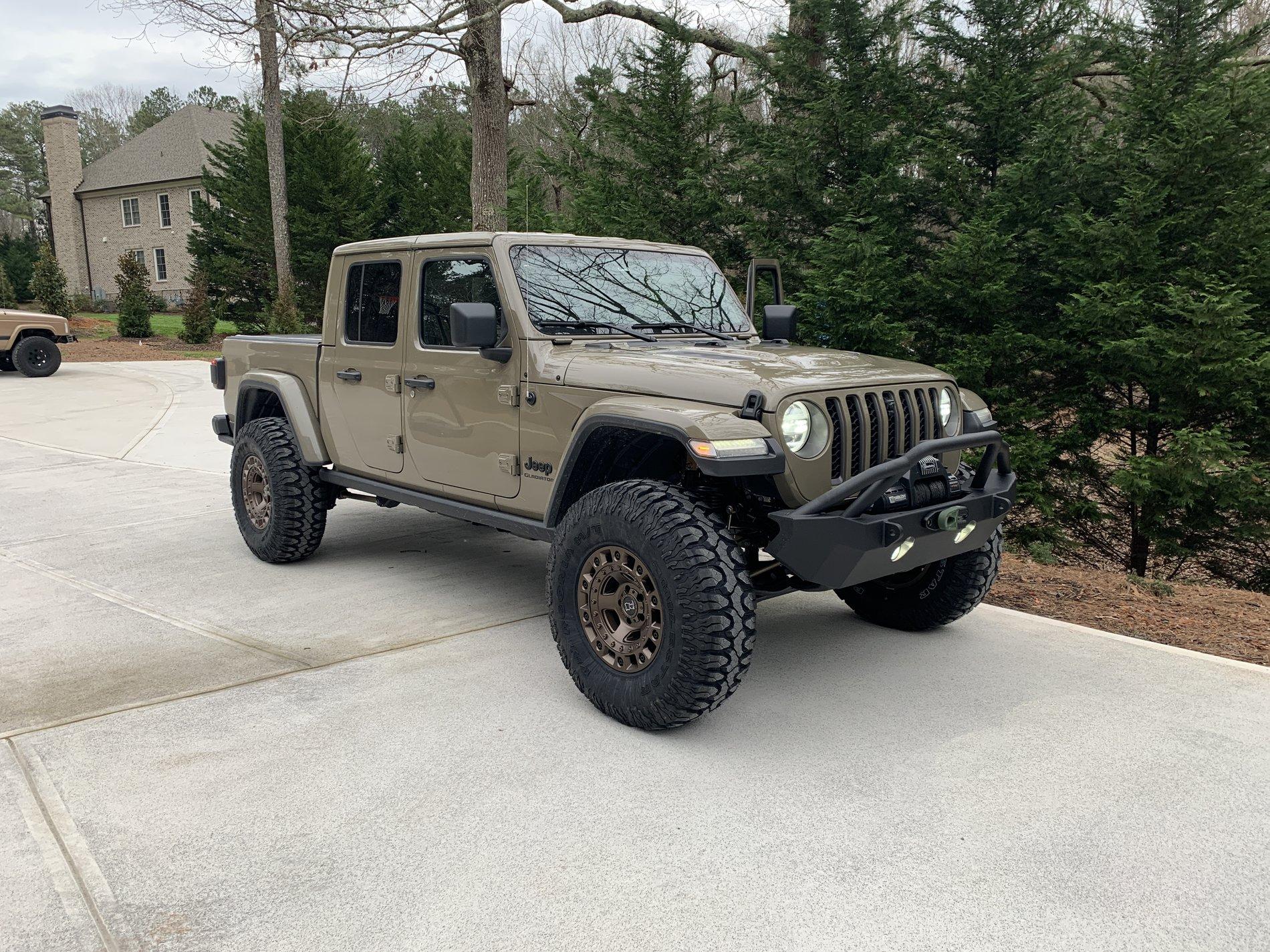

Awaiting 37's Patagonia MT on Black Rhino Cinco in bronze to get here Wednesday. Then an alignment.
Thoughts: Install took 2x longer than expected. Instructions decent, but need updating. Had to download the 3.5" lift install instructions, then the bump stop instructions, then the trackbar instructions.
Worst part is grinding the axle bracket for the trackbar as the MC joint is oversized. Went through 5-6 bits/stones on an angle grinder. Dremel too wimpy, pneumatic 3" cutoff wheel does not fit. 4.5" cutoff wheel too big but used it anyways. Next worst part is the factory front brakelines. Lots of extra bracing in the bracket. Makes me want to ditch them for Goodrich and just ziptie on the ABS lines.
Ride is a little stiffer than stock, steering is close to perfect even before alignment. Still awaiting the Rocksport rear shocks when they become available. Using stock Rubicon ones for now.
Overall- pleased. Will like it even more with bigger tires and once broken in and aligned.

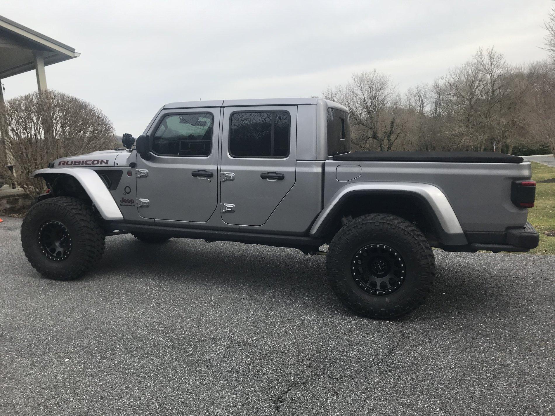

The spring are definitely stiff right away with any lift. I have found that the MC springs take a few times offroad to get them to soften up... then they are super awesome.
your ride looks awesome, post up when you get your rims/tires.

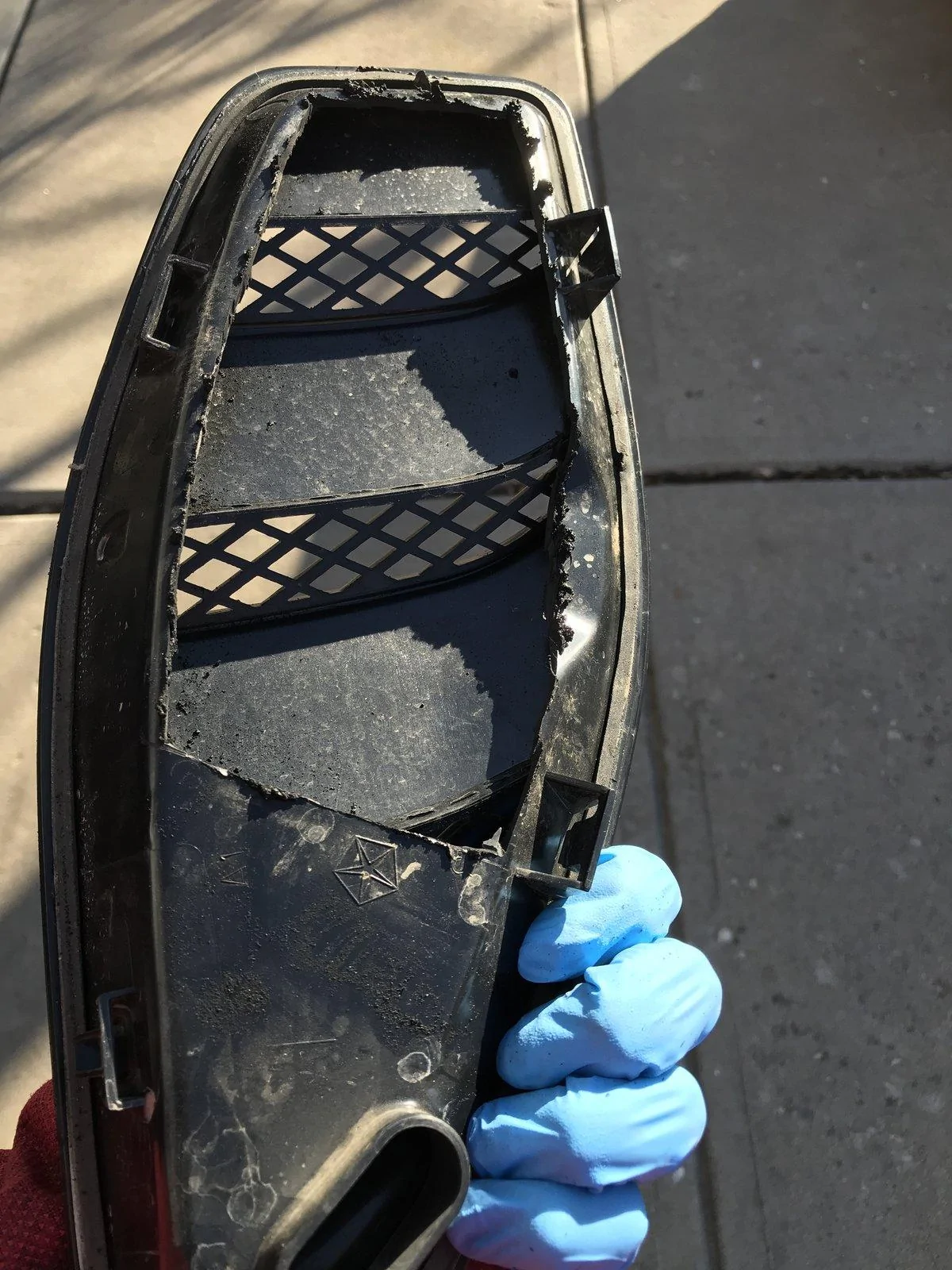

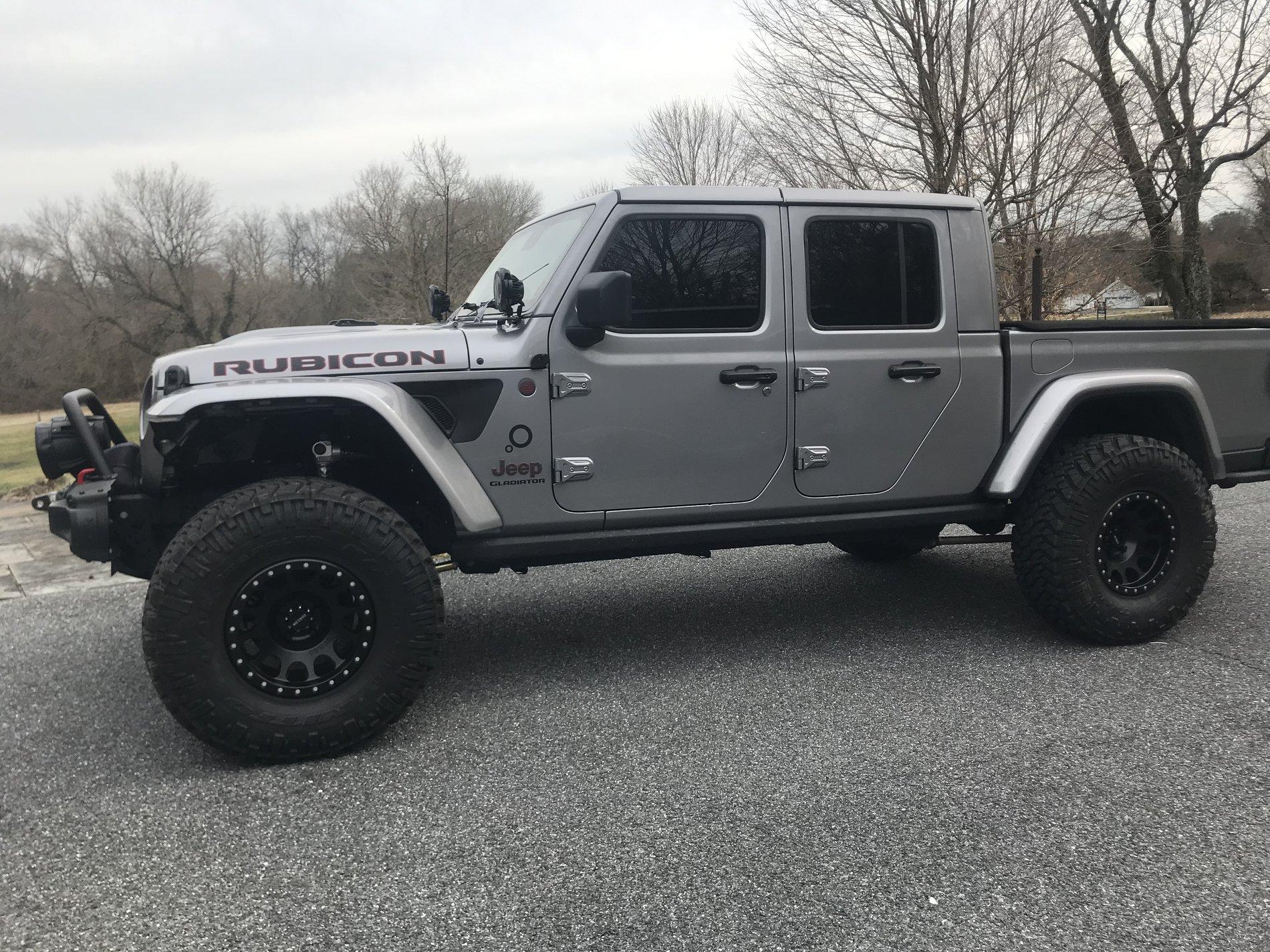

I have used a Dremel on many projects... cutting abs plastic and frame horns on a jk to fit a artec bumper and warn winch... to name a few.
Your dremel project photo reminded me of my only regret doing 39s so far... I wanted to keep the OEM fender look. The only solution is to start trimming the abs. Those liners limit like 2 inches of up travel. You only have one shot to do it right though..... hrrrrrrggg thanks a lot j/k ;). Ill figure something out.

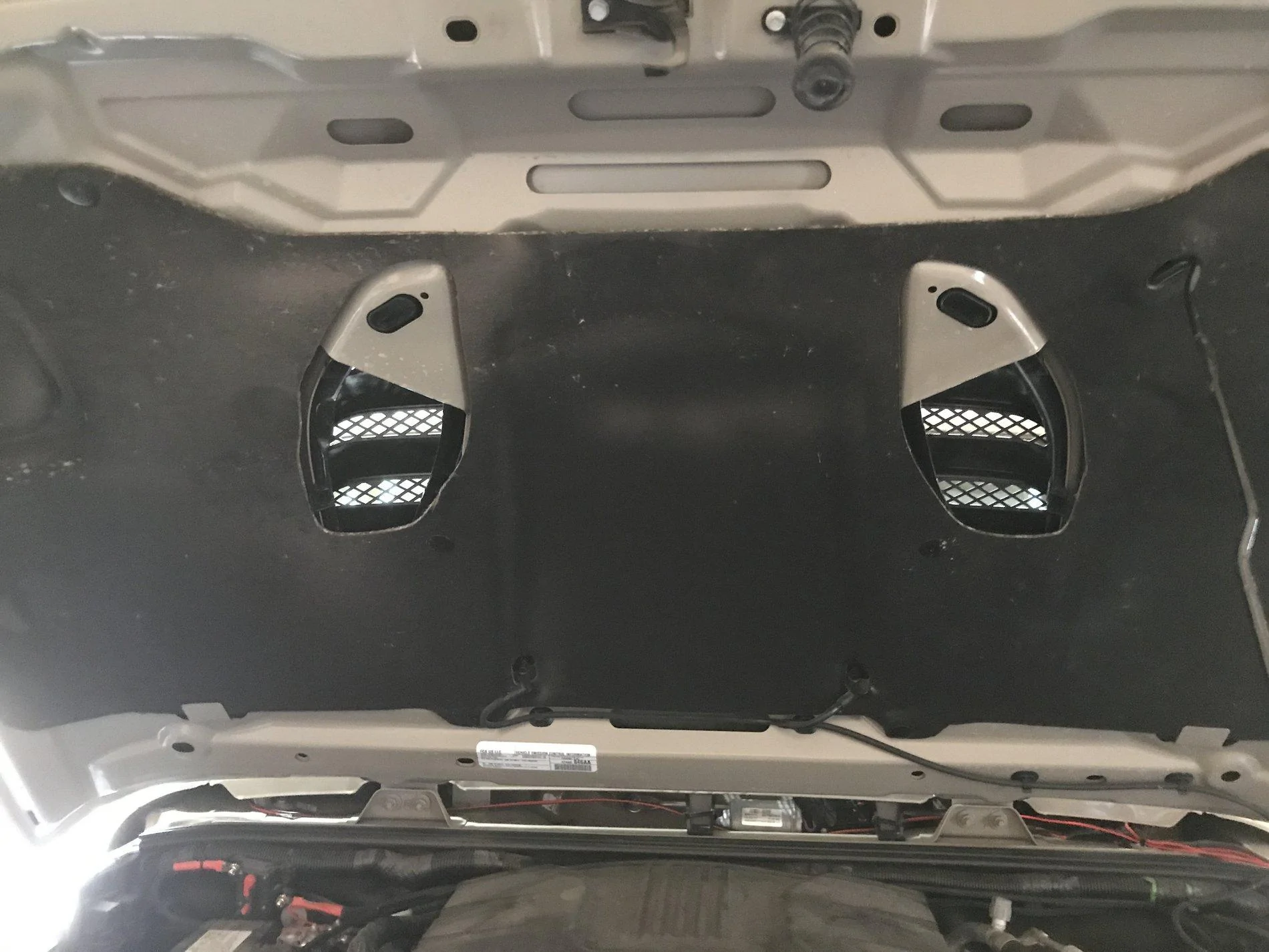

I wasn’t being too careful except to not got through the outside pretty parts... here is the vents installed.
When I did my buddies vehicle... I took my time and it came out really good.
