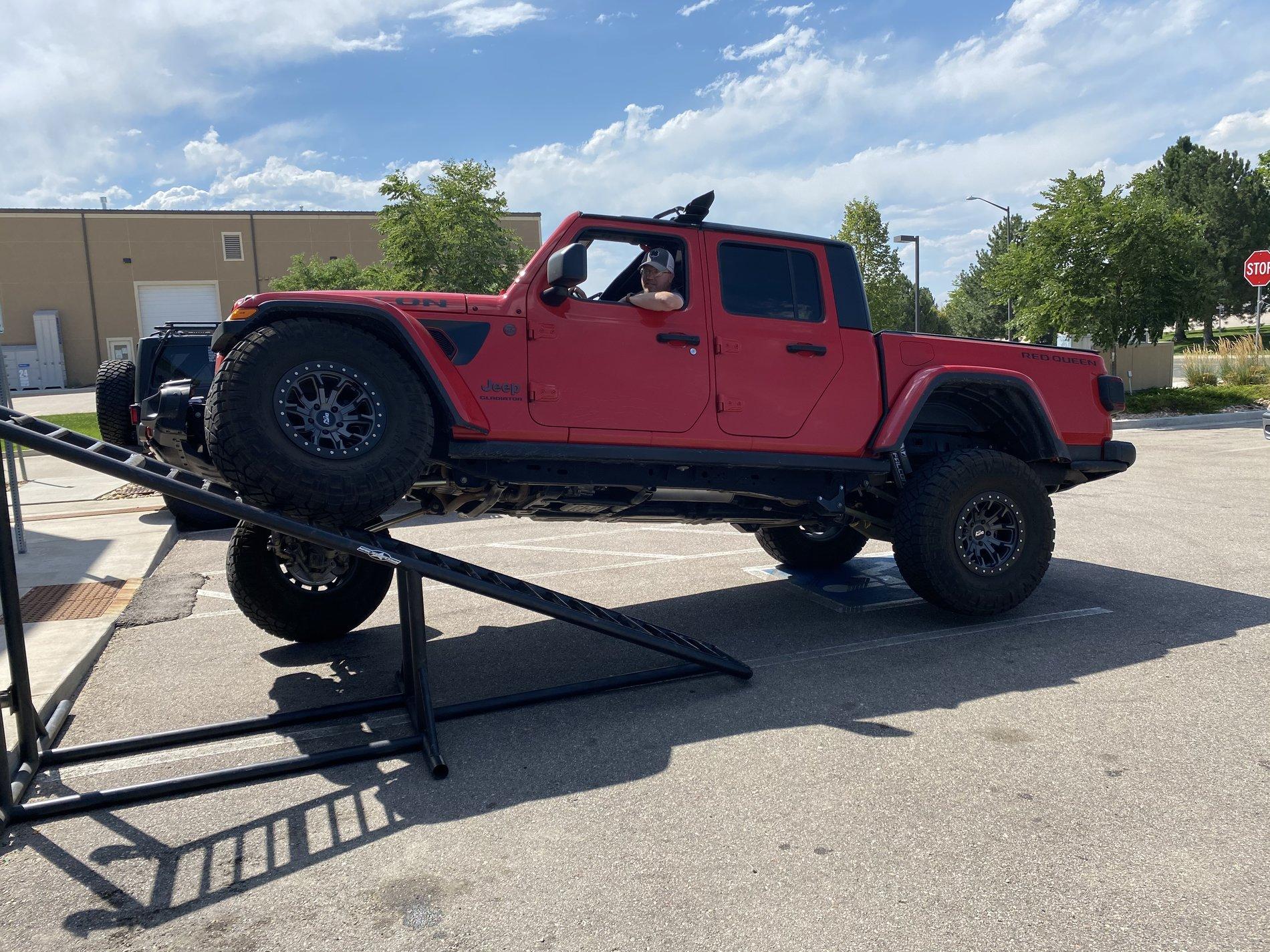

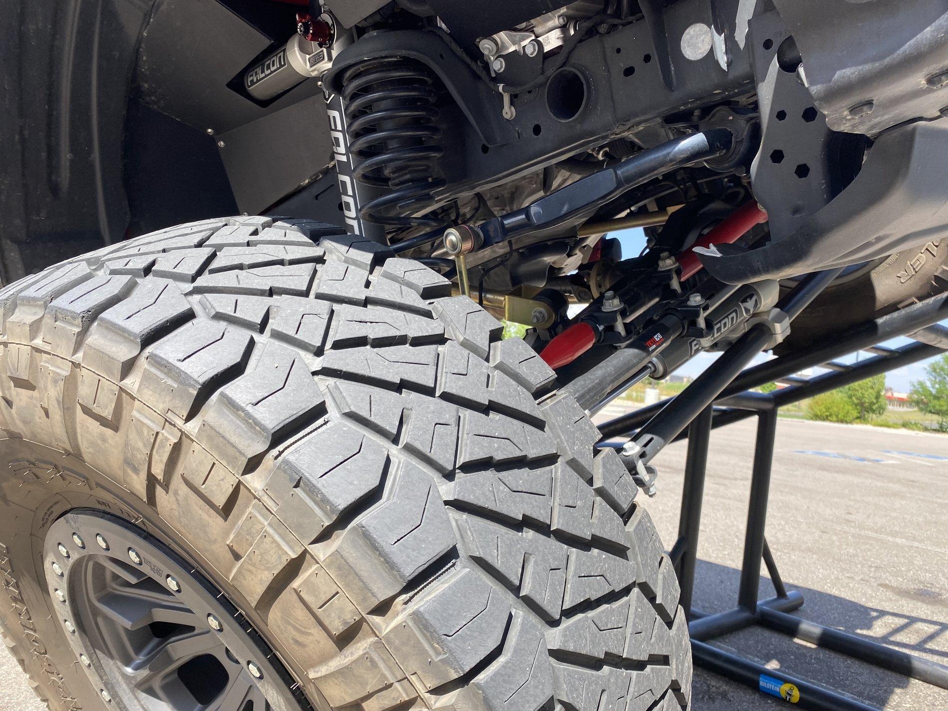

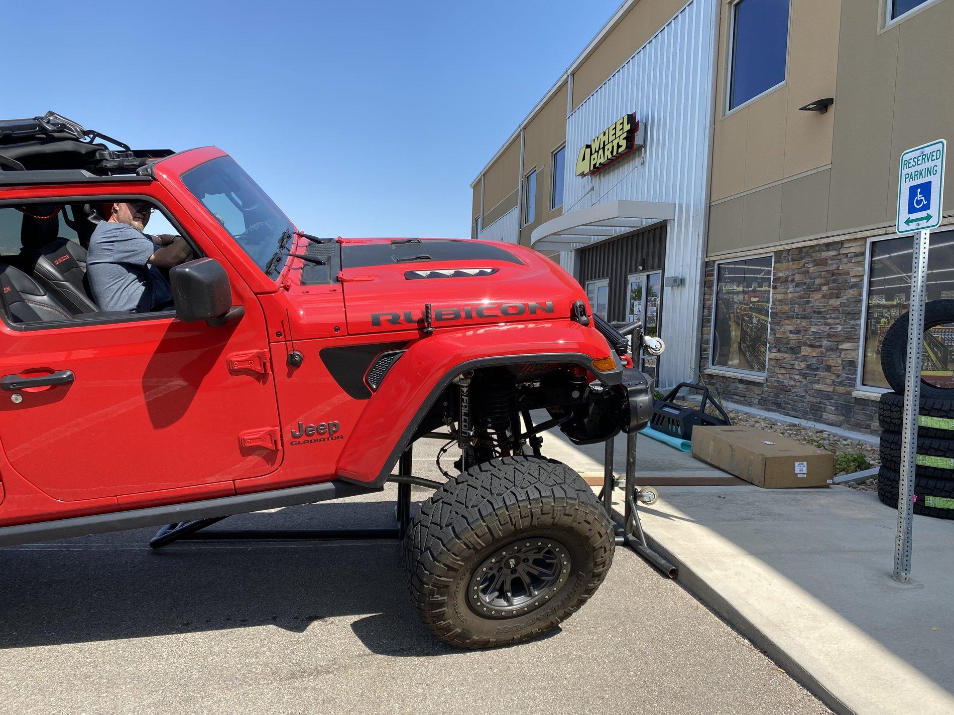

I was able to get my ride up on a rti ramp the other day. What surprised me is that when I got to my stoping point is that my rear driver tire was lifting off but I still had more room to go on the front. I got a score of 702... but now thinking of how I can get more articulation without loosing my rear swaybar and not buying the anti rock swaybar kit???

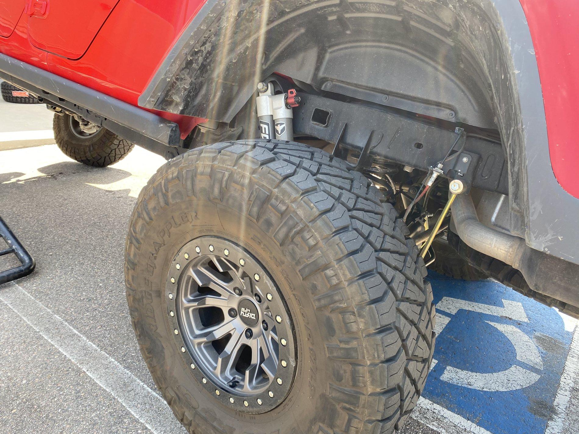

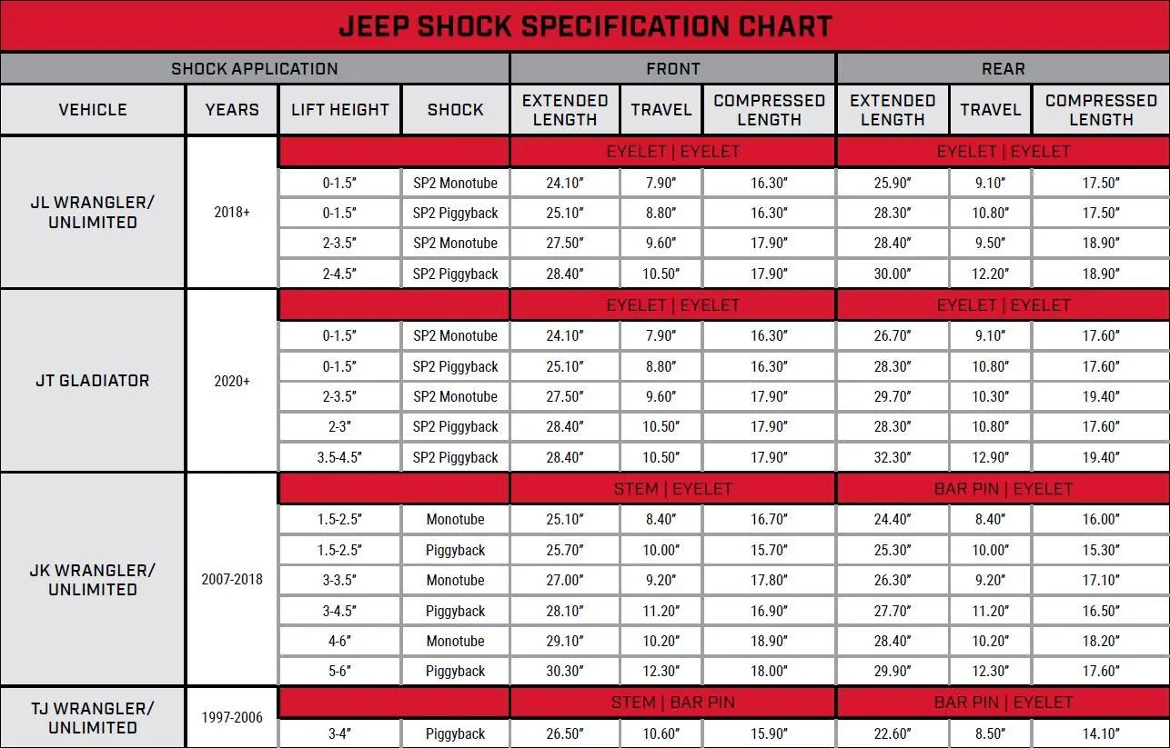

What’s the fully extended length of your rear shocks? Could that be the limiting factor?
thats great question... everything I read is that they extend to 30” but they could be the limiting factor. I just emailed teraflex so I will see.
So I got a reply from teraflex... I got the longest shocks they make for the JT in which the rears are 32.3” extended... idk maybe they are limiting my flex... I’ll have to try the ramp again after taking out the shock ;)

I believe the inexpensive Rocksport shocks MC offers allow for more flex than the falcons, even better are the 6 pack shocks they sell to maximize their flex (pricey option).
You are right that the 6packs are great flex shocks... I’ve had the rocksports before and yes they allow more flex... but in my opinion... they are a very basic mono shock. I wanted a Reservoir shock with adjustability. MC does not offer this type of shock and that’s why I went with the falcons.
