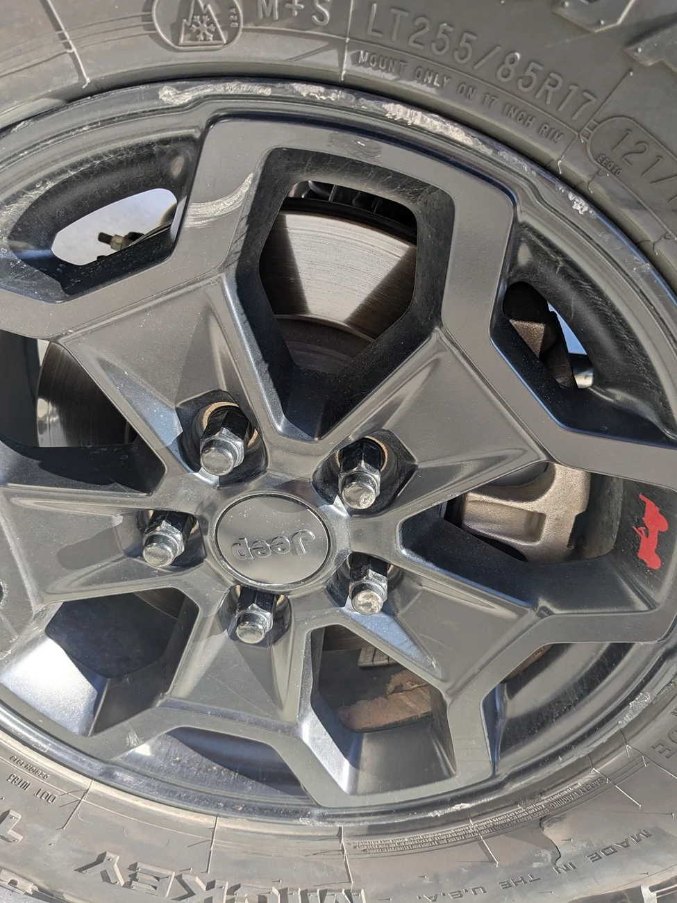

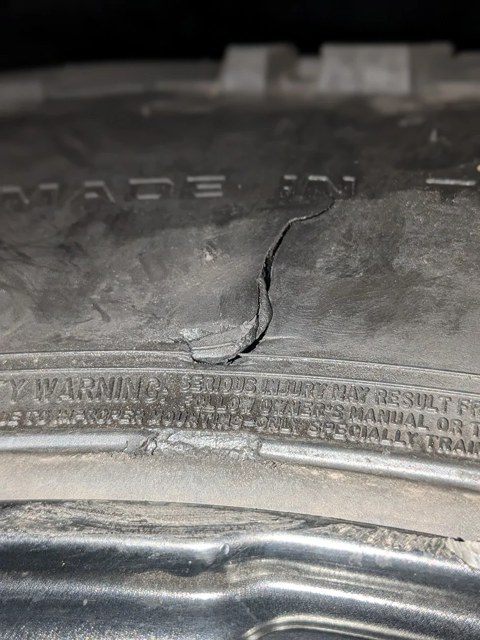

I did get a split on one of my MT 255/85/17 on Monday. It was definitely from a trail impact in September, but didn't split until 2000+ miles after the impact, after we dropped to 50° from our normal 80°.
Imagine how bad the damage would have been if you'd had a lesser tire.

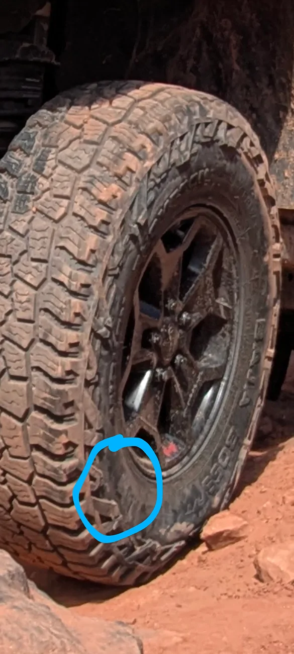

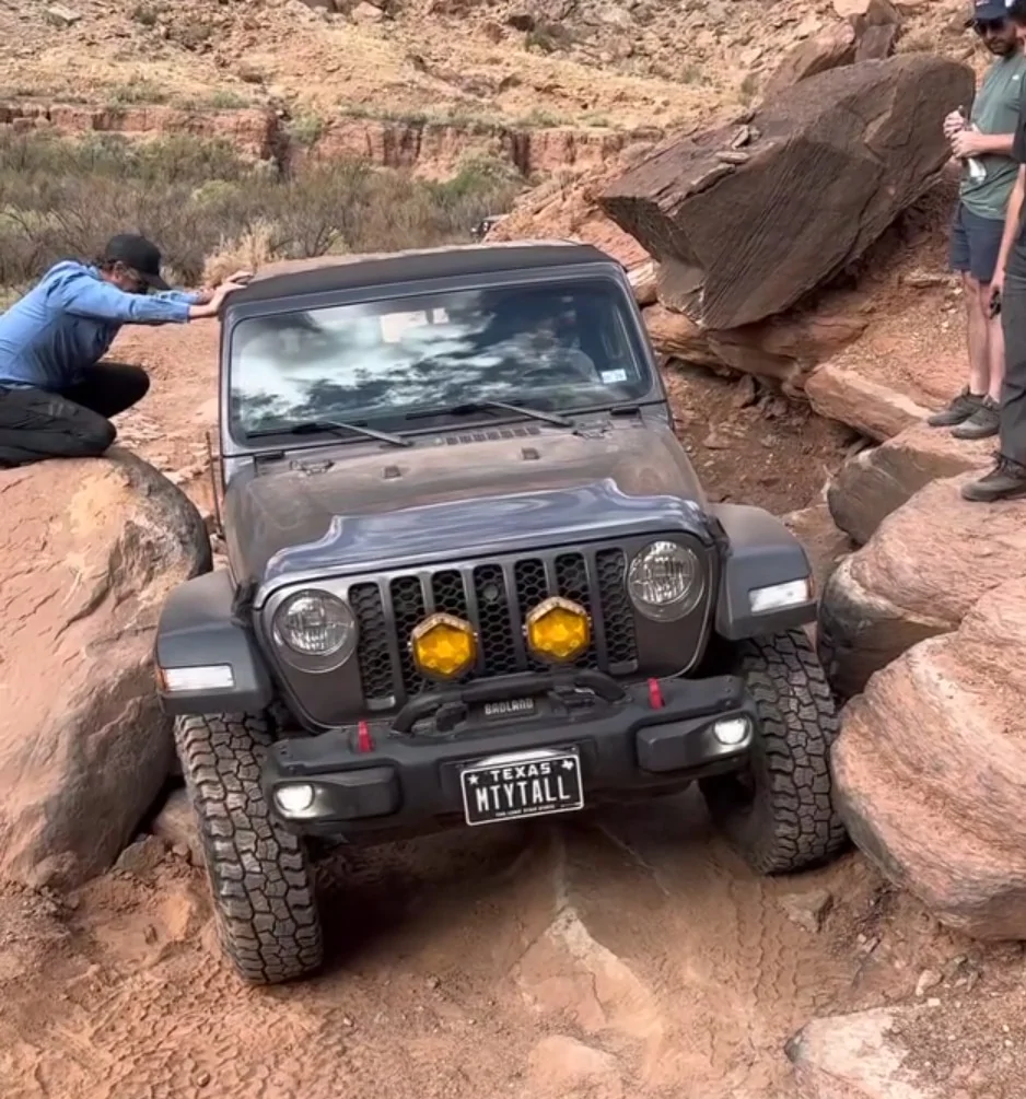

Definitely not the MT fault. Mine for not noticing it until now. After looking though photos, I had swapped out 2 damaged lugnuts October 12, and there in the photo, bottom right I see the split. On Hamburger Hill, zoomed in, there's the split. That tire has done 2000+ miles since that impact, no loss of air.
Detective much? I’m impressed that you found the split in early pictures.
