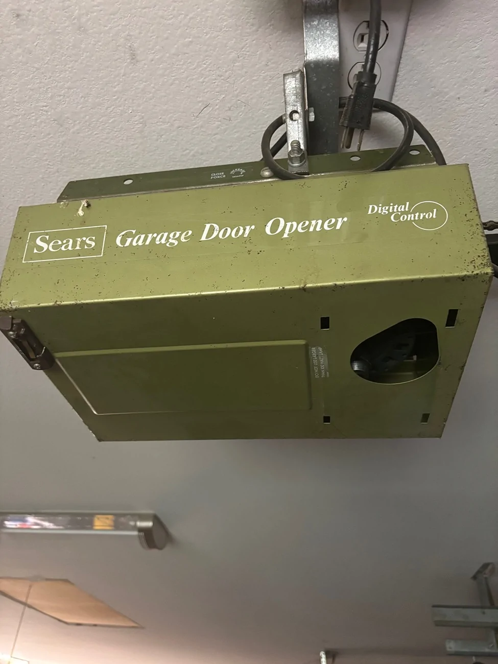

You ain’t lying on the garage door price. Thought about upgrading my single door for a nice insulated one because it’s probably 20 yrs old and it’s time. Once I saw the prices I just put some foam insulation sheets in there taped it up and called it a day. Pic for age reference:
Jeep Gladiator Minimal to no lift with high weight capacity? Does it exist? What else to consider? IMG_1898

Yeah I just have them manual door instead of powered . So the garage door opener on the gladiator has never been used . Probably wouldnt know what to don't I tried . Aint never had a powered garage door.
