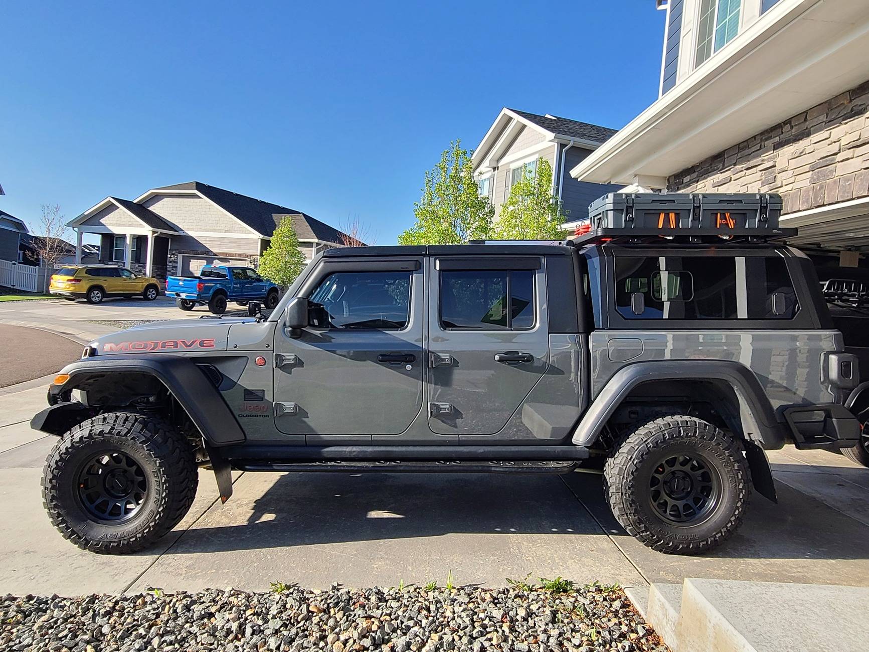

I experienced about 2 inches of sag when I add steel front and rear bumpers, winch, Smartcap, Frontrunner roof rack, a high lift and recovery tools. You can see it in my profile pic. Thats without camping gear, family and dogs, so stock suspension wasn't going to cut it. I was hitting my bump stops on speed bumps. I went with Dobinson 3in lift with rear springs rated for 880-1210 lbs and I believe the front are 200+lbs and Dobinson 3 way adjustable shocks, Metal Cloak F/R control arms and F/R tack bars and Rubicon express sway bar disconnects. The handling and driving improved dramatically. No more lean when turning with speed, no more bobble heading when going over any bumps or dips. I can soften or stiffen the shocks as needed. Heres a pic after the lift. I measured before and after and my 3in lift brought up about 5 inches, corrected 2in sag with 3in lift. Super happy with my choice, although it was not a cheap solution.
Jeep Gladiator How much weight does it take to sag a Mojave 20240424_075258

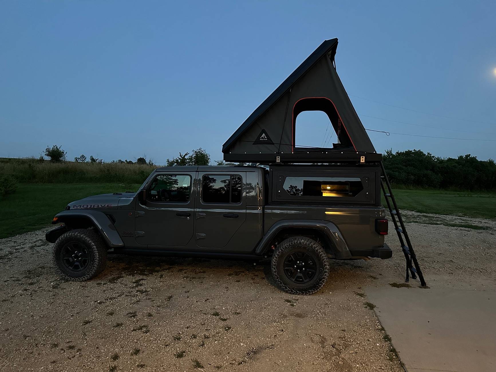

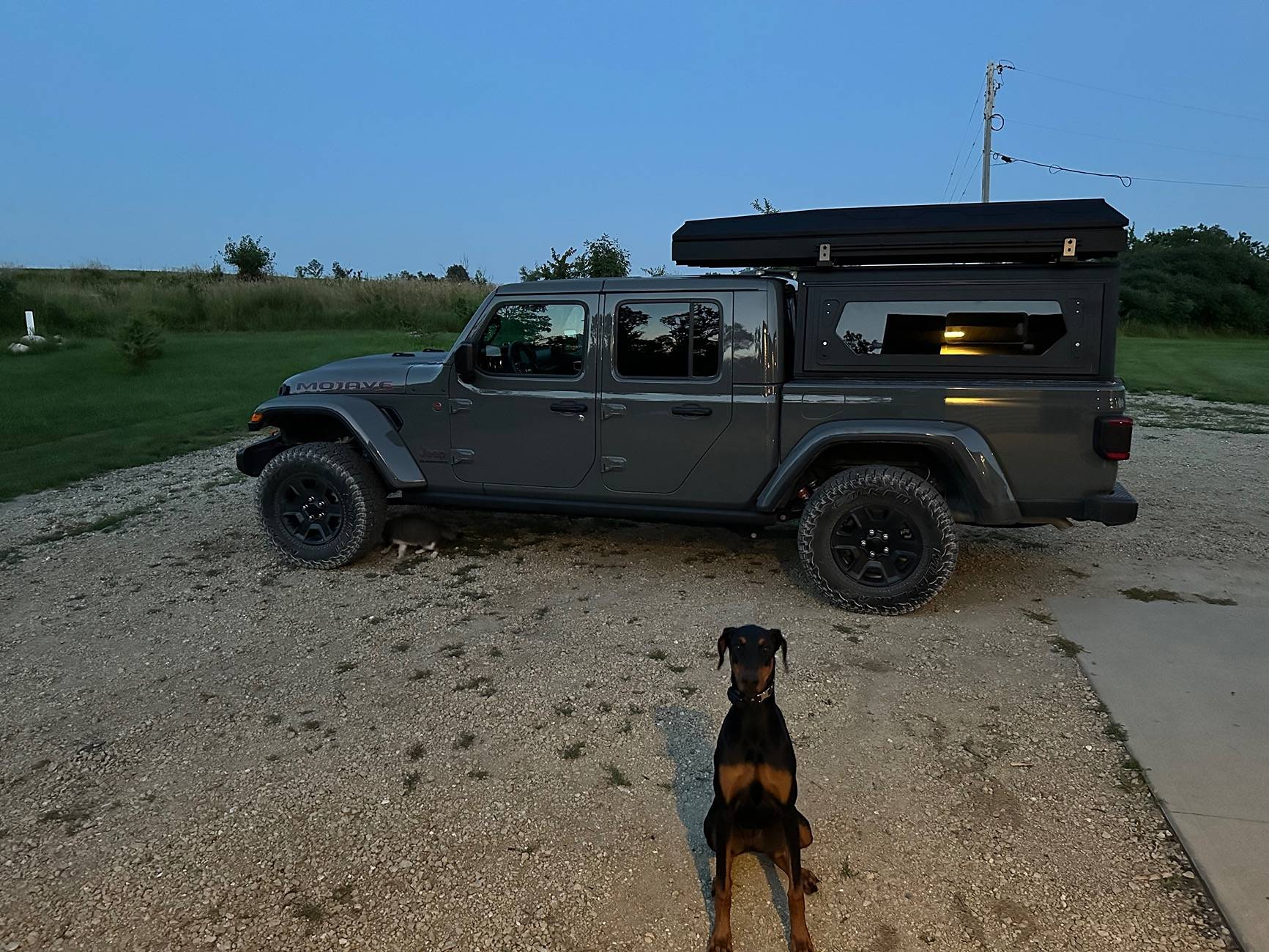

Just put the canopy and RTT on. Just under an inch of sag.
I plan on putting an AEV lift kit and Clayton springs in the rear. That way I keep the Fox shocks and stock stance. Thanks everyone!
Pictures or it didn't happen. :)

Nice. I miss having my ACCC sometimes, but we were not using it enough to justify keeping it on the truck.
