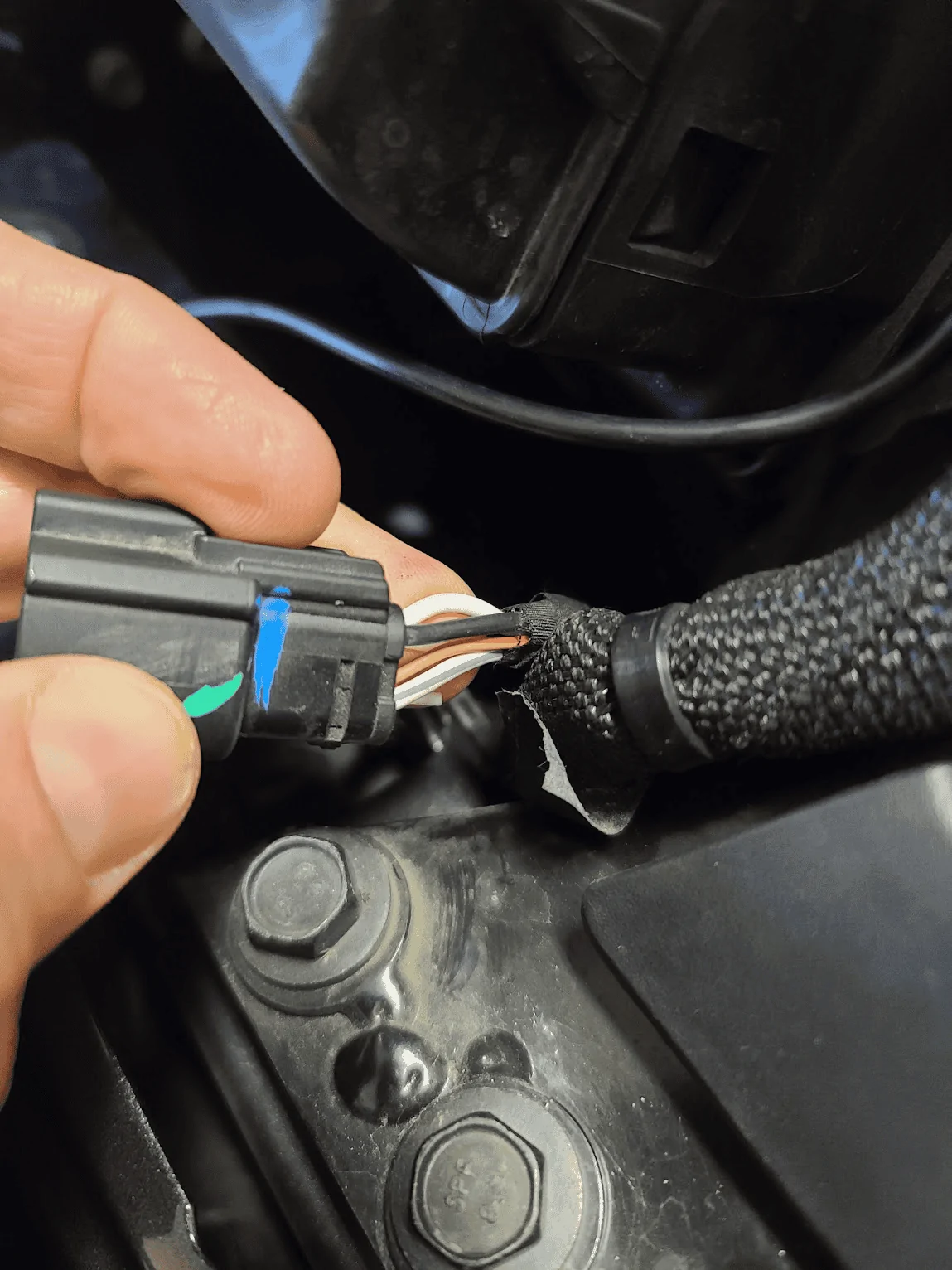

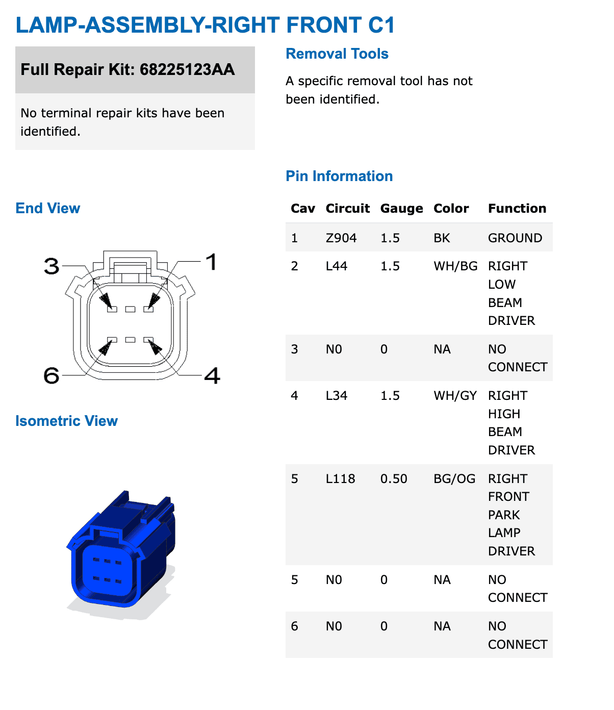

Supposedly in 2021 jeep started having the halo wire in the headlight harness from the factory. If you have 4 wires the stock LED lights are plug and play. If not the Halo won't work unless you wire it up.
It's true. I just wired up some SS5's and wanted the backlights to come on when the halos did. I searched around and found some information:
Jeep Gladiator Mis-matched lighting Screen Shot 2022-11-29 at 4.35.02 PM
I confirmed that pin #5, labeled as "RIGHT FRONT PARK LAMP DRIVER" is the feed to the halo, which is a misleading label to me.
Jeep Gladiator Mis-matched lighting 1669770818082
It's the beige (almost orange) wire with the orange stripe (looks pink here)
Basically, it's a 12V ignition-switched lead.

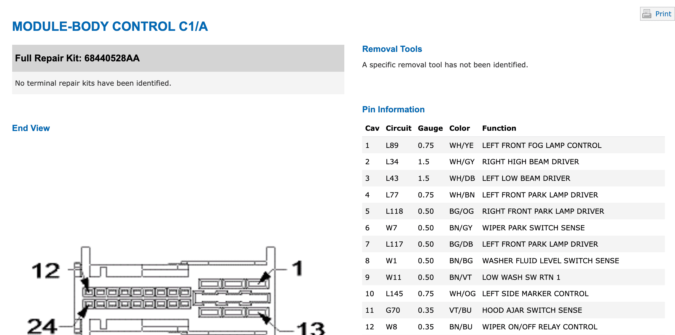

Also, it is separately controlled by the BCM, in the C1 harness, also Pin #5 incidentally:
Jeep Gladiator Mis-matched lighting Screen Shot 2022-11-29 at 8.20.14 PM
So, if you don't have factory halos with the 4-pin harness, you could always hack the BCM harness and tap into these leads (PIN 5 for passenger, PIN 7 for driver), then use Tazer or JScan to enable these outputs. There are detailed write-ups on the JL forum on how to tap into these BCM outputs.
