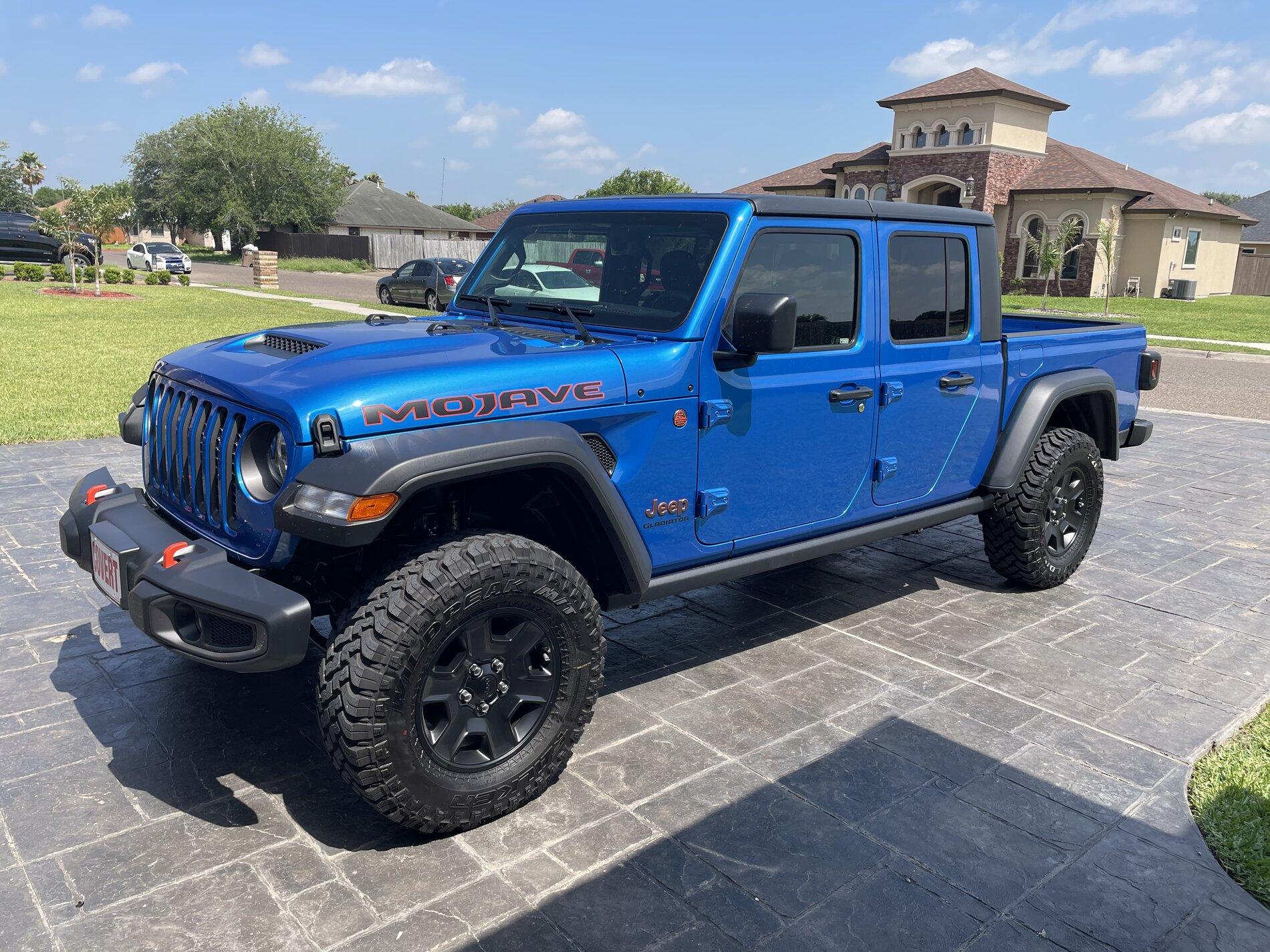

Love this color so so much!
Got mine on Monday!!
Put my 35s minutes after this picture, so far everything has been great!
