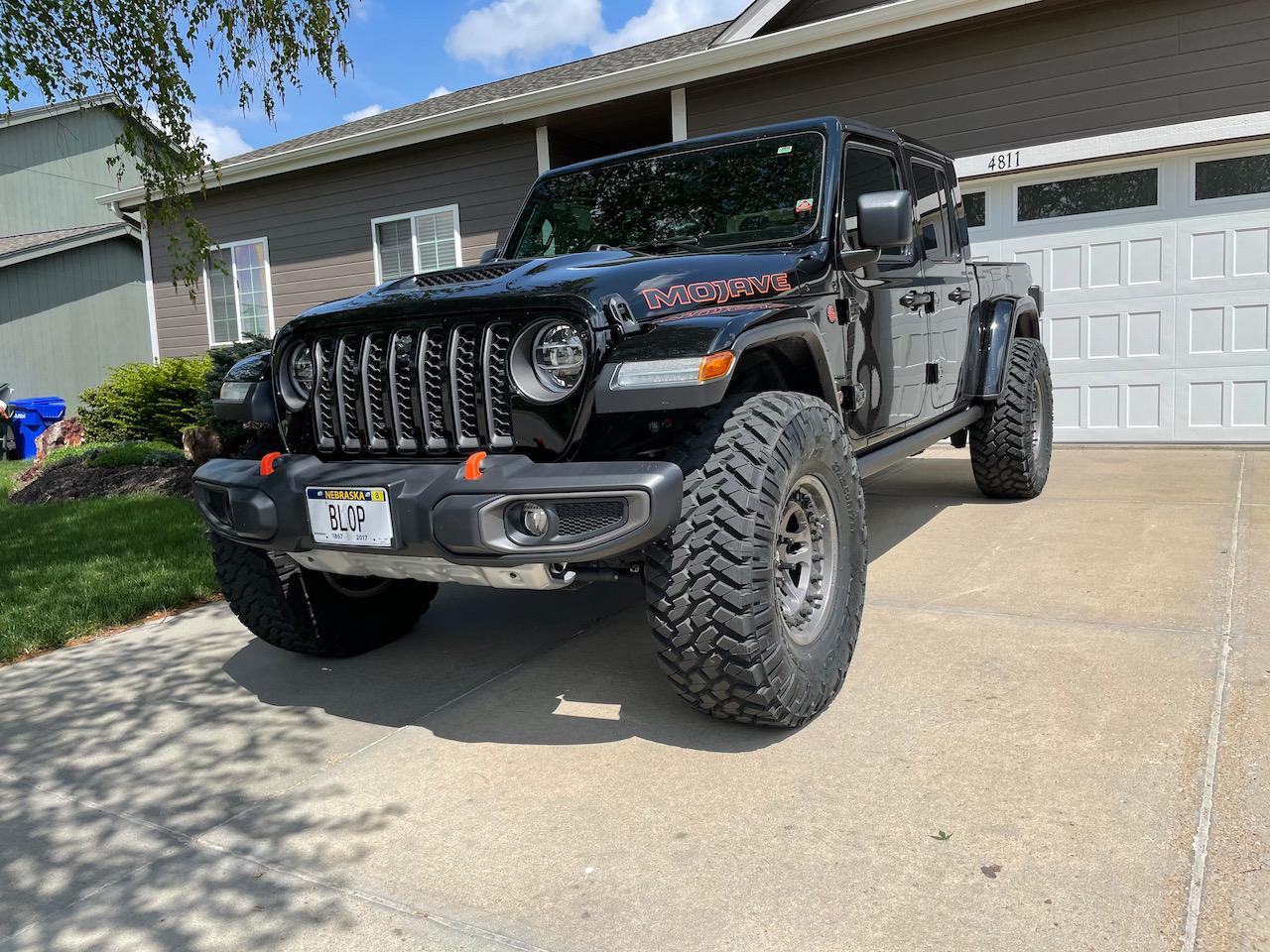

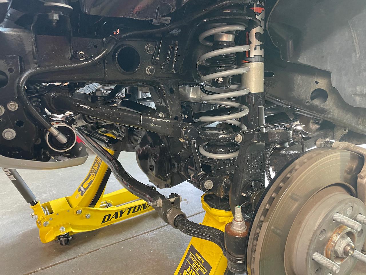

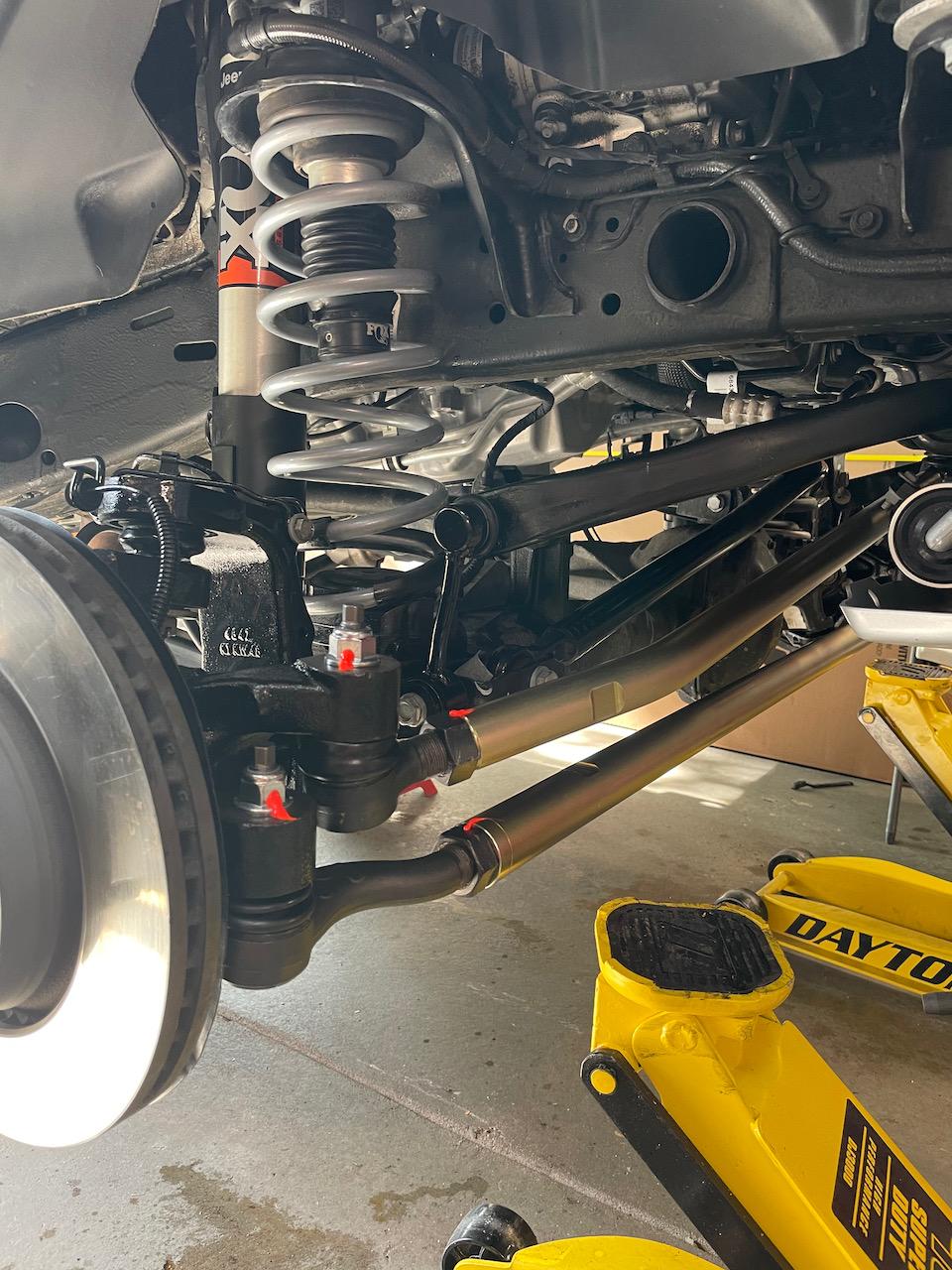

Had to get a longer bolt for the front shock brackets and some washers for spacing due to the upgraded shock mounts on the axle.
Are those spacers you put on there standard Teraflex spacers? The Mohave doesn’t need special spacers, it’s all about the shocks, correct?

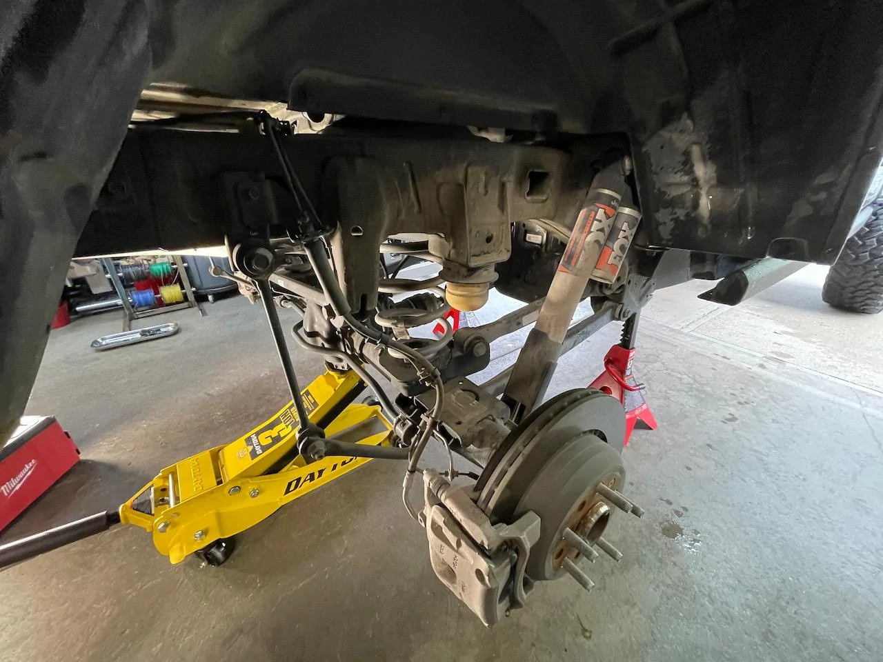

This is my current after adding the 3/4” rear spacer. Next up is a magnusson blower. Might sell the Mojave shocks and go fox 3.0 bp/dsc racing shocks this summer.
So far the truck drives really really well. It’s one finger stable at interstate speed even over bumps.
So, any spacer will work, correct, or does it take special spacers for the Mojave?

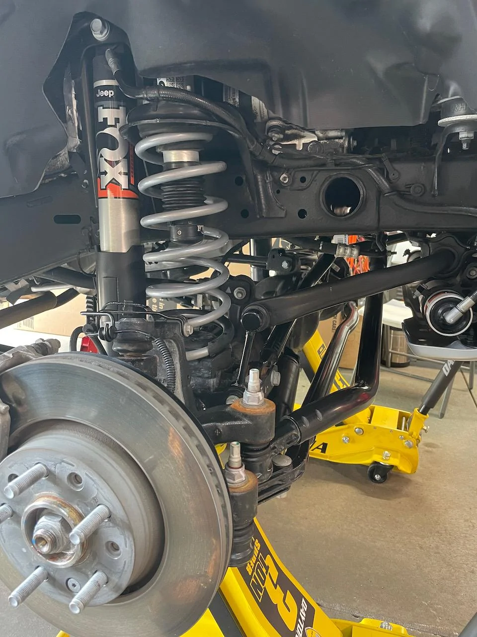

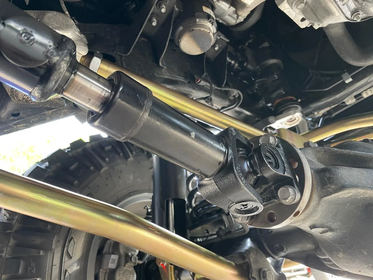

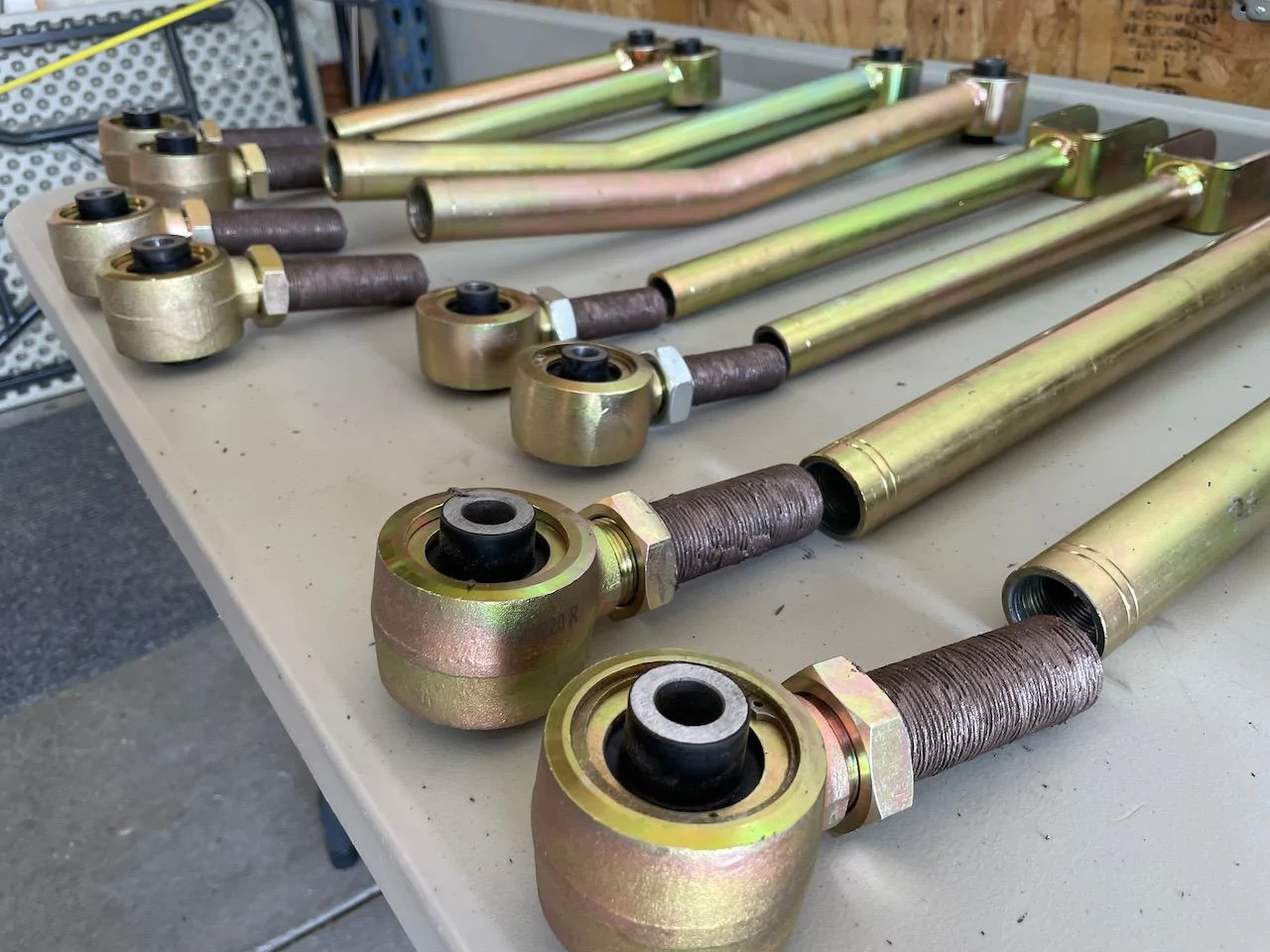

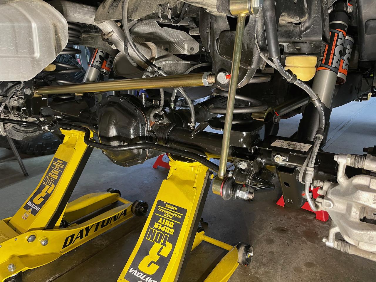

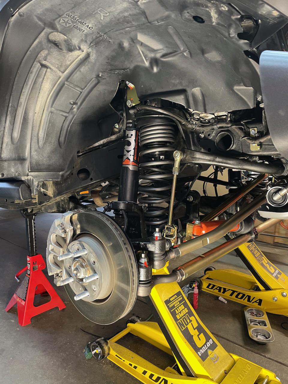

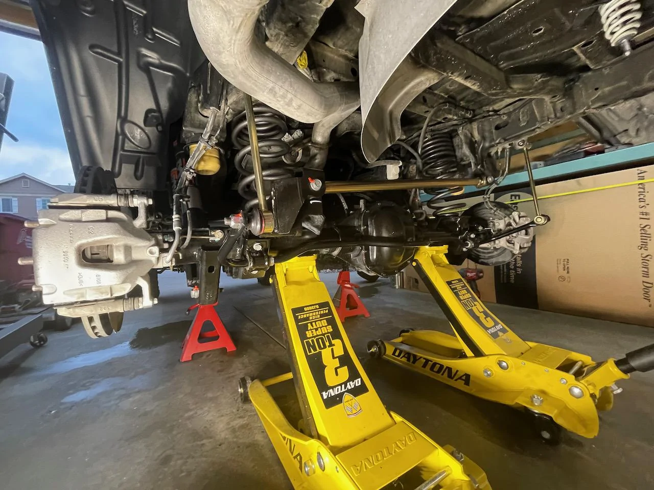

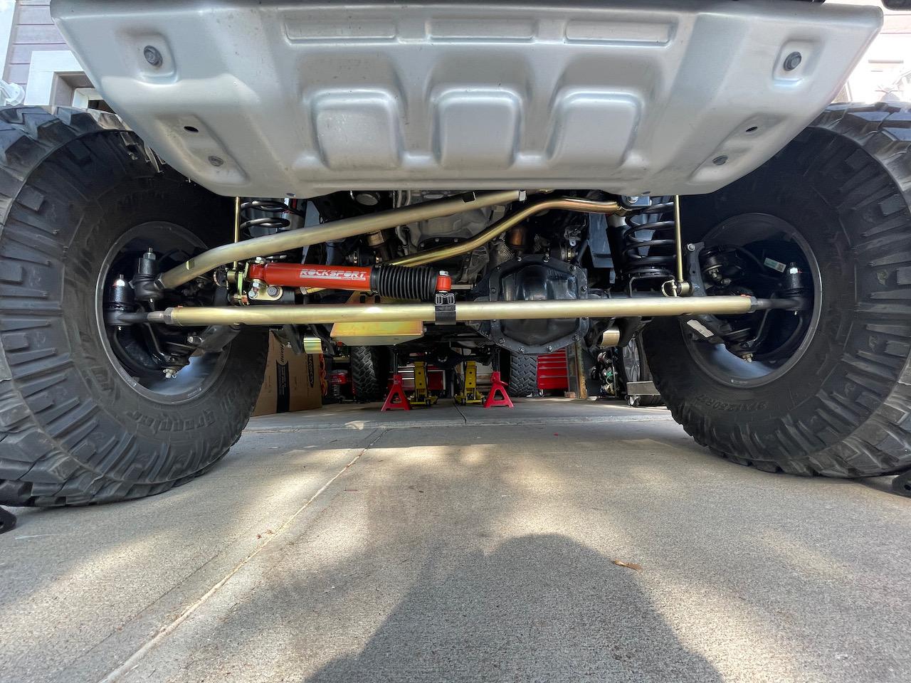

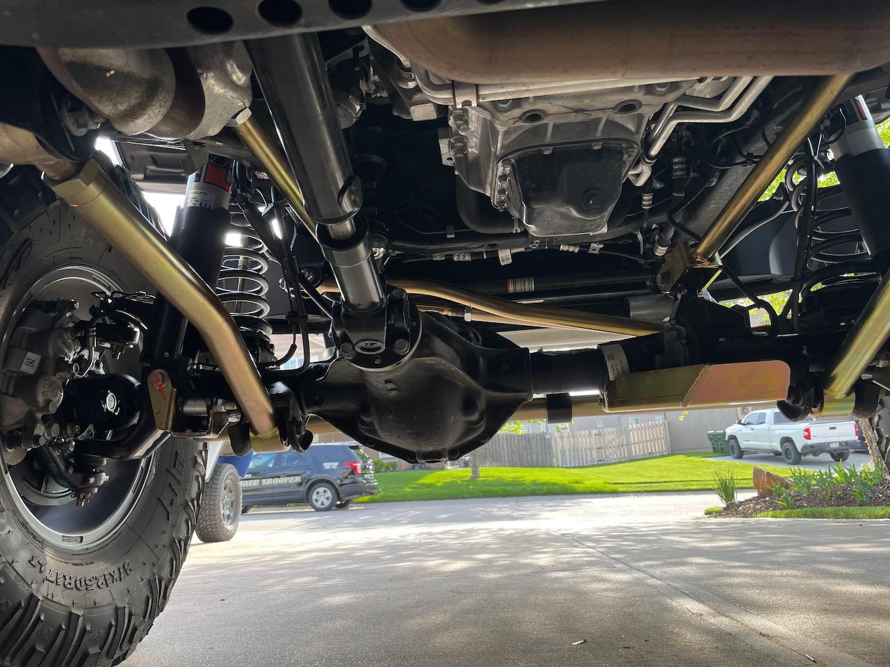

I recommend looking at the MetalCloak 3.5" GameChanger Suspension lift for the Mojave. This is the lift I just finished installing on my Gladiator Mojave last weekend. You can see the build on my DirtGadgets twitter account. There aren't great instructions, but if you're comfortable working under a vehicle and have some basic tools you can do it yourself.
I also mounted Nitto 37x12.5x17 rubber on some 17x9 Hutchinson Rock Monster wheels before the lift. Those larger wheels fit fine without any rubbing on the Mojave. I drove it for a couple weeks on the highway and city streets of Omaha, NE.
As an aside, ignore all the people chiming in saying that the Mojave was designed for a specific purpose and you should leave it alone. That's a ridiculous, trollish thing to spew. Jeeps are designed to be modified. The Mojave is no exception. It's your Jeep. Modifying it is part of the culture. While there aren't a lot of options to lift the Mojave, the MetalCloak lift kit worked out really well. I love it.

Did you replace the driveshaft when you installed the metalcloak?
That's a little aggressive for me, I just want a hair more ground clearance. I don't plan on running 37's.

I agree, "what it's meant for" is fine but it's mine I'll <cartman voice> DO WHAT I WANT </cartman voice>
I did replace the driveshaft. It wasn't difficult, it just took a bit of extra elbow grease. If you're running smaller tires (smaller than 37's) you can do the 2.5" GameChanger. It's not as tall. You get all the same control arm and track bar hardware, just different springs. I installed the 2.5" GameChanger on my wife's Wrangler. Turned out very nice. She's running 33's. Actually the 33's off the stock Mojave. 33 inch tires look a bit small in her fender wells. I think 35's would look perfect. All said, it's hard to do better than MetalCloak when it comes to quality hardware.
