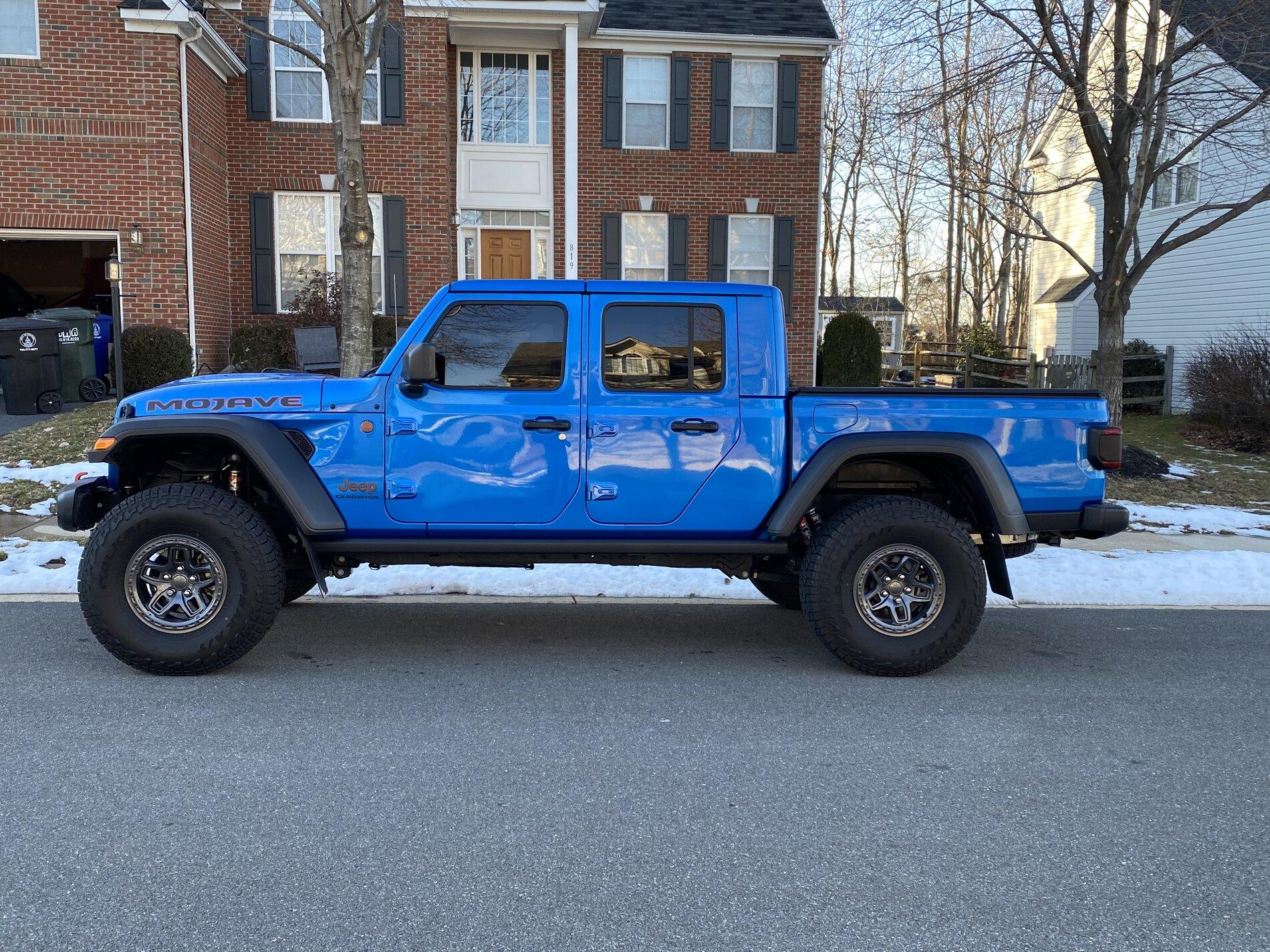

This is my current after adding the 3/4” rear spacer. Next up is a magnusson blower. Might sell the Mojave shocks and go fox 3.0 bp/dsc racing shocks this summer.
So far the truck drives really really well. It’s one finger stable at interstate speed even over bumps.
