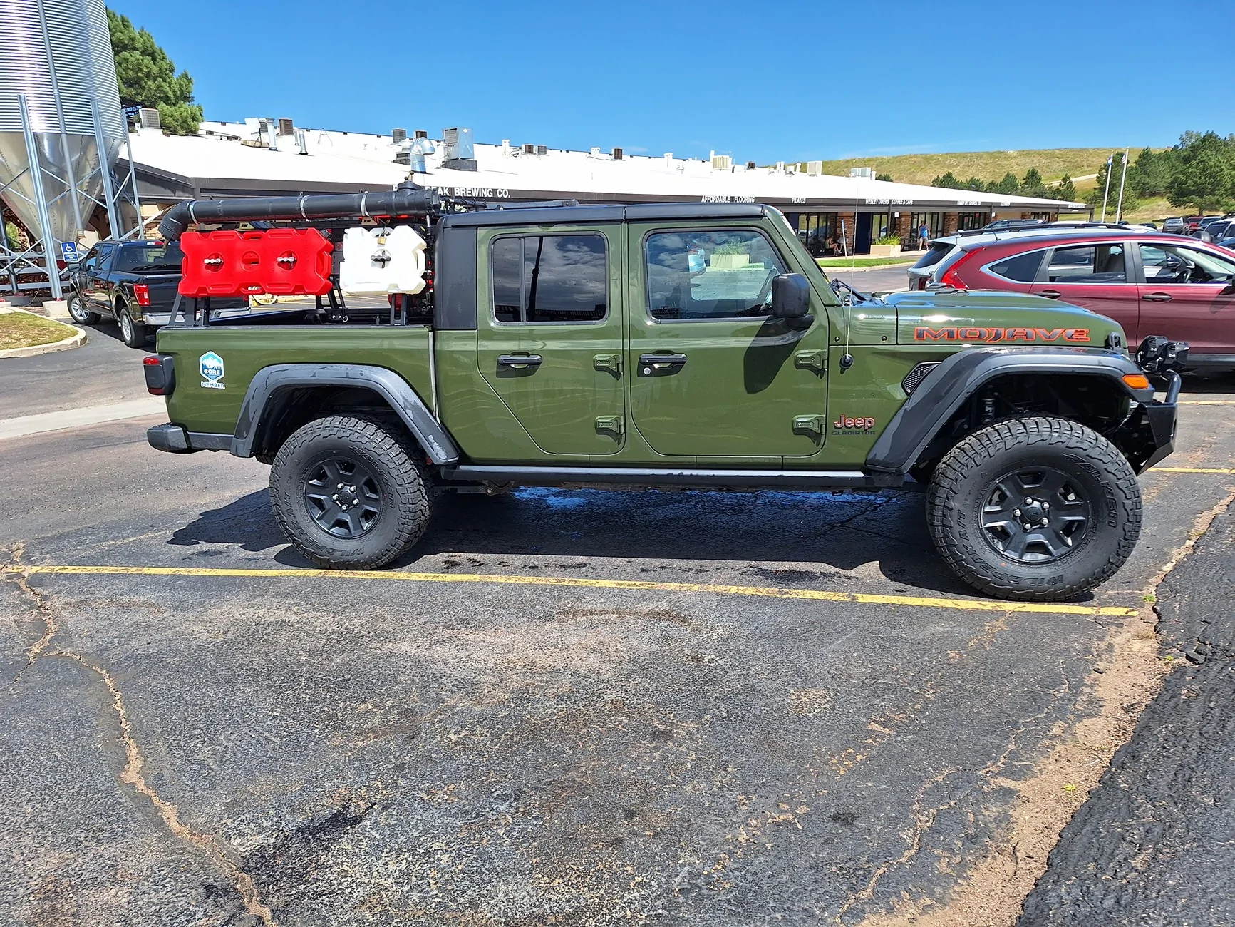

I purchased my AEV 2" spacer from Predator 4 Wheel Drive in Colorado Springs and they deleted the ProCal from the order since I was buying a TazerMini. I have gone about 70k since the install and I love it.

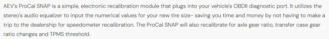

Why would the 2" kit need a tuner? Legit question so someone please enlighten me.
The OP is just referring to the ProCal Snap device that AEV packages with their lifts to change the tire height in the computer. The 'tuner'.
