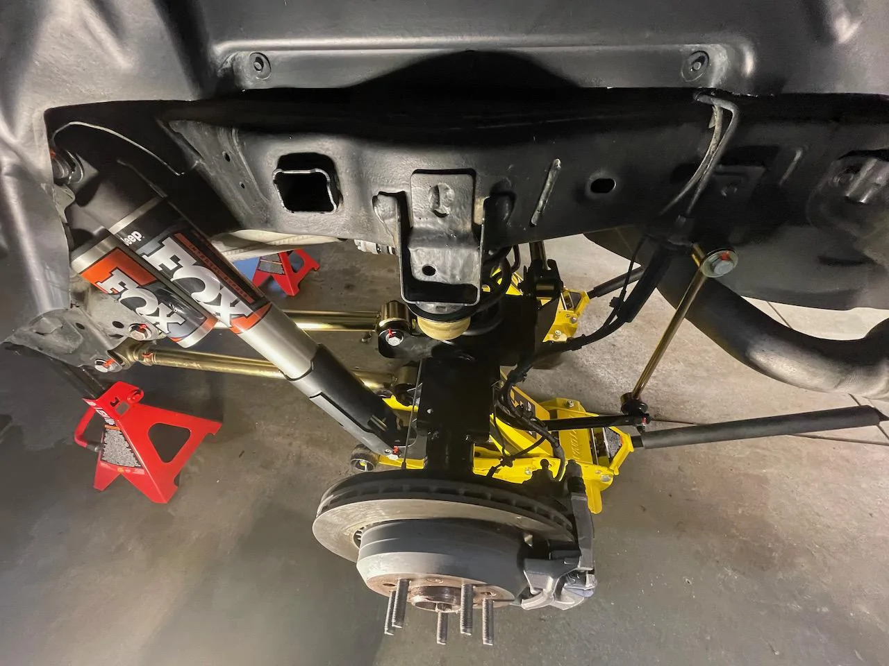

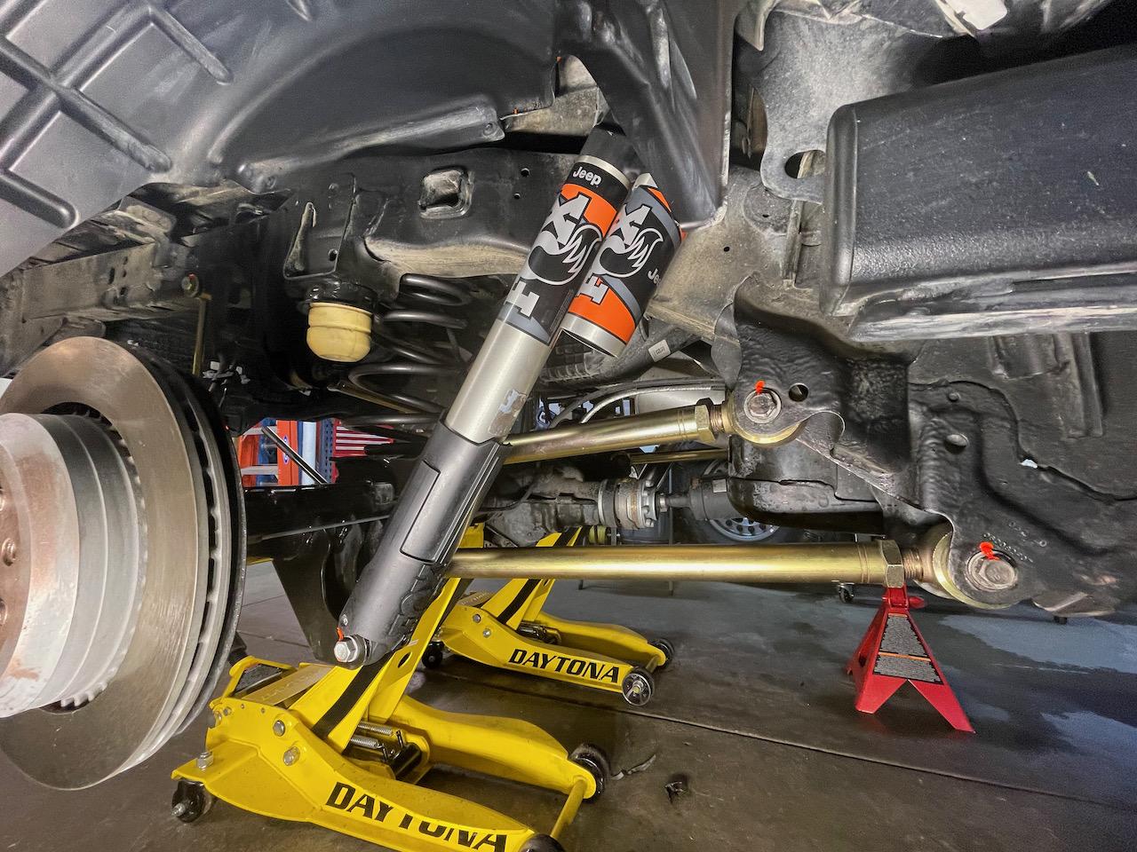

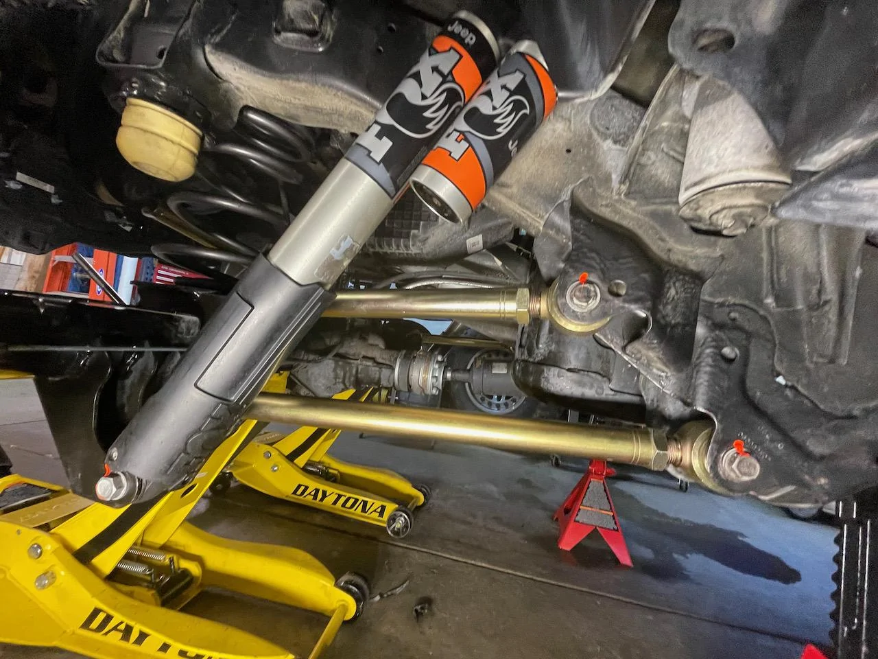

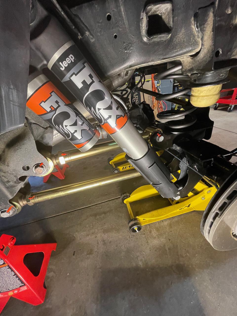

so, I was looking at this lift over at their website, it does look pretty great, but I am confused about one thing, it doesn’t look they do anything with the rear shocks, just provide brackets for the front? Is this correct? That doesn’t seem like it would work out right...
It works out just fine. The MetalCloak kit comes with both upper and lower shock relocation brackets for the front. However, it does NOT reorient the rear shocks. You get new rear springs, rear track bar, rear upper and lower control arms, and sway bar links. However, due to the simpler geometry in the rear no relocation brackets are necessary to use the stock Mojave shocks. The new MetalCloak springs (front and rear) are MUCH bigger than the stock springs.
It does seem counter-intuitive to use the rear stock Mojave shocks without relocation brackets, but it isn't necessary. The stock springs will fall out easily before the stock shocks are at full extension. The new MetalCloak springs allow the stock Mojave shocks to go to full extension without falling out. It's a big improvement!
Here are a few pictures of the rear stock Mojave shocks installed with the new MetalCloak springs and other hardware.
