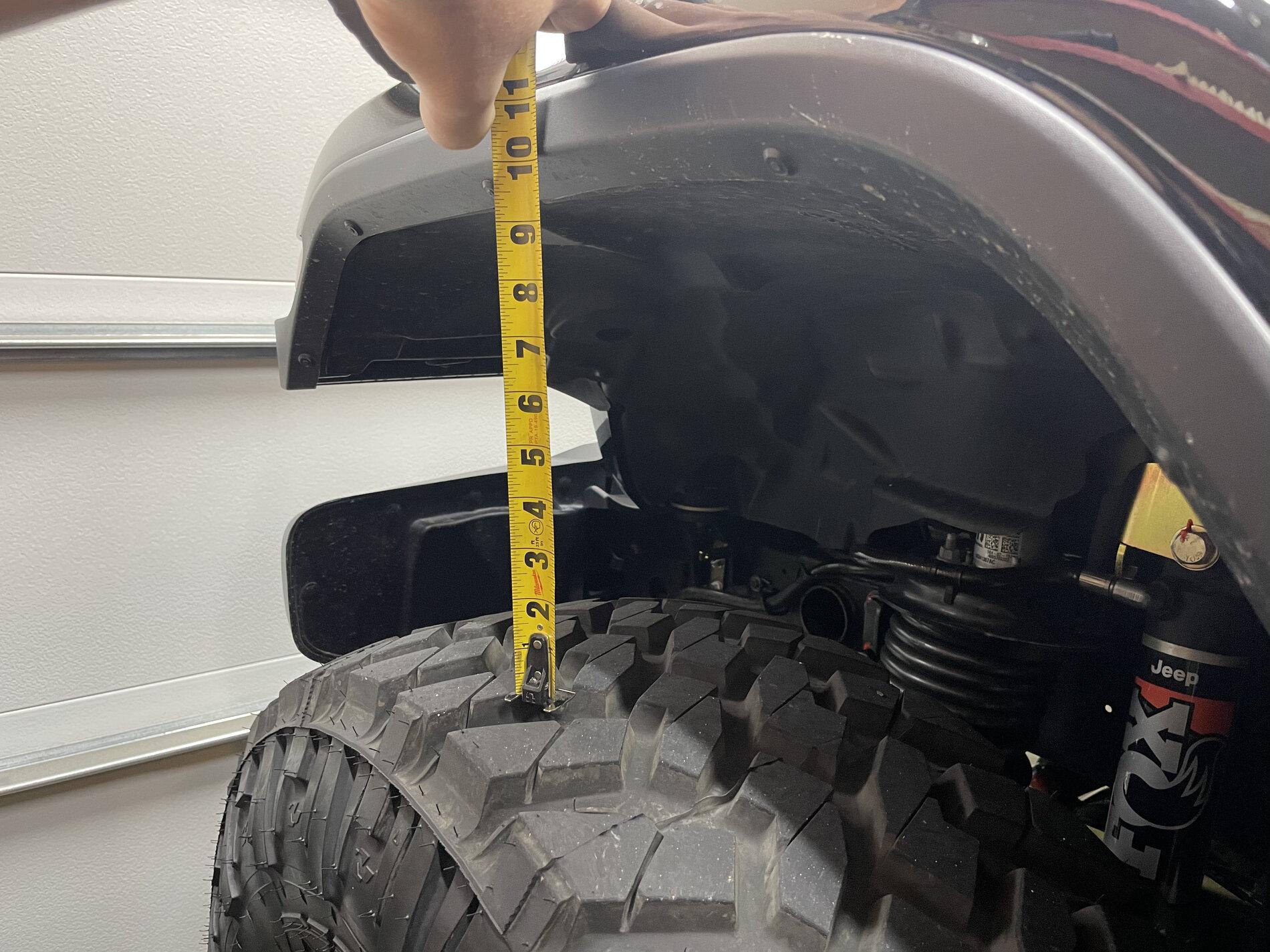

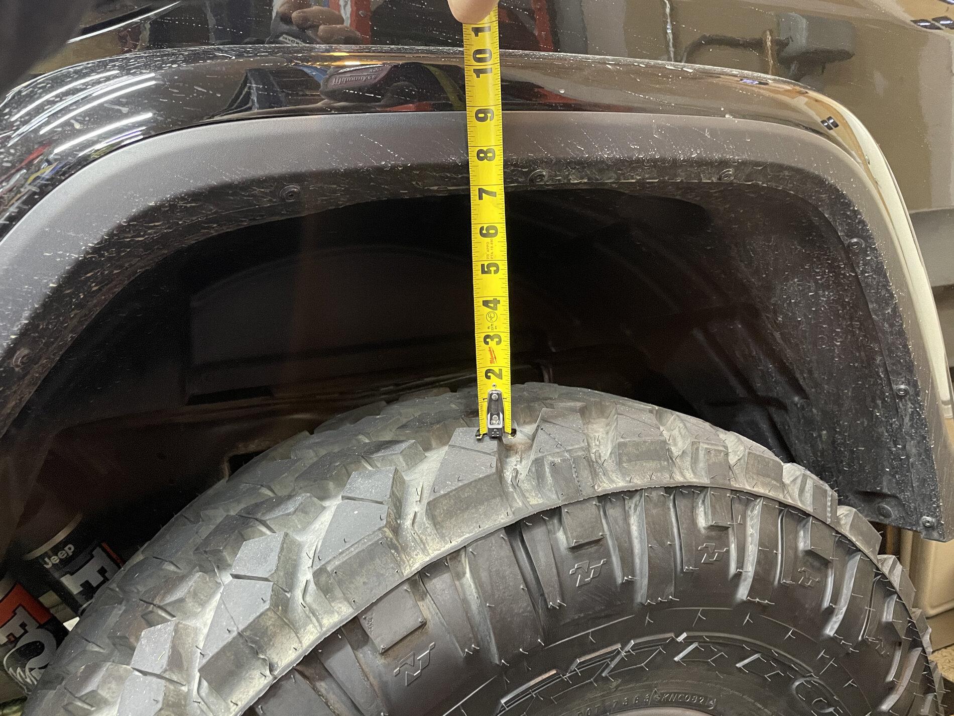

Thinking of putting a Fabtech 2 inch Trail Lift Kit on my Mojave and keeping the stock Fox shock set up. My Jeep dealership's service department said it was the one that they would recommend since the Mopar lift won't work. My questions is that since the Mojave is already lifted an inch above the Rubicon, would this lift kit add another 2 inches or would it be displacing an inch or so? Hopefully, not since that would make it worthless. Just wondering.
I didn't measure the stock height of my Mojave before I lifted it, but to my knowledge the Mojave's stock lift configuration is only 1 inch taller than the stock Rubicon configuration in the front. The back is the same for both.
As far as additional height over stock goes, you should expect that either the MetalCloak or Fabtech lifts will add their height to the stock height. If you leave the stock tires on you'll see massive gaps grow between the fender wells and the tires after installing the lift. After going up to 37x12.5x17 Nitto Trail Grappler tires I ended up with 9-1/4 inches of clearance between the front tires and the outer, bottom edge of the front fender flares. On the back the clearance came out to 6-7/8 inches of clearance.
Here's the front. You can see the MetalCloak upper shock, drop brackets with the stock, Fox shocks. There's also a lower shock relocation bracket for the front. The lower shock relocation bracket also shifts the shock location to be outboard rather an inboard to give you tire clearance.
Jeep Gladiator Mojave Lift Options Front
Here's the back. There's no shock relocation or drop brackets to install on the back.
Jeep Gladiator Mojave Lift Options Back
Do you know what size tires you plan to run on the Mojave after the lift? If you're going to 37's or 38's I recommend going with MetalCloak's 3.5" GameChanger lift for the Jeep Gladiator Mojave. This will allow you to retain the stock Fox shocks and give you another 1.5 inches of height over the Fabtech lift. That extra height will be valuable.
