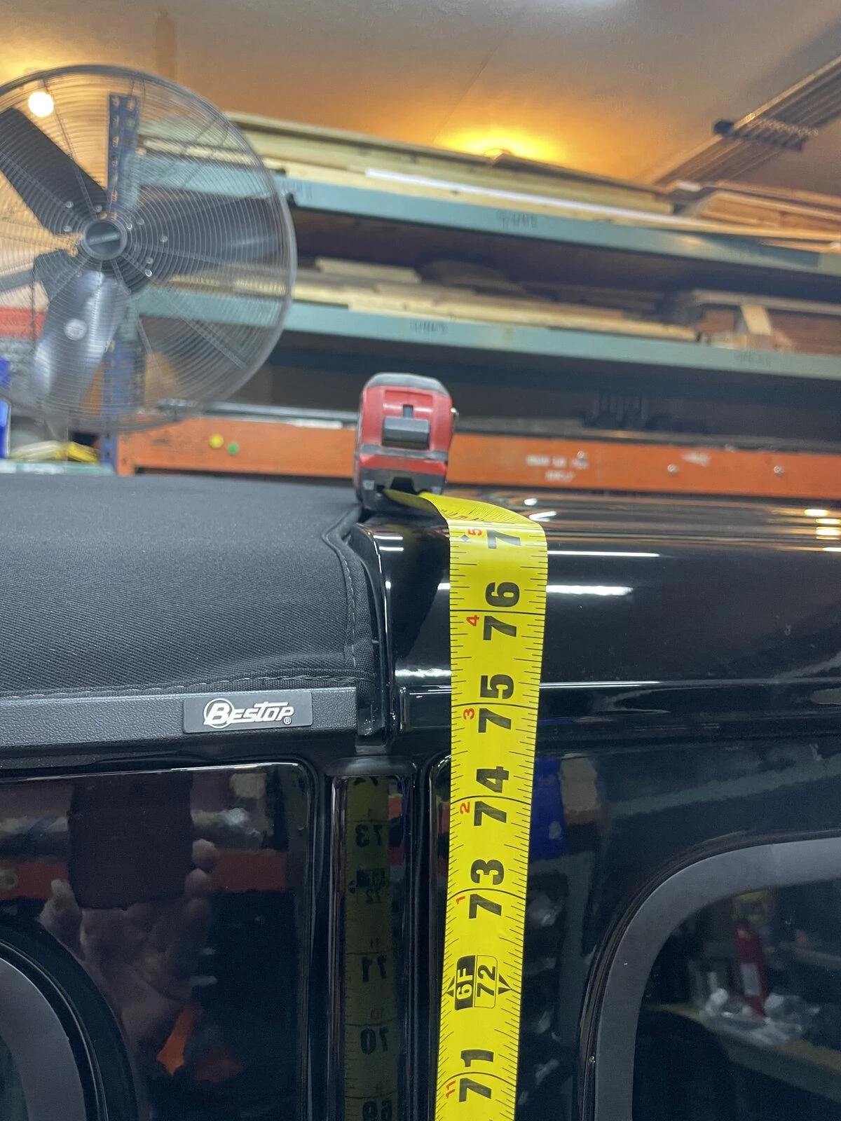

The total height after the lift and 37's comes out right at 77 inches.
Jeep Gladiator Mojave Lift Options Height

Thanks for the measurement. That brings up the first question I had a few threads ago about actual lift or displaced lift. My Mohave is 73 inches tall from ground to top back of the roofline on stock lift and tires That’s a difference of 4 inches below yours. 37 inch tires, while having a diameter of 4 inches larger than the 33’s on my truck, the height increase is only 2 inches at axle. With a 3 1/2 inch lift I would think a Mojave would be 73+2+3 1/2 = 78 1/2 inches. About 1 1/2 inches short of yours. Does this have to do with added weight from suspension items, or any aftermarket items on your truck? Just wondering. Thought you might be curious too as to actual height of a stock Mojave. My only added weight currently that may be different from others is a bed topper and hard top. Some have soft tops.
