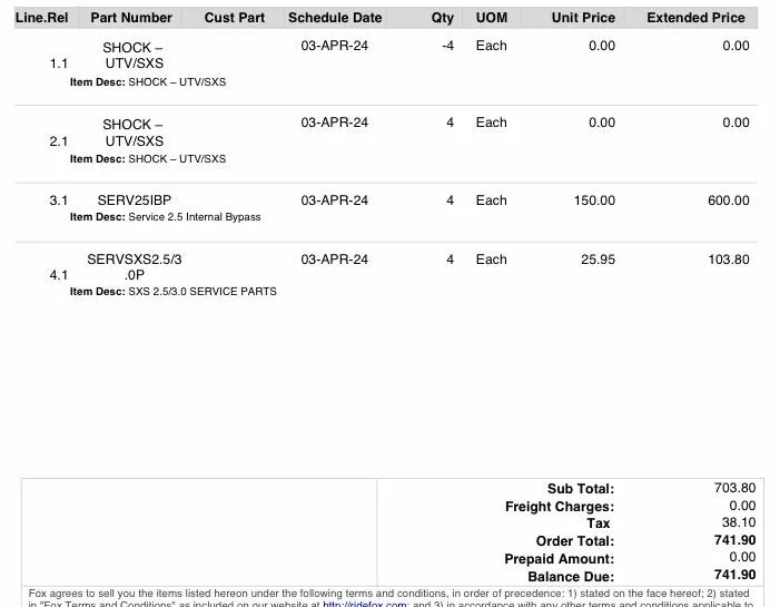

Update: I sent my shocks to Fox this past Thursday. This morning (Thursday) I had this in my email. Looks like it might be 150 labor and 25 parts for each shock. I’m hoping the ride improves $700 worth. ?
