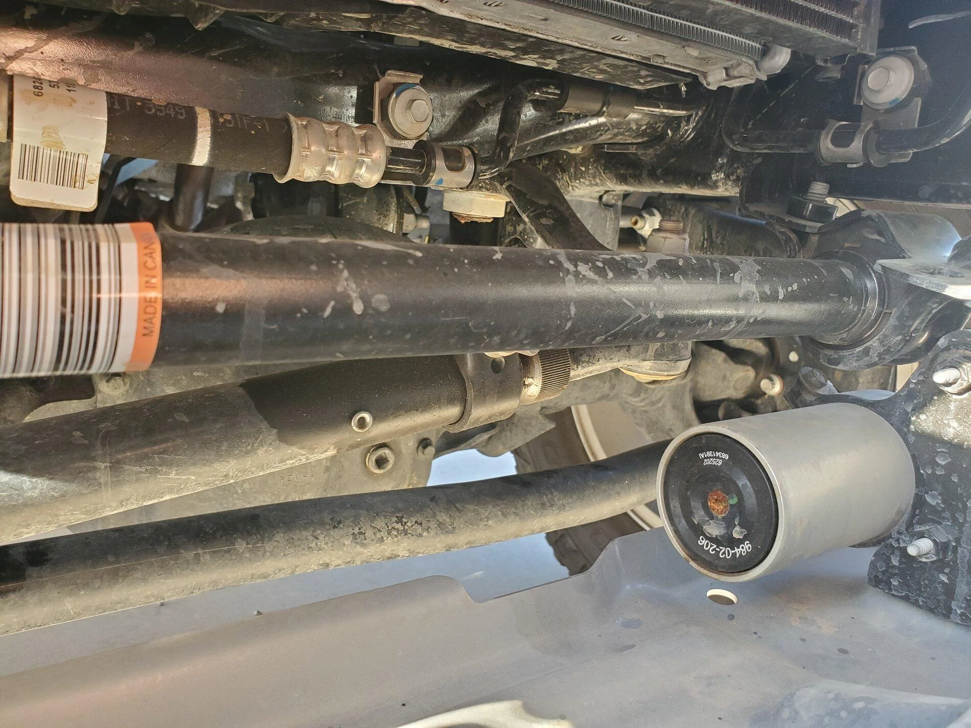

The way it rusted, it was not 304 or 316?stainless, more like plane carbon steel. A dab of paint will solve it but I think if it ever has to be unscrewed or adjusted it would strip right away. I can see Fox replacing whole shock as having the dealer breakdown the setup between Res. and shock and unscrew the rusted part not go well……Jack

They are all gonna be like that...
I suggest cleaning it off with some scotchbrite and painting it if it keeps you up at night

It doesn't keep me up at night. I just know from projects I've worked on that Stellantis has complained about smaller issues. If Fox can't select the proper material to prevent rust then do I really want Fox shocks?
Its more of the principle of it that it should be designed properly with the proper spec'ed material.
I'm taking it in for another issue anyway so might as well get them to look at it. Maybe nobody has complained about it yet so engineers at Stellantis haven't figured out about the issue yet.

It is very likely whoever spec'ed the screw did not specify to re-passivate it. And being that it is in an obscure place, and the mojave just came out, it is possible nobody has seen it yet. And nobody has complained about it yet no warranty claims.

My OCD self would be going nuts over that - I'd likely have pulled that screw and totally refinished it by now. I have pulled screws and bolts out of my other vehicles and refinished them LOL.

Mine rusted a tiny bit but I also use Fluid Film every winter and summer too. Doesnt look terrible on my rig, just slight.

All 4 of mine are rusted as well, just like the picture above. I noticed the fronts the other day, and brushed on some heavy wax type corrosion inhibitor. Haven't done the rears yet.
I'm not a shock expert by any means, but that should be the area where they pressurize the reservoir with nitrogen, right? So, I'm assuming that the screw we are seeing is just a cap that can be replaced and removing it will not release nitrogen.
I'm curious to hear what the dealer says about this. I can't imagine that they are going to want to replace a complete shock because of a rusty screw.

A recall implies there is a safety issue that must be resolved. A surface rusted screw like this isn't a safety issue. It's a purely cosmetic issue. I've seen way worse on brand new vehicles.
We have had to issue recalls for far less than this before.
This is a quality issue, I agree it isn’t a safety issue, but as someone else said, rust migrates once it begins. It’s like cancer, it’ll migrate into the threads and could cause issues down the road. Yea it could be fixed so it doesn’t look bad, but that’s not the point, I shouldn’t have to repaint screws on a 1 month old $70k truck.
When you pay $70k for a brand new truck and get a “premium” suspension, you expect better.
