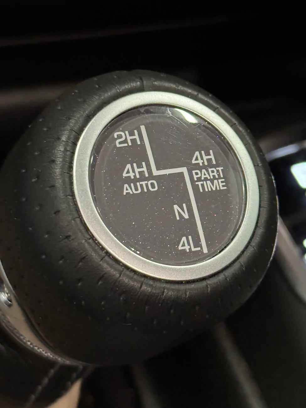

I personally can’t keep track of what they call it….
If you visit your dealership, look at the shifter….. that’ll tell you the story.
Jeep Gladiator Mojave X and Rubicon X IMG_3382

Rock trac just means the 4:1 and stronger T-case of the Rubicon, there is rock trac part time and full time. Everyone else gets the 2.72 t case and select trac or command trac. Just check the shifter as shown above and that will make sure you get it.
Once you have it remember that if you are off roading to use the part time 4h and 4low and not 4auto as the auto is done through clutches and will over heat.
The full time T-case have been known to be weaker than the part time cases since they use clutches, but unless you plan on this basically living off road in 4 low the full time cases are plenty strong and durable
