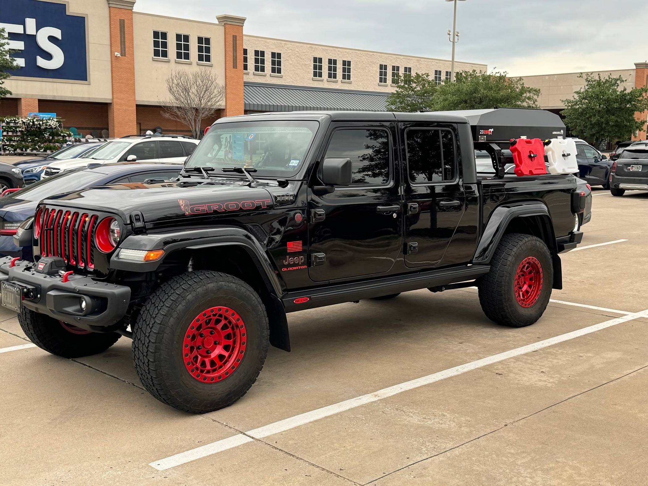

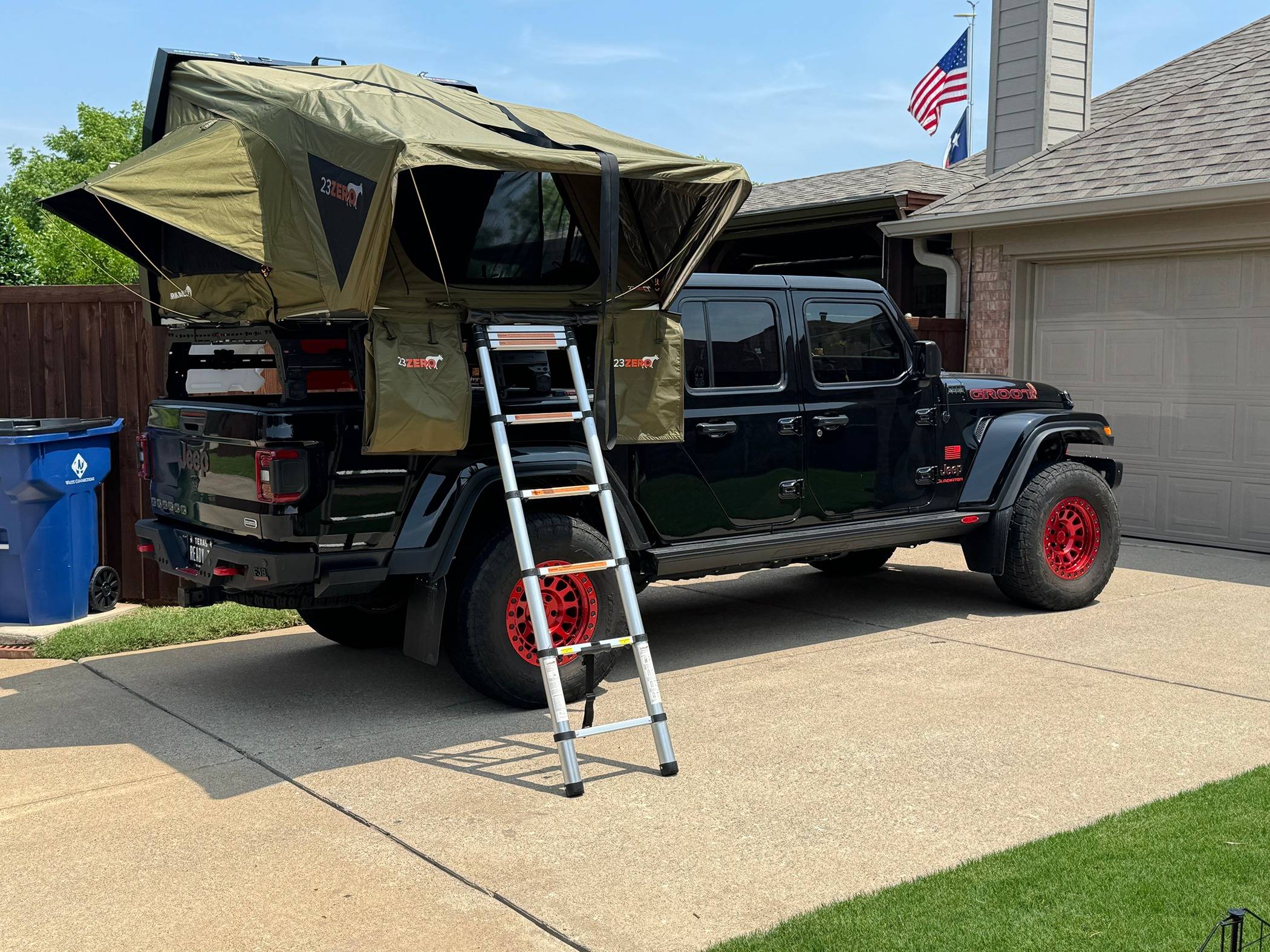

Have a 2020 Overland with a 2 " Mopar lift and 35's. The on and offload driving and handling has been great and I have had no complaints. Just added a Tuwa Pro Rack and a 23 Zero Armadillo-A, adding about another 300 lbs. to the rear axel and a fridge, kitchen, sleeping gear and clothing are coming. Right now it sags slightly, and its noticeable. I don't want it any higher, just level , get the firm ride back and capable of more weight. Was wondering if the 2" Mopar lift rear springs for the diesel would work, (If they are available separately) or any other suggestions.
Jeep Gladiator Mopar 2"  lift spring upgrade after overlanding setup IMG_0768[1].JPG
Jeep Gladiator Mopar 2"  lift spring upgrade after overlanding setup IMG_0763[1].JPG

Thanks', I will check them out. Work in Progress. I now may need to get a shorter Rack. Wont fit in the garage by 1 inch. , and after bringing the rear up, it probably will be 2-3 inches to high.

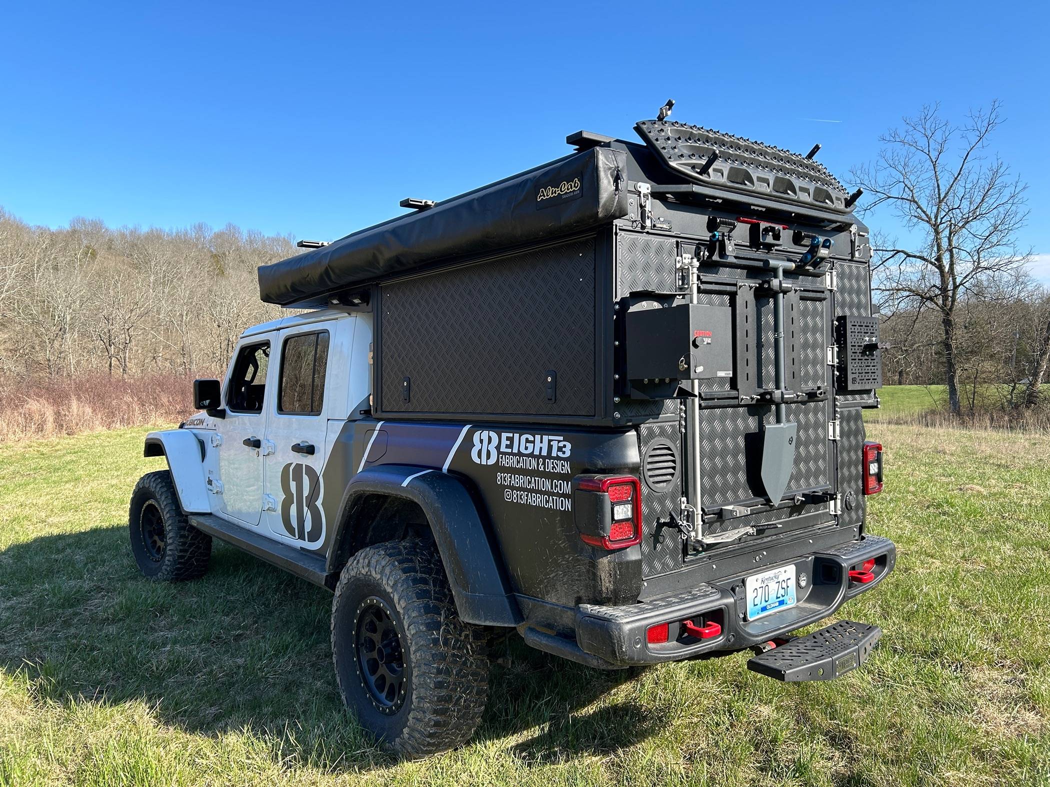

I started with a Mopar 2” so there are still some of the components there. I swapped to Dobinson HD springs. 3” in front 2” in back and it sits perfect. I also now have Fox 2.5 shocks so not sure if the springs work with stock shocks.
Jeep Gladiator Mopar 2"  lift spring upgrade after overlanding setup IMG_4337
