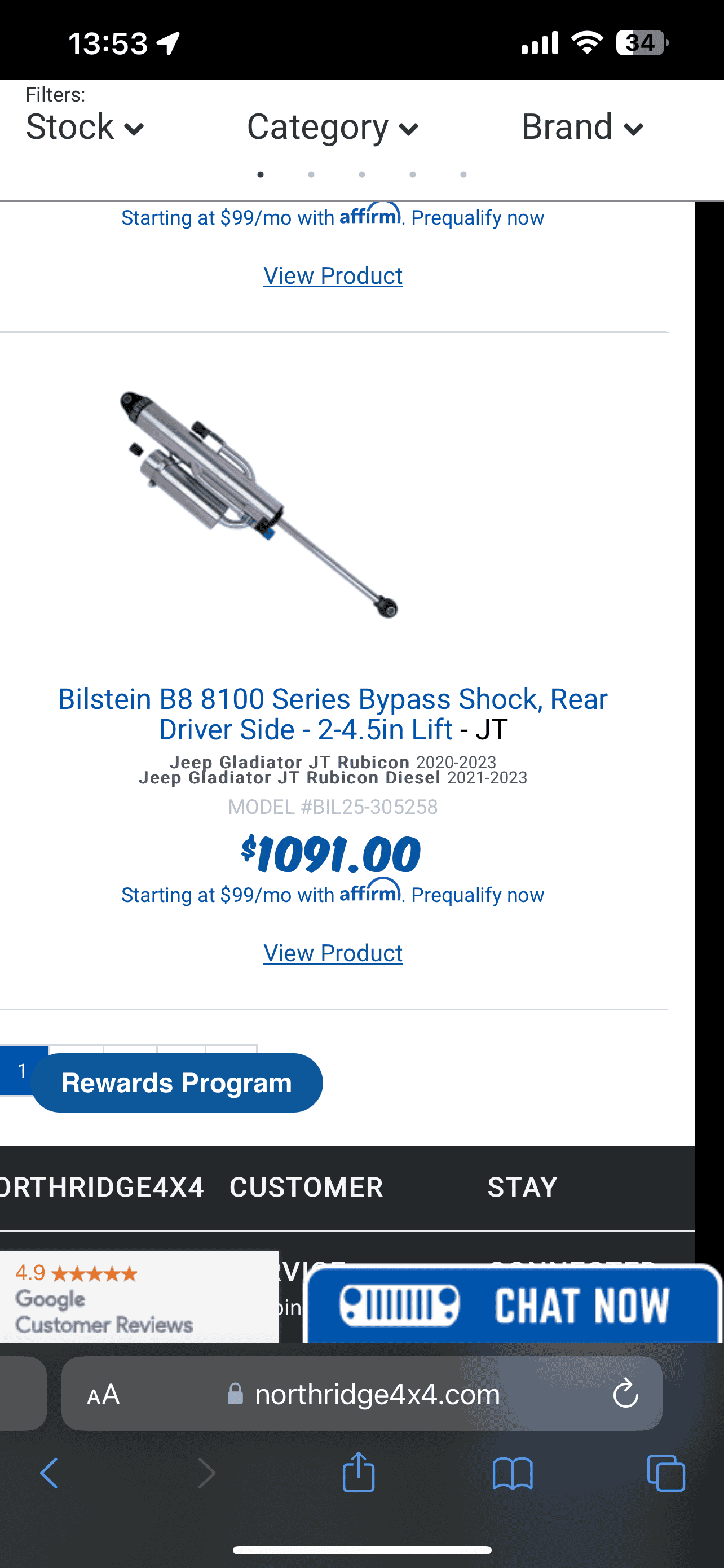

Since you already have the shocks, getting the upgraded bilsteins probably is not a good choice but they are a lot more than just remote reservoir shocks. I would be concerned about the fox shocks with the HD springs though as those shocks are designed with factory spring rates in mind and are linear whereas the AEV bilsteins are digressive. It might be worth calling, say Northridge. I know from experience Fox just wont be willing to talk about it and AEV kinda keeps their tuning wrapped pretty tight as well.

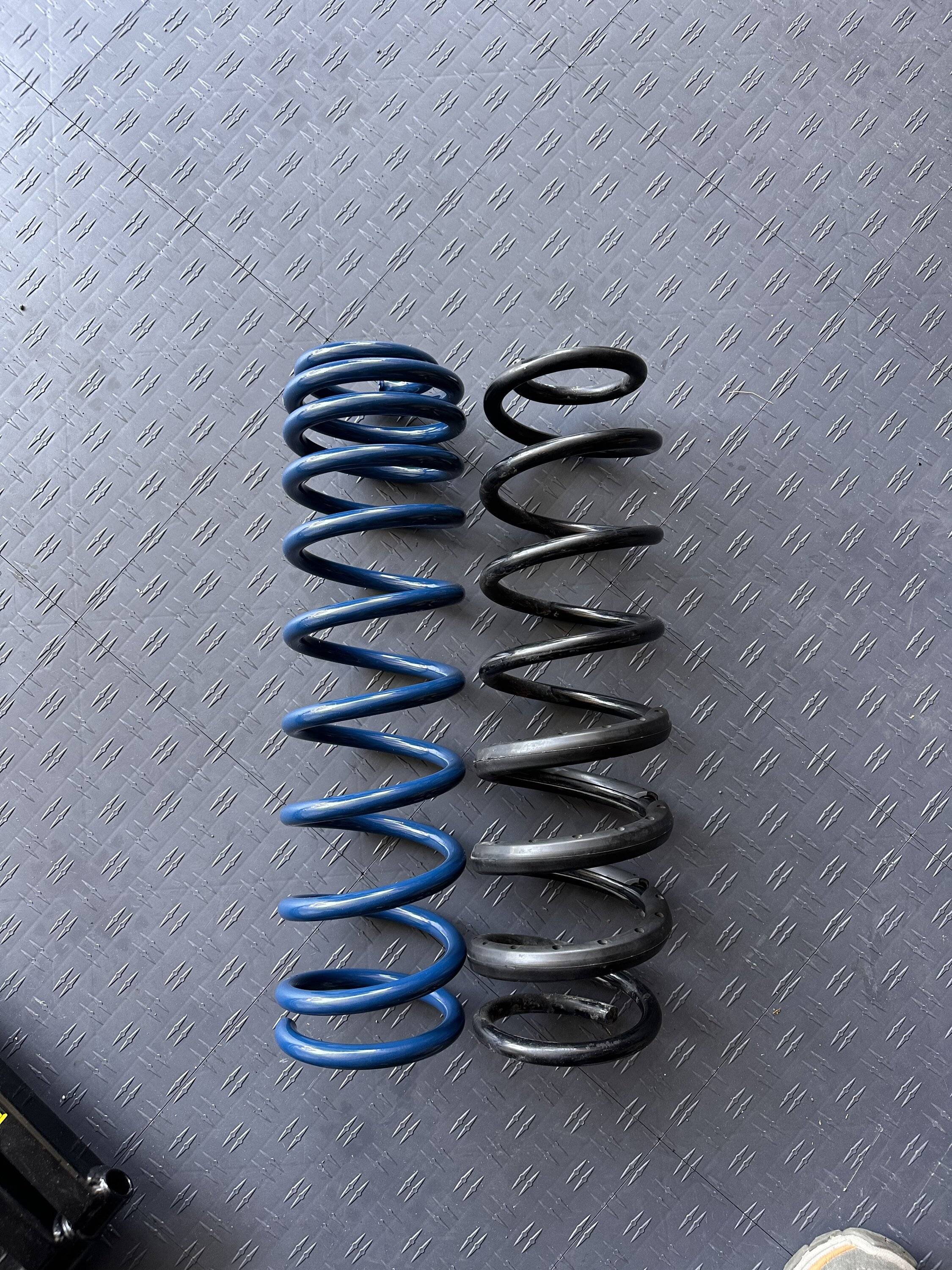

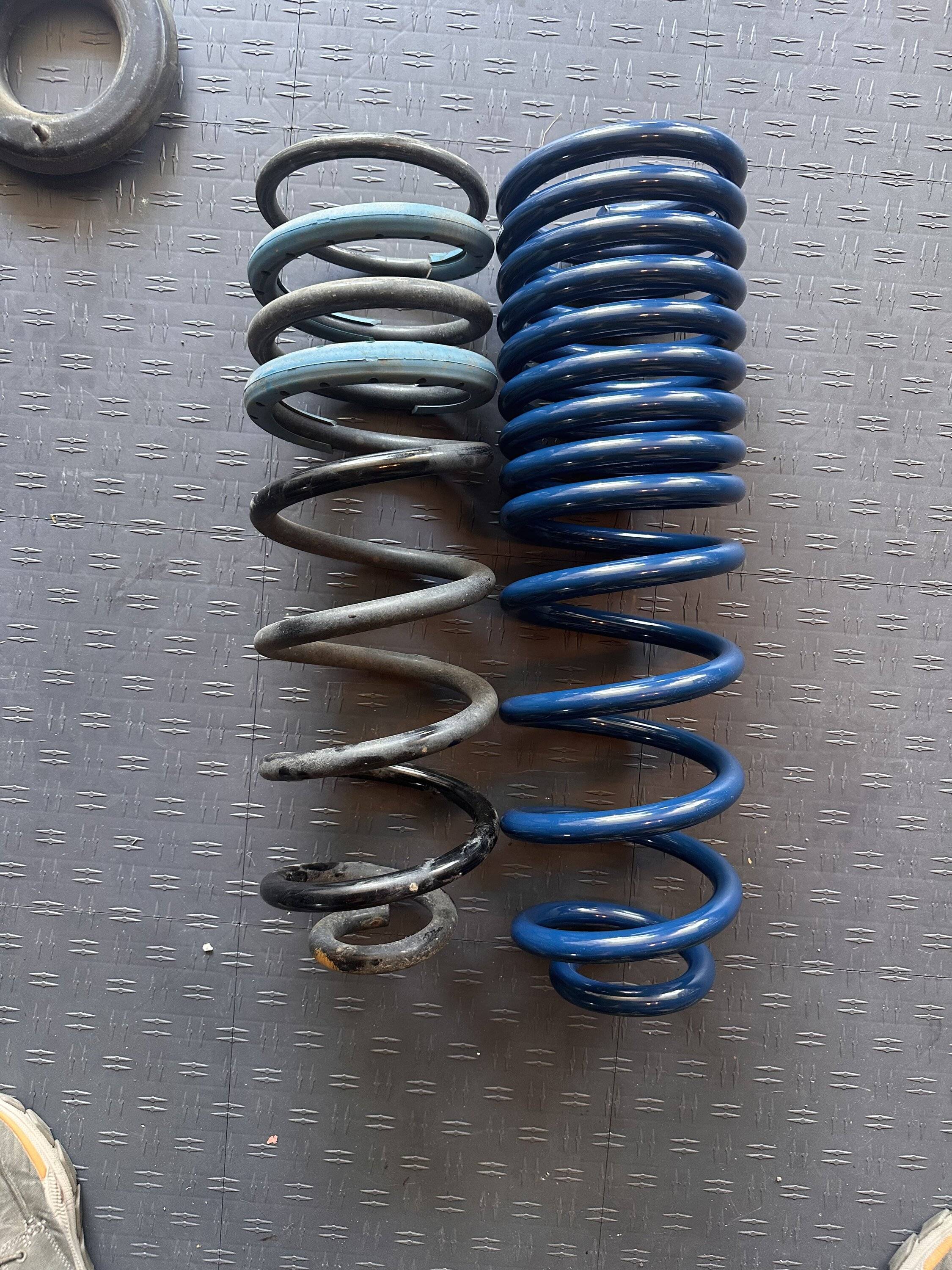

Took pictures of the front and rear. Length is very similar, but the dual rate is obviously the big difference.
Wire size or diameter (I've got some springs that have different wire sizes depending on where you measure) number of oils, distance between coils, it's not length and coils alone.
Rate is the number of pounds necessary to compress a spring 1".
Lower spring rates will provide you with a softer feel, but you get more grip.
When going over a bump or curb, softer springs will maintain contact with the road better than stiffer springs.
If springs are too stiff, ride quality will suffer, and your tires won’t be able to do their job correctly on bumpy and uneven roads.
Here's a great example/explanation of a constant rate spring -
Spring rate refers to the amount of weight that is needed to compress a spring one inch. If the rate of the spring is linear, its rate is not affected by the load that is put on the spring. For example, say you have a 200 lb. per inch spring - it will compress 1” when a 200 lb. load is placed onto the spring. If another 200 lbs. is put onto the spring, the spring will compress another inch. At this point the load on the spring is 400 lbs. The rate of the spring, however, remains constant at 200 lbs. per inch.
