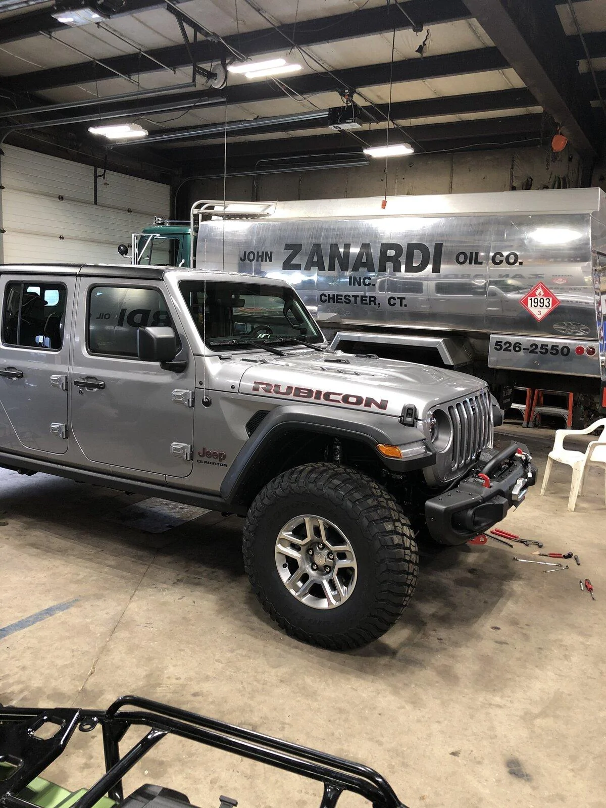

installed my lift today, diesel rubicon, im happy with the levelness of it, im in ct and selling my stock suspension, and m?t tires with the upgraded wheels
This is the diesel specific mopar lift? If it is it looks to keep the same rake as the gas lift. Do you have a winch In this picture?

yes, wood crate, diesel specific, mopar lift for gladiator
that picture isn't level either, i can measure tomorrow

And what size tires are you running?

looks good! How is the gearing with the 37’s.
awesome, i was surprised the torque is right on, this thing was made for 37 and this lift,
when you put it on you'll see little things they did, like
slack in the wires/hoses
bumpstops all drilled just bolt them in, it looks drives and feels like it was made this way
Great to hear this, my friend. My dealer called this morning to say the crate has arrived! My JTRD gets its Mopar pick-me-up next week. I’m running 35” BFG KO2s. Hope they don’t end up looking too small.
