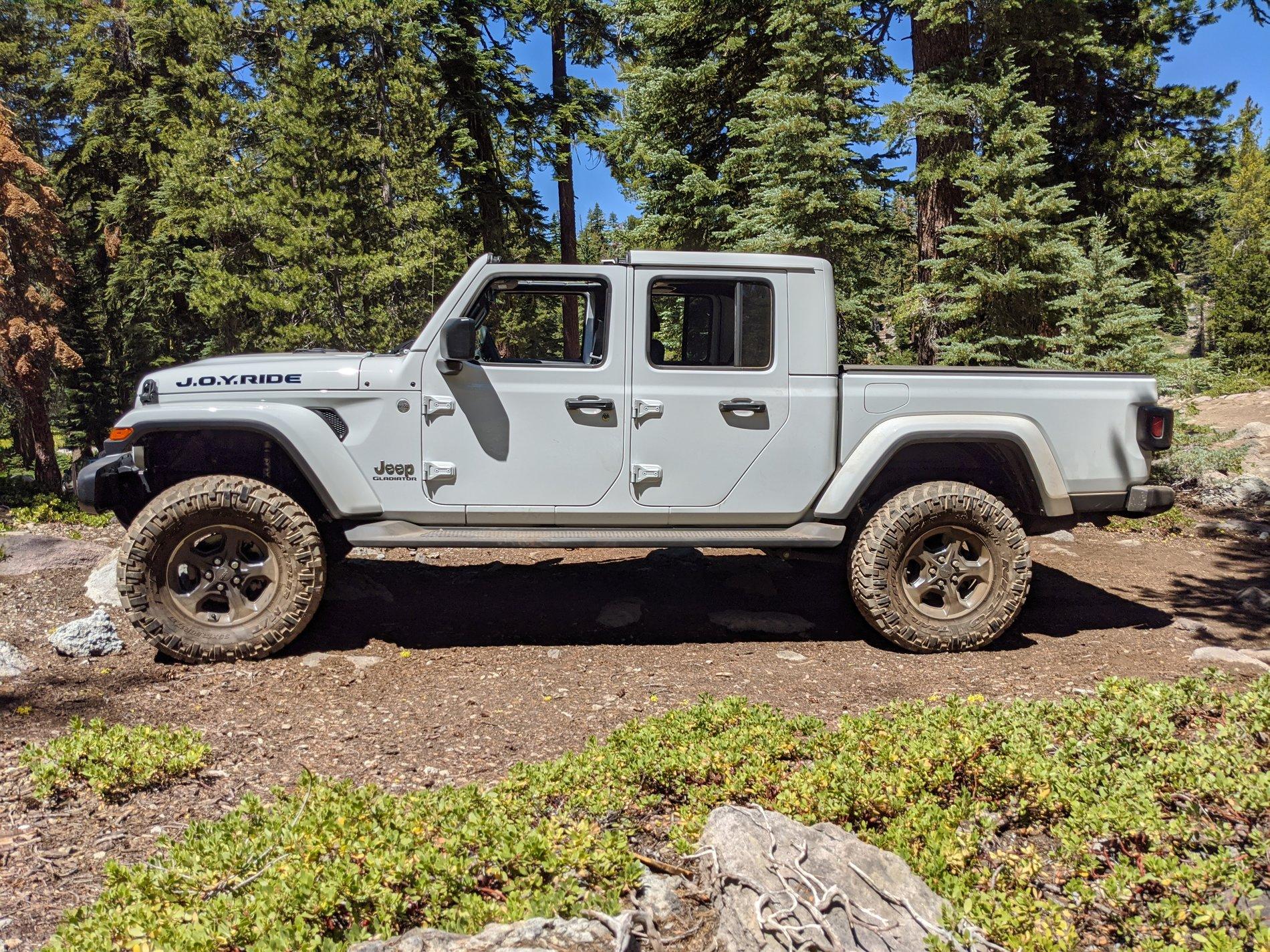

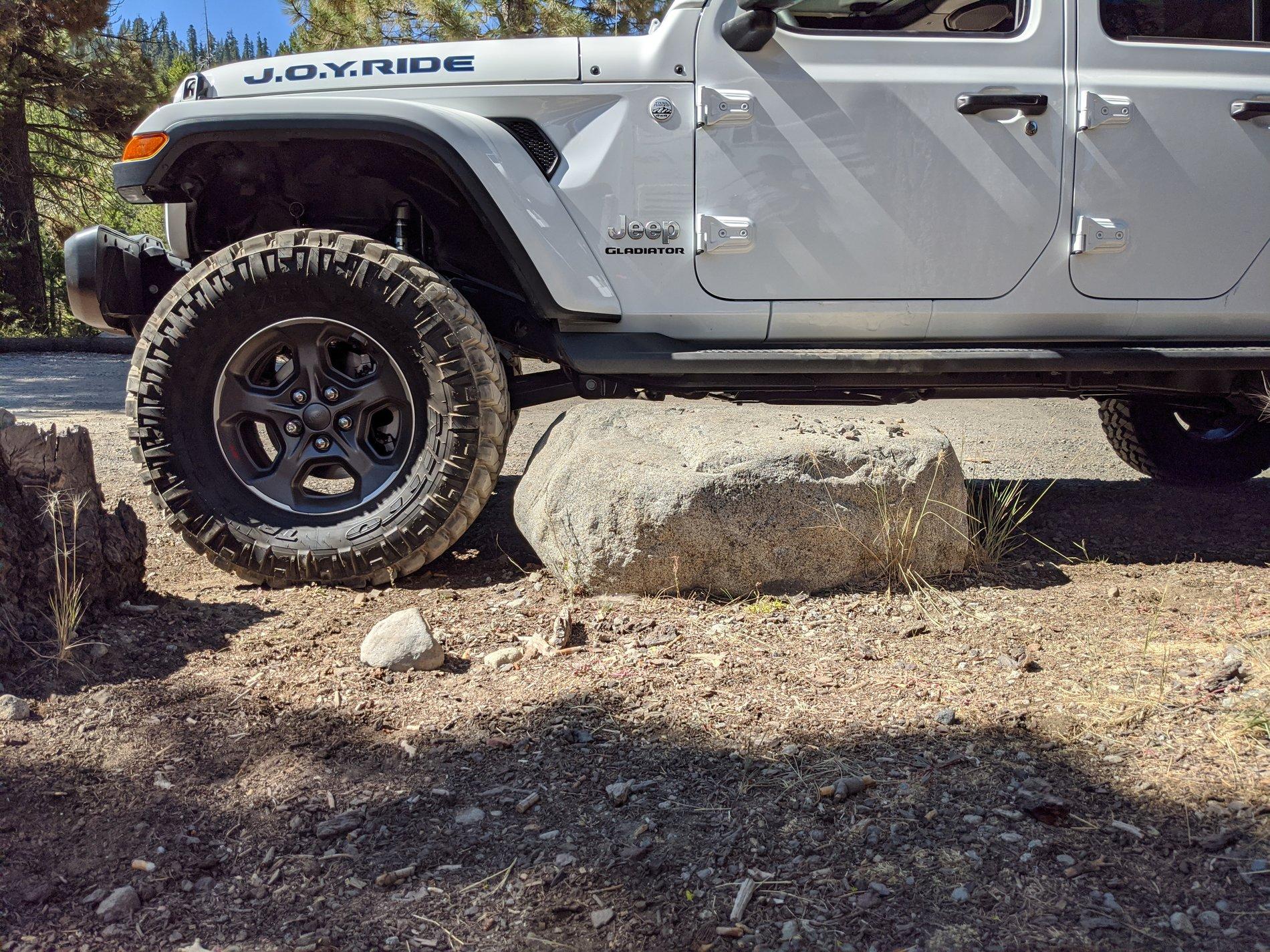

A forum member just sent me a picture of his truck, a Sport/Overland model with factory fenders, our 2.5" springs and 35's. The Jeep is on an upward hill so it looks like the rear is sitting a little bit lol but I figured it was a good example of the way 35's look with these kits! I don't have any photos of our 3.5" with 35's, as this would definitely be a combination that would make the wheels look a bit small.
Jeep Gladiator Mopar lift with extras? IMG_20200804_123236
Jeep Gladiator Mopar lift with extras? IMG_20200804_124912

Yeah those pics were on a slant so it looks kinda like a squat

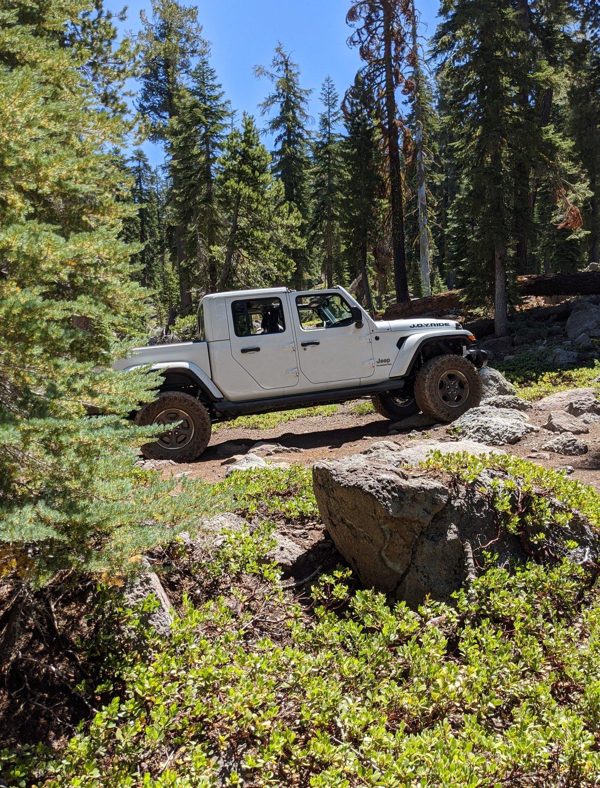

The Clayton 2.5" kit with 35s at Rubicon staging area.
Jeep Gladiator Mopar lift with extras? IMG_20200803_100337

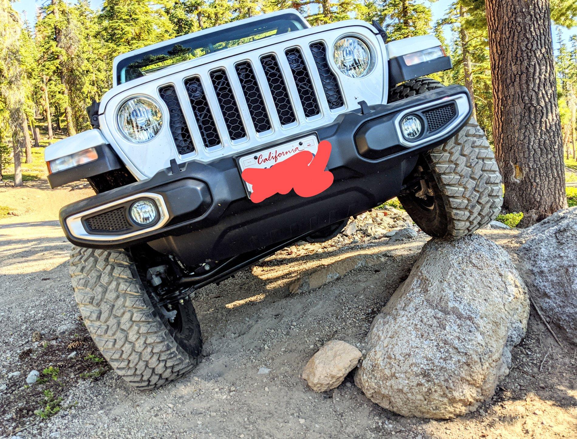

It fits a very good sized rock under the rails too.
I couldn't find any good rocks around to fully flex, still had room to go but ran out of rock lol. Also the back right was one the same ramp.
Jeep Gladiator Mopar lift with extras? IMG_20200804_163858~2
