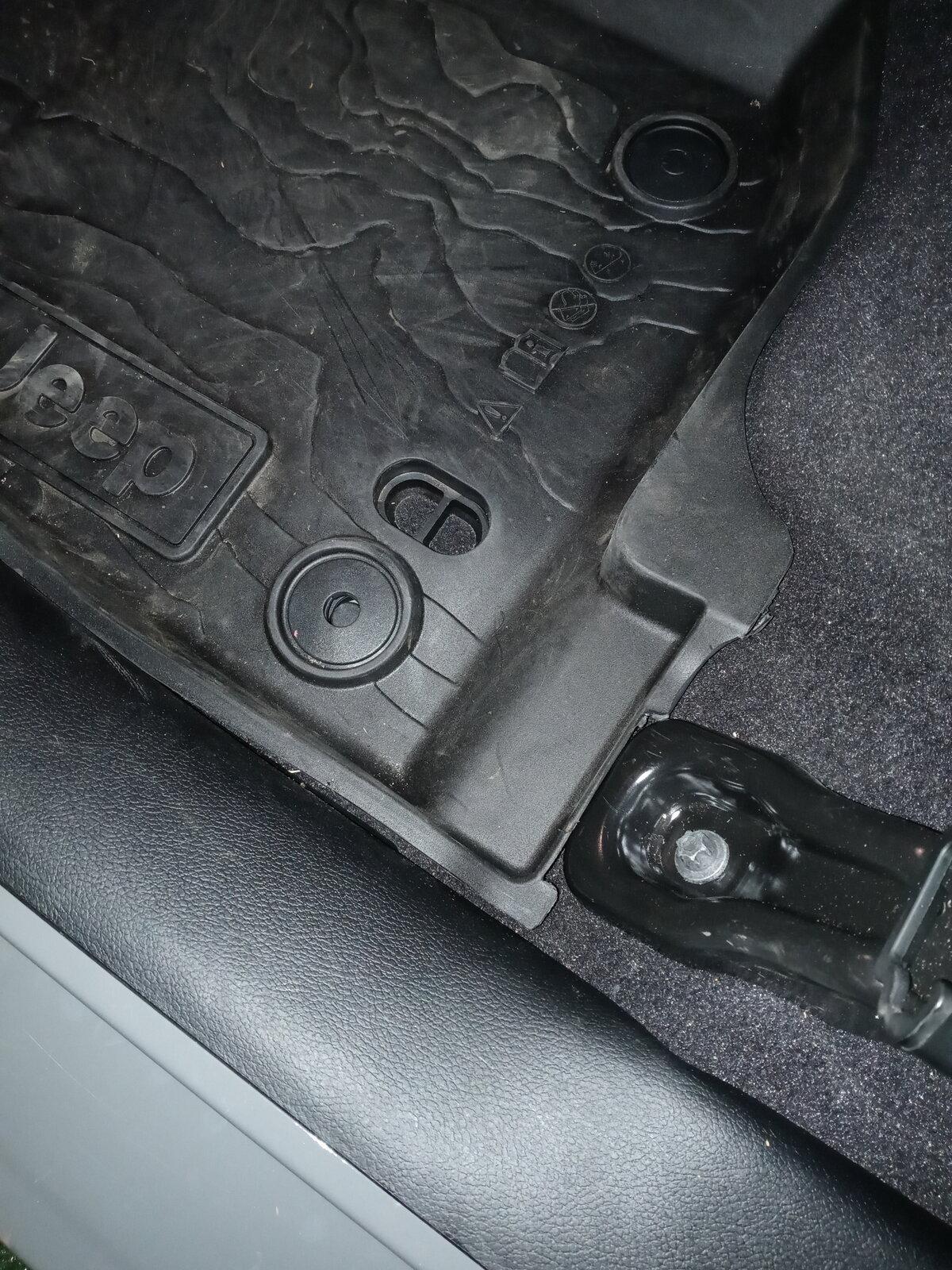

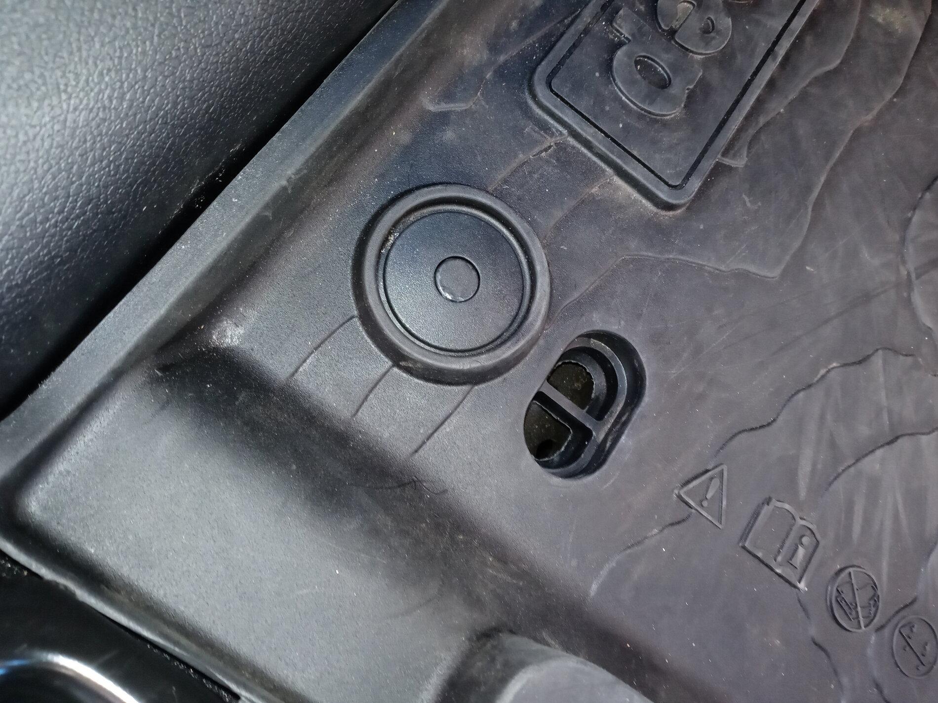

I seem to have an issue with the front driver's side mat remaining fastened on the left side.
The raised portion to the right of the fastener is causing it to continually pop off.
It appears that the raised "vent" is too tall, not allowing it to remain fastened.
Anyone else with Mopar slush mats encounter the same issue?

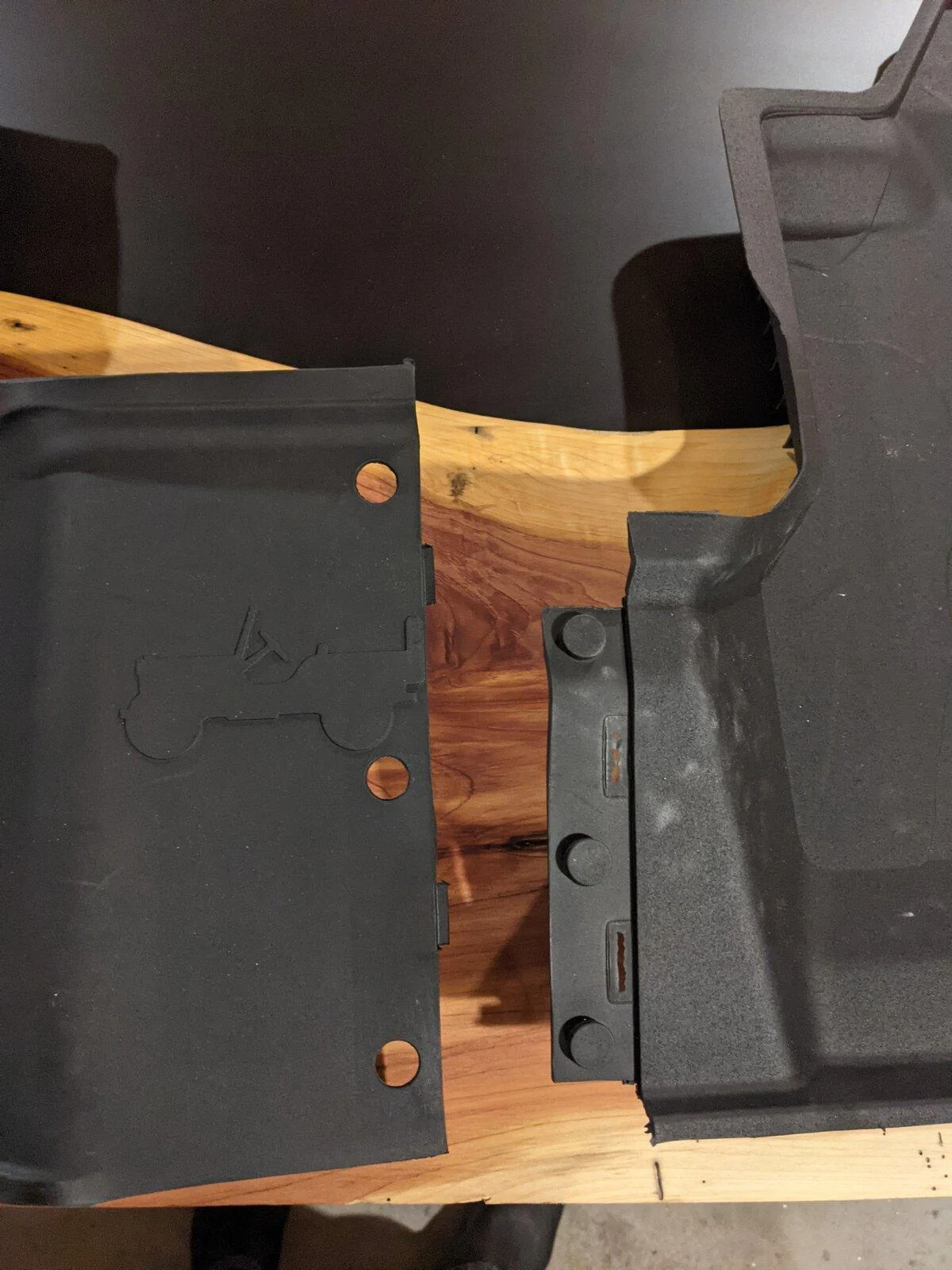

Driver's rear slush mat...
Has relieved areas (cutouts) to accept things that aren't there, snap in holes do not align (waaay off) and has only 2 holes in it for 3 snap pins.
Dealer ordered a new one.
It doesn't have the red Jeep on any of the mats either but does have a Willy's style WWII Jeep on the affected mat.
You have to cut the little carpet pieces out...save them in case you decide to get different mats like I did...take out the rubber plug then put the plug into the mats themselves. Voila! The mats are installed properly now. Why this isn't done at the factory or the dealership I will never know.
Mine as well- I think you need to cut out the drain hole in the carpet as it is like a gutter and keeps the mat pushed up because there is no relieved spot in the carpet (drain hole).

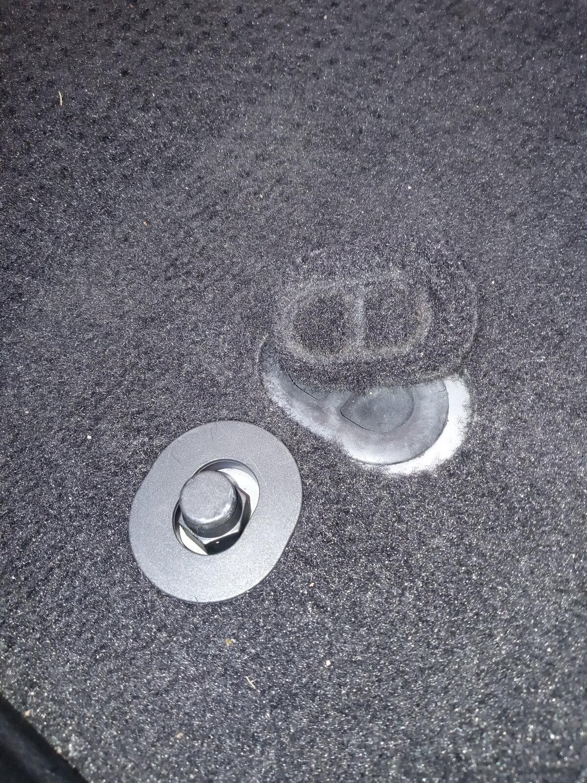

Ok, I finally figured out exactly what you were referring to...
Luckily, the factory had already precut those two spots, so I just had to pop them out and then remove the rubber plug from the floorboard.

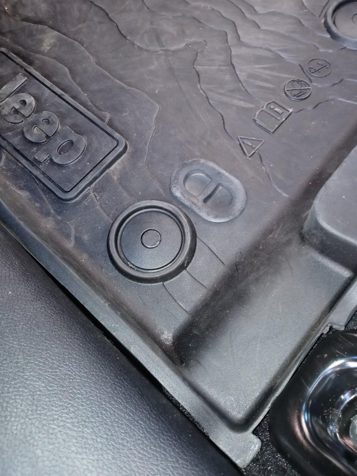

The mat was able to snap down and plug the hole, so everything fit much better.

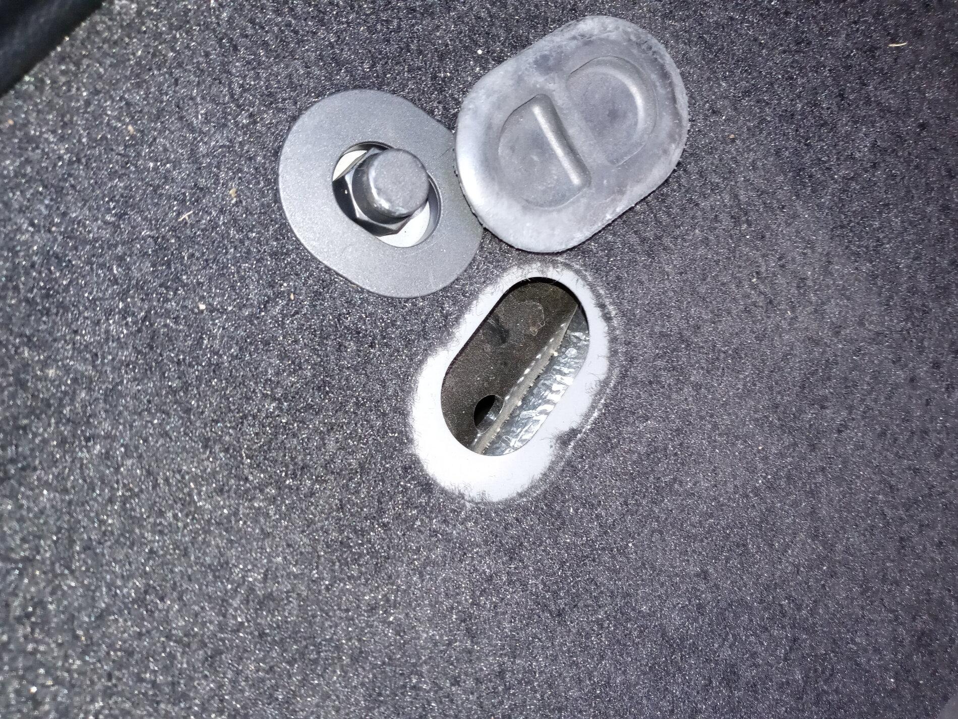

Then I plugged the opening with the rubber plug pulled from the floorboard.
