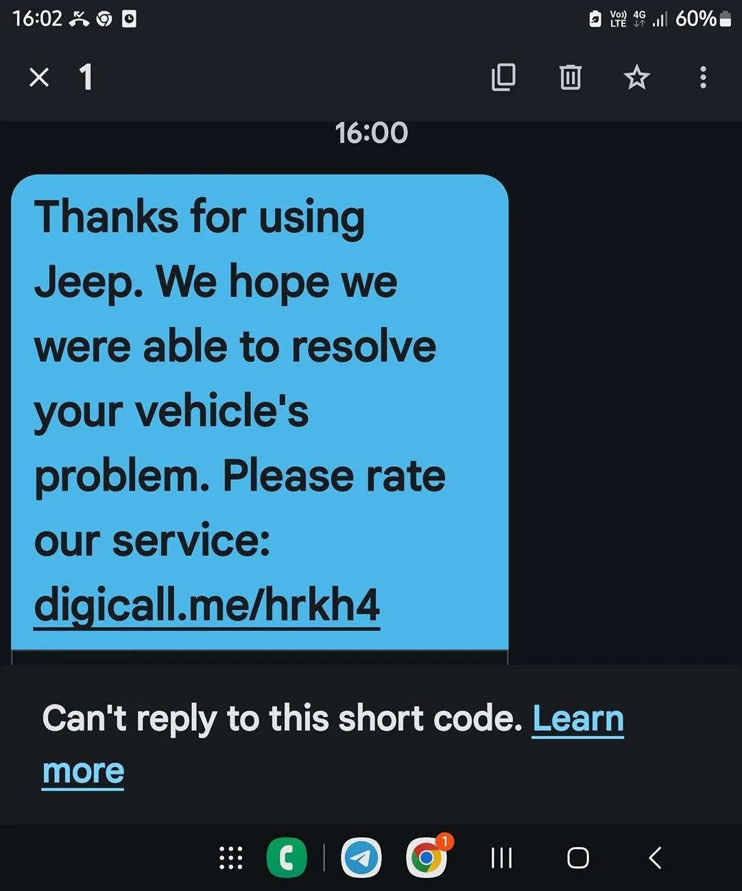

"if i did something, please explain how it is that the road side assist photographed an empty reservoir?"
