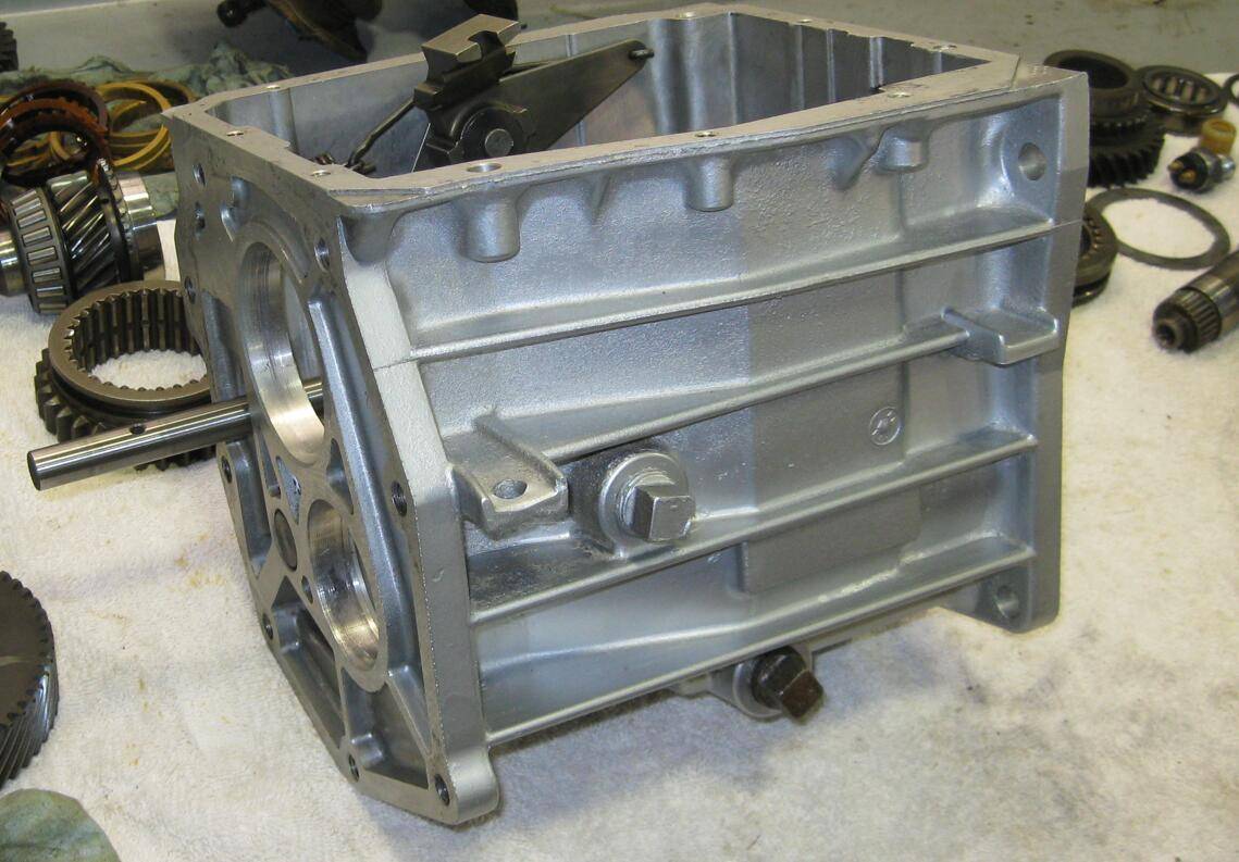

I am not used ro the idea that mechanics dont clean parts anymore. Is that how things really are these days? My dad was a mechanic...he would never have accepted that kind of nonsense with engine rebuilds/swaps.
In the end, when taking all of this in, yeah, you've been jacked around for sure, and the service there stinks (could use a much stronger word, of course)
My father wasn't a mechanic himself but did work in a factory for years. He made his way up to inspector, line inspector, and chief inspector - so picky that a major company they made things for came in for their usual checking things out, inspecting things in the factory, and went to the higher-ups and said "we'll sign the next contract, but this guy has to be the inspector for the products you make for us".
Of course that didn't make a few others happy in that plant, on the other hand, he was elected UAW local president for a while, and the company loved him.
I can't stand putting things together dirty. That goes for anything from restorations to "just fix it and make it work" jobs. Clean matters, especially on modern equipment - tight tolerances and so on. Even years ago, you could end up wiping out pilot bearings and bushings on a manual transmission if the face of the bell housing wasn't clean and the mounting surface on the back of the block wasn't clean.
The outside of the T5 I rebuilt for my car was as clean as the inside, all parts were checked again for cleanliness before going back in even though I had thoroughly cleaned things up.
For automatics, I use a refinishers' "tack cloth" on parts before they go back in to make sure there's not even a trace of lint or dust.

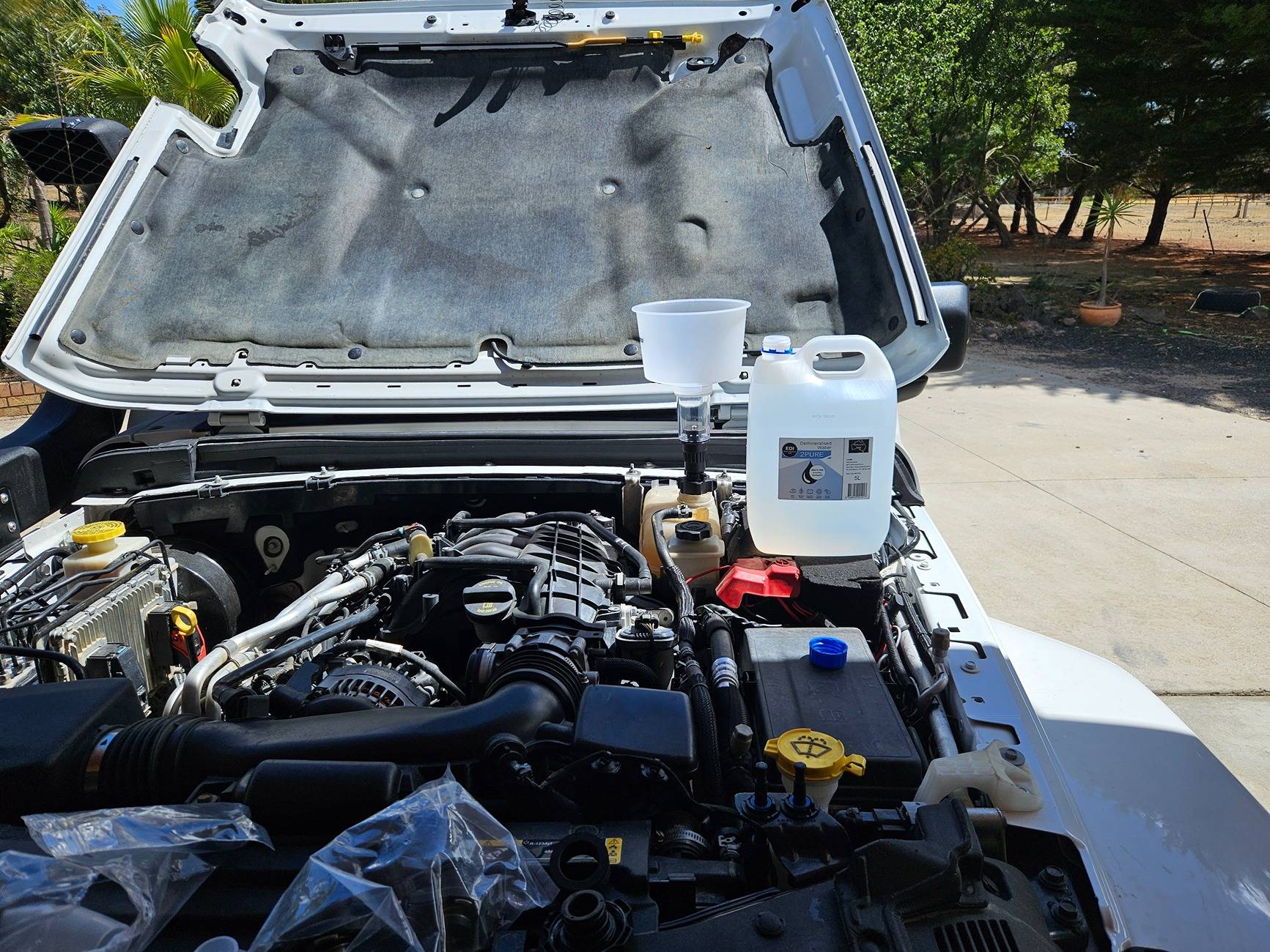

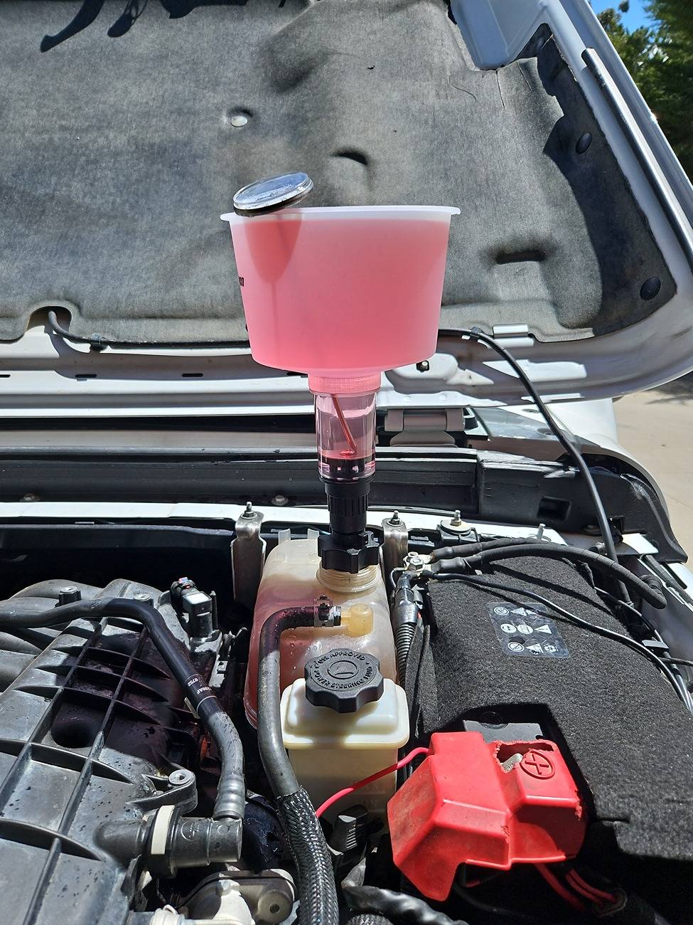

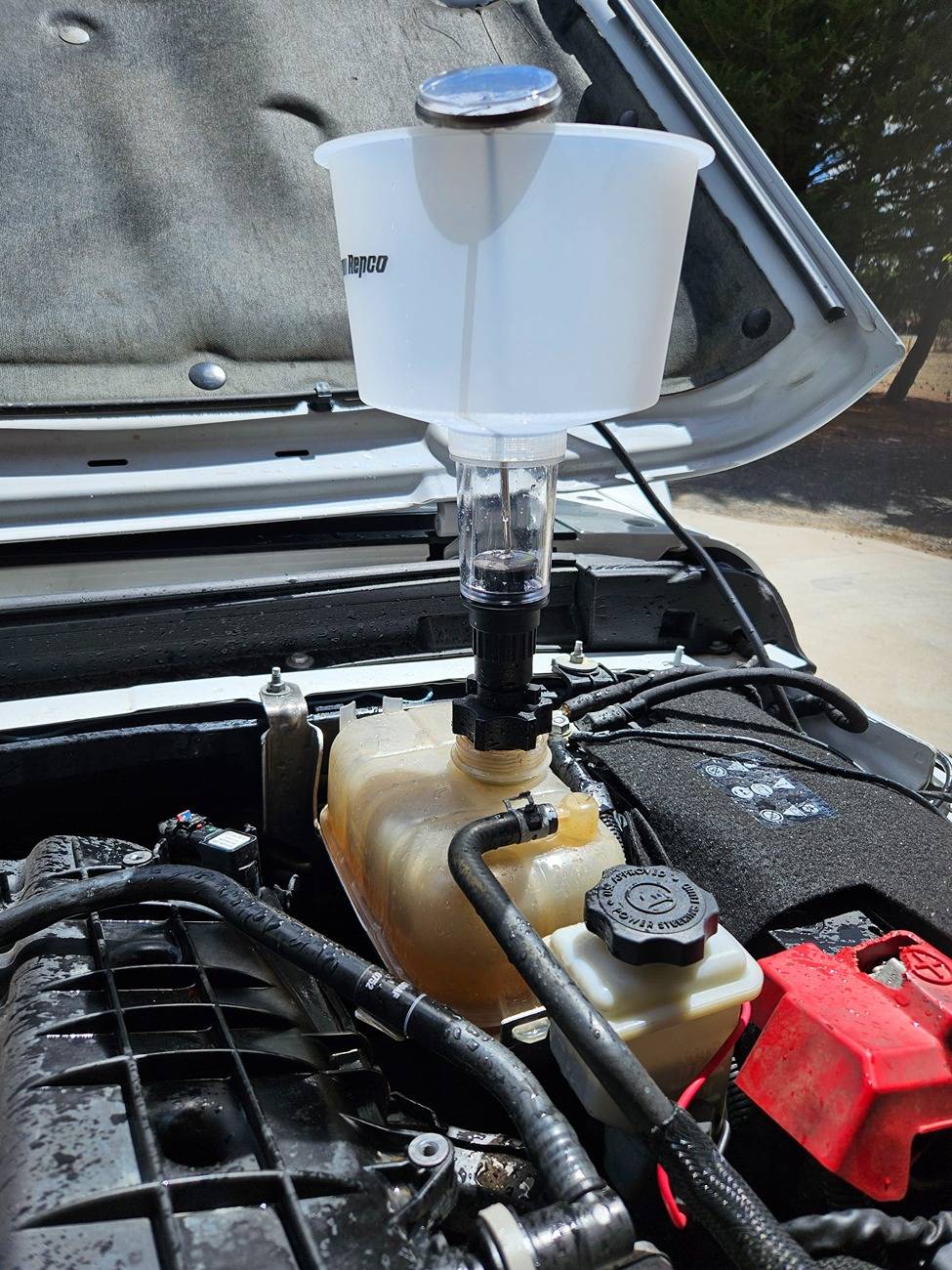

I’d say as soon as you get it back, you’re ready for your project. 🍿
well as expected...road side assist weren't much help...but that wasn't the point of getting them really, i just wanted it documented on Jeeps database that a mechanic has looked at the car and photographed that its cooling system reservoir is clearly empty.
Road side assist got out of their car and pulled out a battery tester. I said, "you wont be needing that"
he said "why not"
I said "the car has just had a new battery put in it with and the issue is, the engine overheated ...that was why i called for road side assist in the first place"
He said " they didn't tell me that"
Anyway, I'm not upset, i didn't expect any more than the above and I'm happy enough that at least its recorded with a photo now on Jeeps database that the car is low on water.
Sooooo....
Adam then got to work
1. decided to not drain the system...just put more demineralisted waster into the system...it took about 2.5 litres and obviously some of that is up in the funnel.
2. started the engine up and began hand pumping any soft hose i could find in the engine bay noting whether or not pumping said hose caused bubbles to flow back up through the funnel. Spent about half an hour pumping various hoses and bleeding air.
3. Once thermostat had opened and engine was up to operating temp, it began to purge bubbles through the funnel without me pumping hoses...i continued this for about another 30 minutes (maybe longer) whilst monitoring the funnel coolant temp with a thermometer.
Caveat...a thermometer in the funnel isn't particularly accurate...the funnel has a rather large surface area and seems to cool the water inside it quite quickly...touching the reservoir felt quite a bit hotter to the hand than what the funnel did. Funnel temp sat around 50 degrees celsius.
Observations
1. The water seemed to regularly surge back up into the funnel then drop again in repeating cycles of perhaps a couple of minutes apart at most...using almost the entire funnel capacity each time. I don't really understand that???

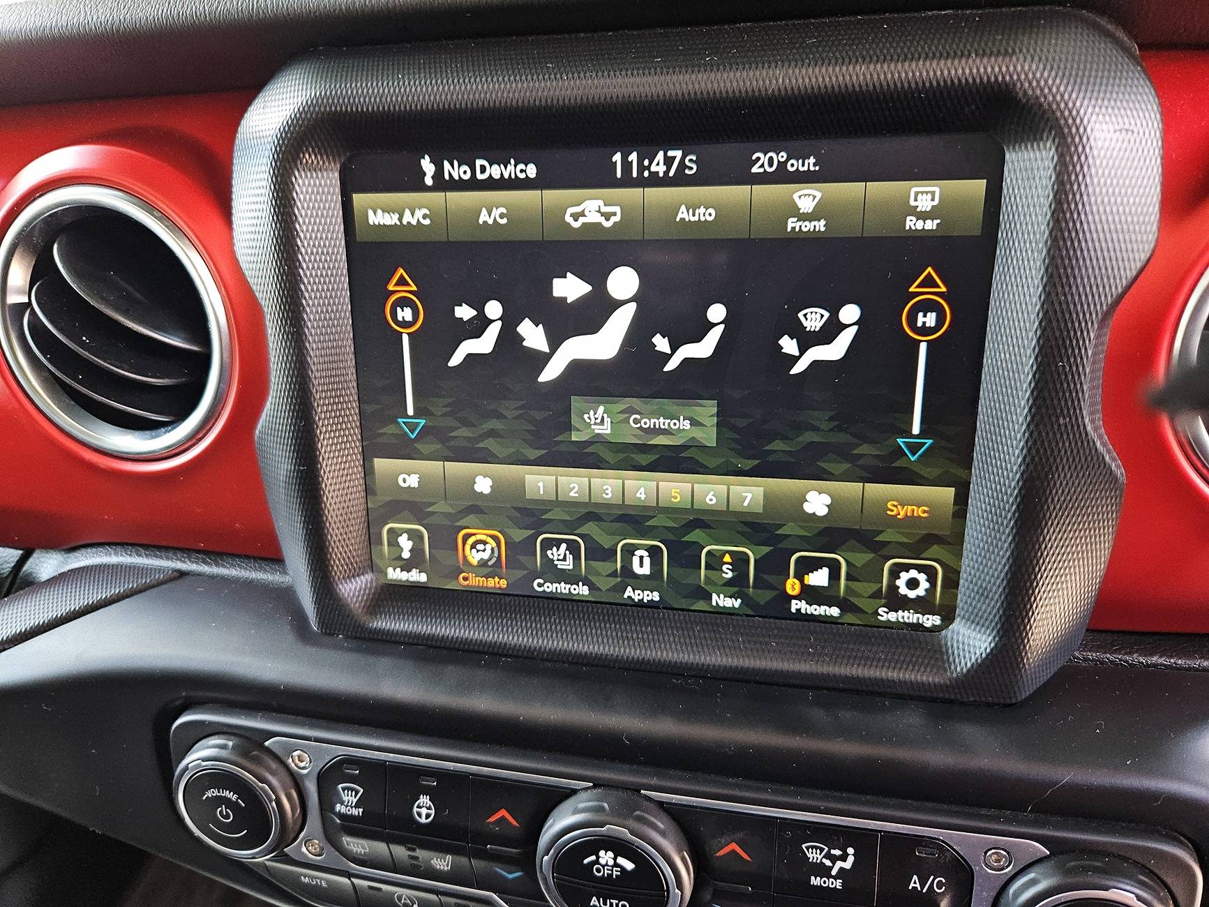

2. I had the heat on inside the cab the entire time...its only blowing cold air no matter what i do to the climate control settings
3. Three of the solid lines that i think feed back into the cab...two of them eventually got very hot to the touch, however the third one remained at ambient air temperature.
4. just prior to engine shutdown, coolant level was at the top of the funnel. After shutdown, the entire contents of the funnel and a considerable amount of reservoir volume were sucked back down into the engine cooling system!
Becasue the cabin heat is blowing cold air after over an hour of engine running at idle...
thermo fans was turning over at very slow speed so engine was definitely at operating temp...
I'm now suspicious that the heat exchanger inside the cab may be blocked??
Thinking back to the previous engine failure at Berrima NSW...it was a sudden sky rocket of temp...i wonder if it the previous engine is responsible for the trouble the dealership had trying to purge the air out of the system after installing this engine and, that the heater not working is a result of contamination of the heat exchanger galleries from the old engine failure...and that is the reason for my current predicament?
(photos are mostly in reverse order but you get the gist of it)
First photo is level just prior to engine shutdown
Second photo is level just after engine shutdown

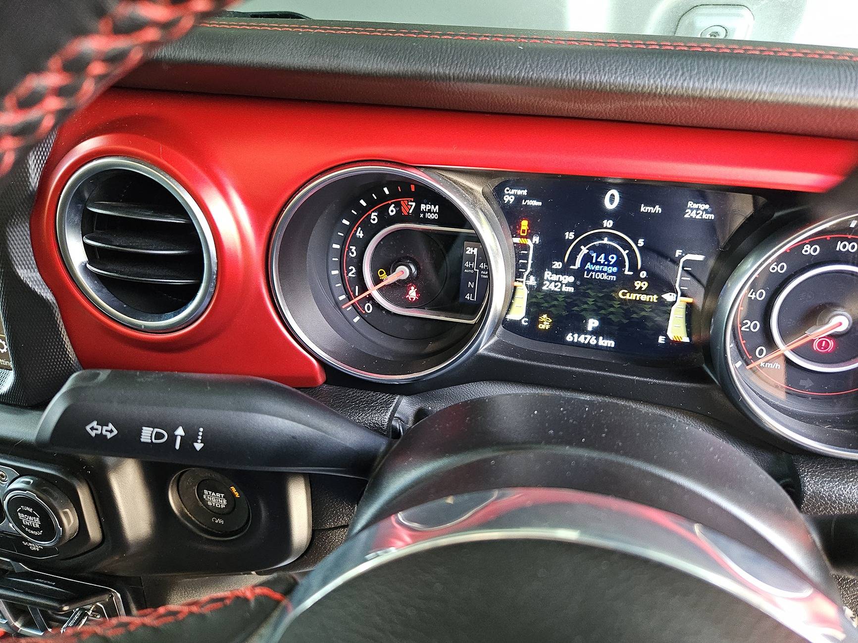

photo 3 is temperature setting on climate control
photo 4 is the bottle of demineralised water , i put in 2.5ltr out of a 5 litre bottle
last photo is cars own temp gauge and rpm settings just prior to shutdown

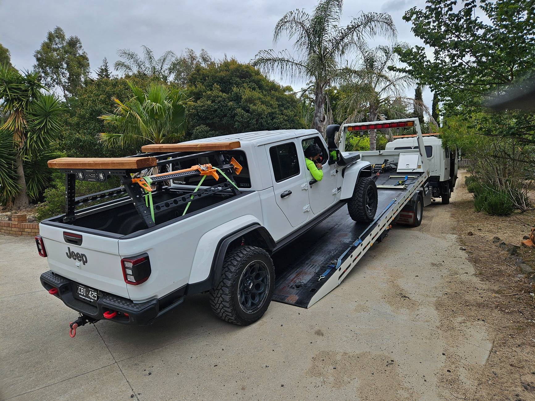

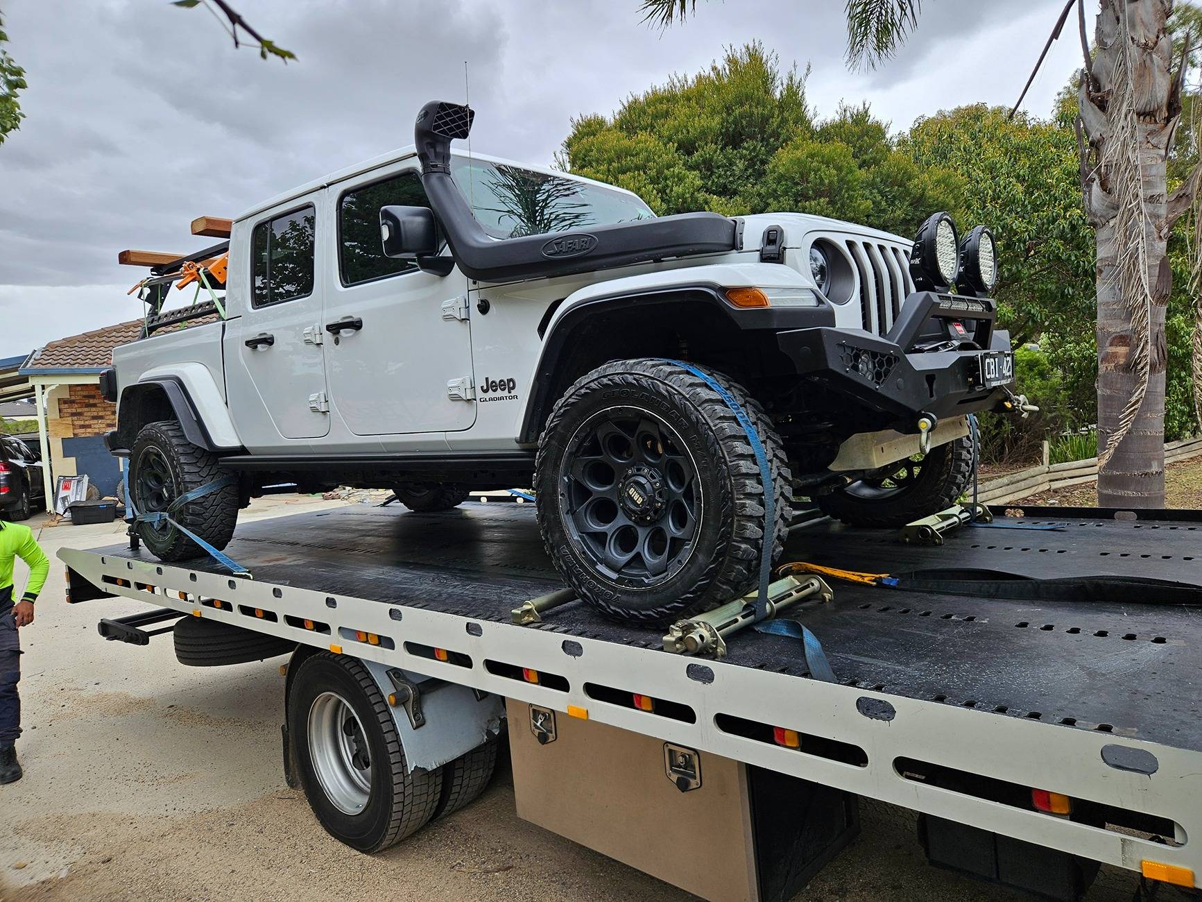

Update...i tried but failed. As soon as i attempted to drive the car after purging cooling system, the car began to overheat...i didn't even get 300m from our house or above 30km/hr.
Whats ironic about this...i did a little survey...
27th December 2024
Local Jeep dealership = 3 jeeps delivered on tow trucks
Local Toyota dealership = 0 cars delivered with breakdowns
28th December 2024
Local Jeep dealership = 2 cars delivered on the same tow truck that has just also loaded mine (so another 3 cars today)
In 2 days 6 Jeeps have gone to local dealership on tow trucks!

Once again, I'm watching my pride and joy disappear into the distance on the back of a tow truck (this is the 5th time in just over 12 months and since 36,000km...car now has 60,000km on the clock)

I decided not to fully flush the system. I just topped it up (didnt want to introduce too many variables at once)
The thermostat and pump are both brand new. They were swapped out with the engine change.
I could also see water movment after the first purge session and i did thst hose temp comparison ive seen on youtube for checking the thermostat has opened...it was definately working during first purge with the radiator reservoir cap off and just using no pressure in the system and a funnel.
However, i shut down,removed funnel, topped up with water, the install the cap, and let car cool down for 2 hours...got back in started up...things didnt go well from that point.
Its certainly possible the new thermostart is sticking but the heater in the car blowing cold air when its lines in the engine bay are hot???? Im suspicius of that.

No i havent checked that.
tomorrow, iwill put up a youtube video for you guys to look at. Its relating to the chsnging water level in the funnel. It always increases to full funnel, then to below half funnel then back to full again in cycles of about 1 minute.
I am not able to explain why it doee that?
It cant just be water expansion...its happen too fast for that and it was doing it without thermo fan running...so i dont think its tempersture related.
How can a full system send a litre of water up into a funnel, then take it all back again in repeating cycles so close together? Is this normal when no reservoir cap is on and the system isnt pressurised?
Also, why did my car not overheat when i had the funnel in for an hour purging air, but after i put the radiator cap back on, let it cool down then run pressurised 2 hours it starts running hot whilst idling after only about 15minutes?
Its almost like something controlling water flow works sometimes, then not other times...crook thermostat would make sense...but its brand new because the old thermostatwas suspect. Whats the fhances of that happening twice on two engines?
Do JT s have any electronic flow comtroller for water flow in the engine or somewhere else in the system that would change water level in the funnel like that??
Is it possible that gladiators have an electronically assisted thermostatic control?
My understanding of the rise and fall as you described is showing air lock in the system that isn’t moving out or you’ve got something blocking that shouldn’t be there. It may not be blocking 100% which may explain when the engine is idling you see this rise and fall as you describe and the “fall” indicates fluid is getting through he thermostat but then when the engine is under load, the fluid doesn’t escape fast enough through the blockage which then causes an overheat situation.
I don’t know how I came about the information of air lock has been a thing for some people but I knew this before doing my flush on both the first and second engine. I too had the rise and fall of the fluid as you described and I also have the coolant bucket you used and I would see this rise and fall of coolant as 1. Thermostat opening and closing and; 2. Air lock needs to work its way out.
This is where I would move the levels of the front of the truck around to raise the front end up higher, then passenger side higher then drivers side higher and I’d eventually see that air move out.
I also can’t imagine the techs have the time to do this and should have other easier ways of pulling that air out. ?? You’d need a tech that’s reading your story to come on here to give his/her opinion.
My process also included using a coolant tester to check the mixture was high enough to deal with our extreme cold temps we see here in Canada and if I got that right, I know the boiling point would also be right.
Your issue may be as simple as playing around with the angles as you try to chase the air lock out and isn’t something sinister as a disgruntled tech who has to teach you a lesson. Too bad you didn’t try that before sending it off to who knows who doing who knows what.

OP, as I keep thinking about this, something we haven’t discussed is whether or not you noticed the fan running when the engine was over heating. ??
Probably the rad fan would assist here. Have you checked that connection at the fan? Chase down the harness to look for loose ends?
If you’ve chased all these things down, and we know you haven’t yet, we are just throwing shit to the wind to see what sticks but there’s only a few things that your overheating could be and you have to dig in and through process of elimination, figure out or narrow down the causes. But if I were you I wouldn’t wait one more day with your truck sitting in a lot no one has the heart to look at. I’d have it towed back and find the problem.
Another issue is you like to water/mud ford and again, I’d be looking at what electrical connections (major/small) that lived under water/mud for all those times and pull them apart and clean them out, inspect for water ingress and use an electrical connection spray like DetoxIt shield to further protect them.
Yep once it started to get hot, thermofan increased accordingly.
If I had MOPAR coolant, I would have completely evacuated the system of fluid and air, then refilled.
This method would have ensured no air bubbles (apparently according to youtube vids I've seen)
Thing is, I drove the car for almost 1,000km after engine install before this happened. Given heater is blowing cold air too, an obstruction of some kind seems logical (whether mechanical or contaminant)
One thing I haven't done...carbon monoxide test. I dont have any gut feeling it's blown a gasket though.
