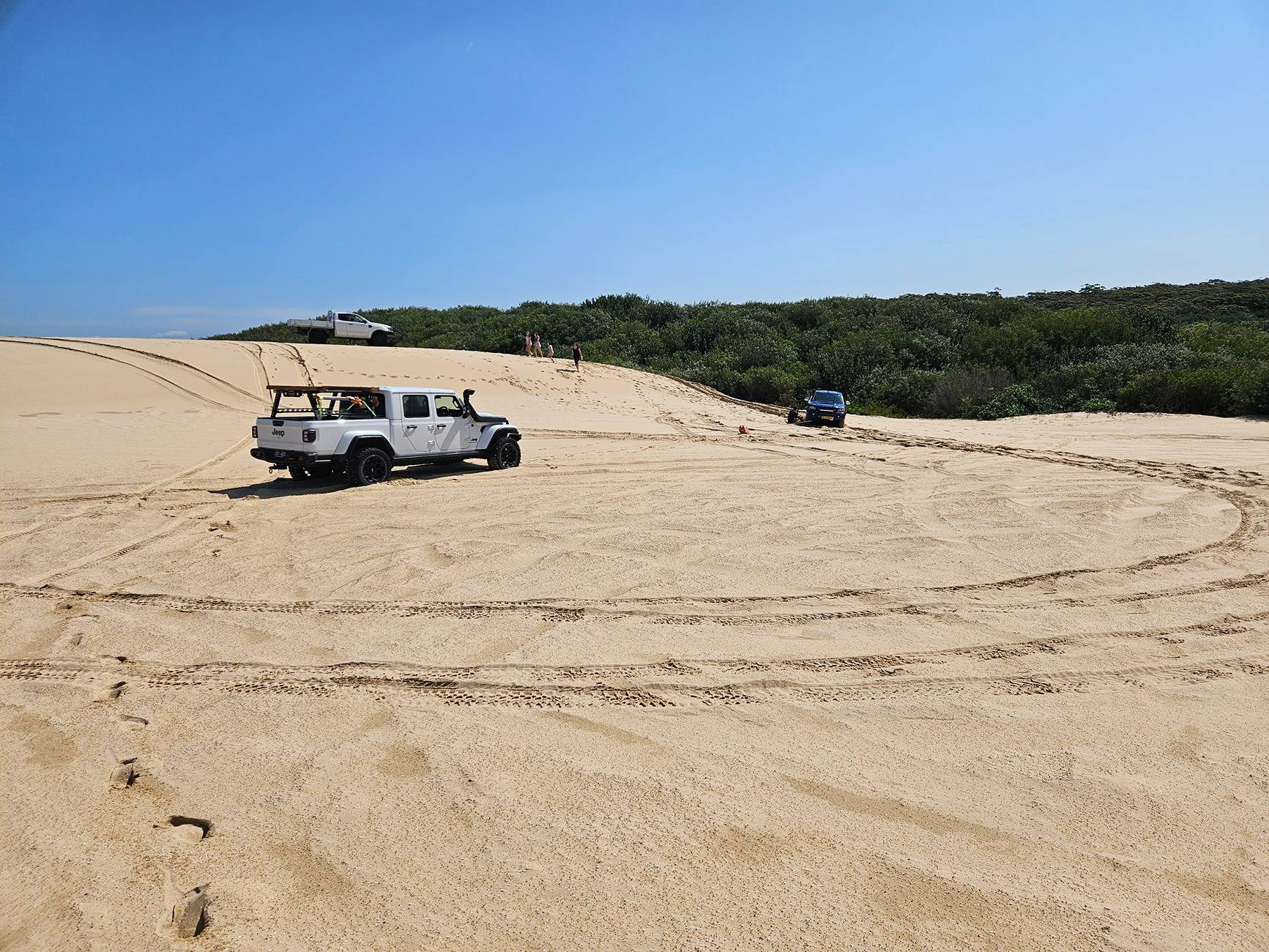

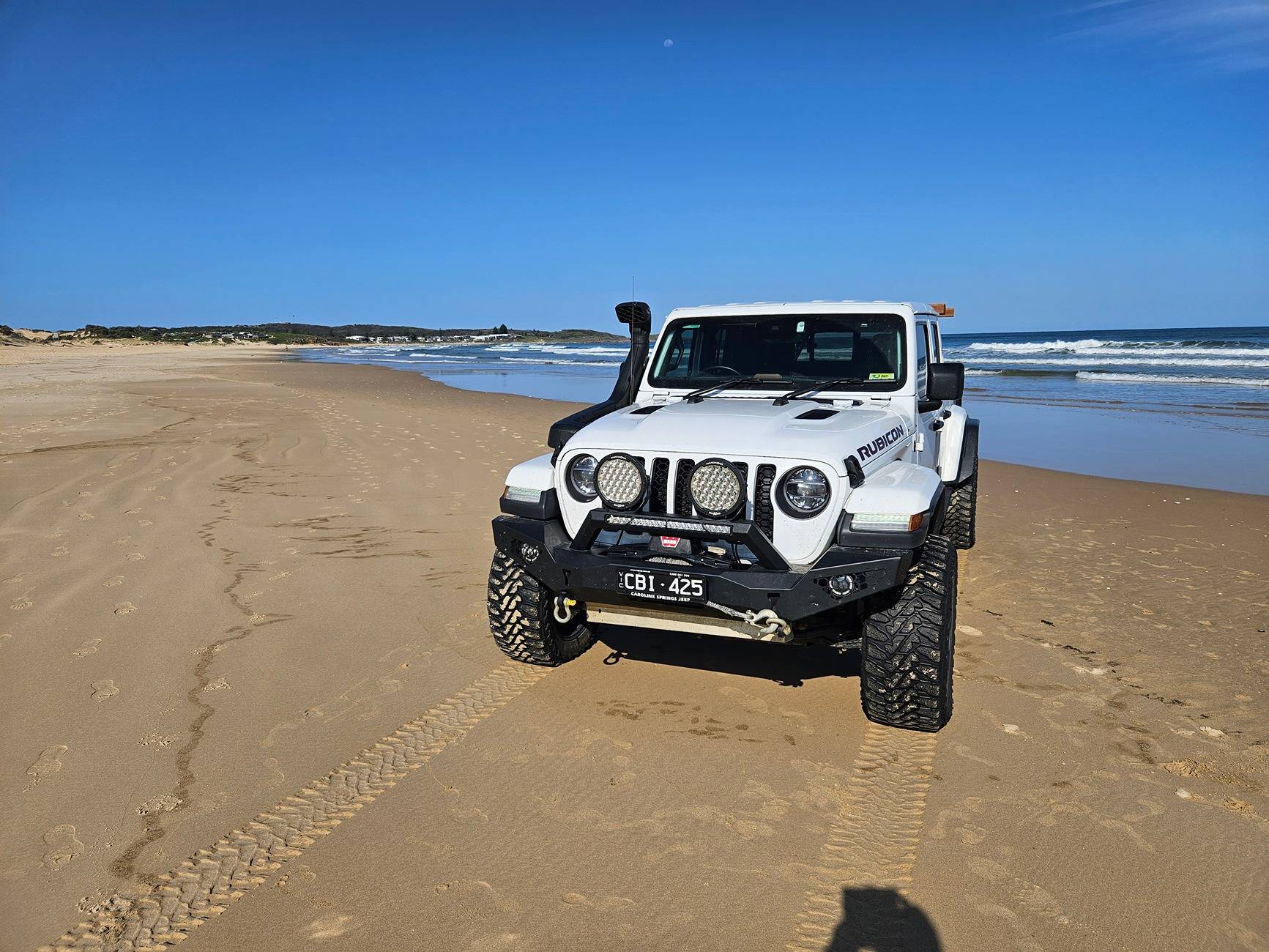

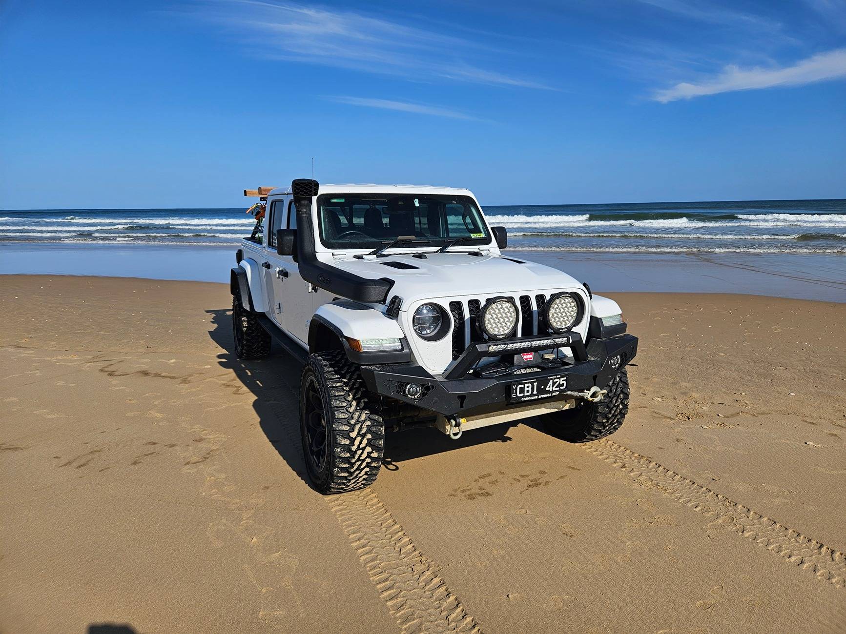

On a brighter note...we had fun 4wding on the beach.
Even winched another poor sound out of a spot of bother...he foolishly drove down over the back side of a sand dune. The funny thing is, you can see from wheel tracks, my Jeep had no issues driving where he was stuck...his car was just burying itself into the sand...gotta love the 12.5 width tyres, makes a big difference. (I know 13.5s would be even better of course)
