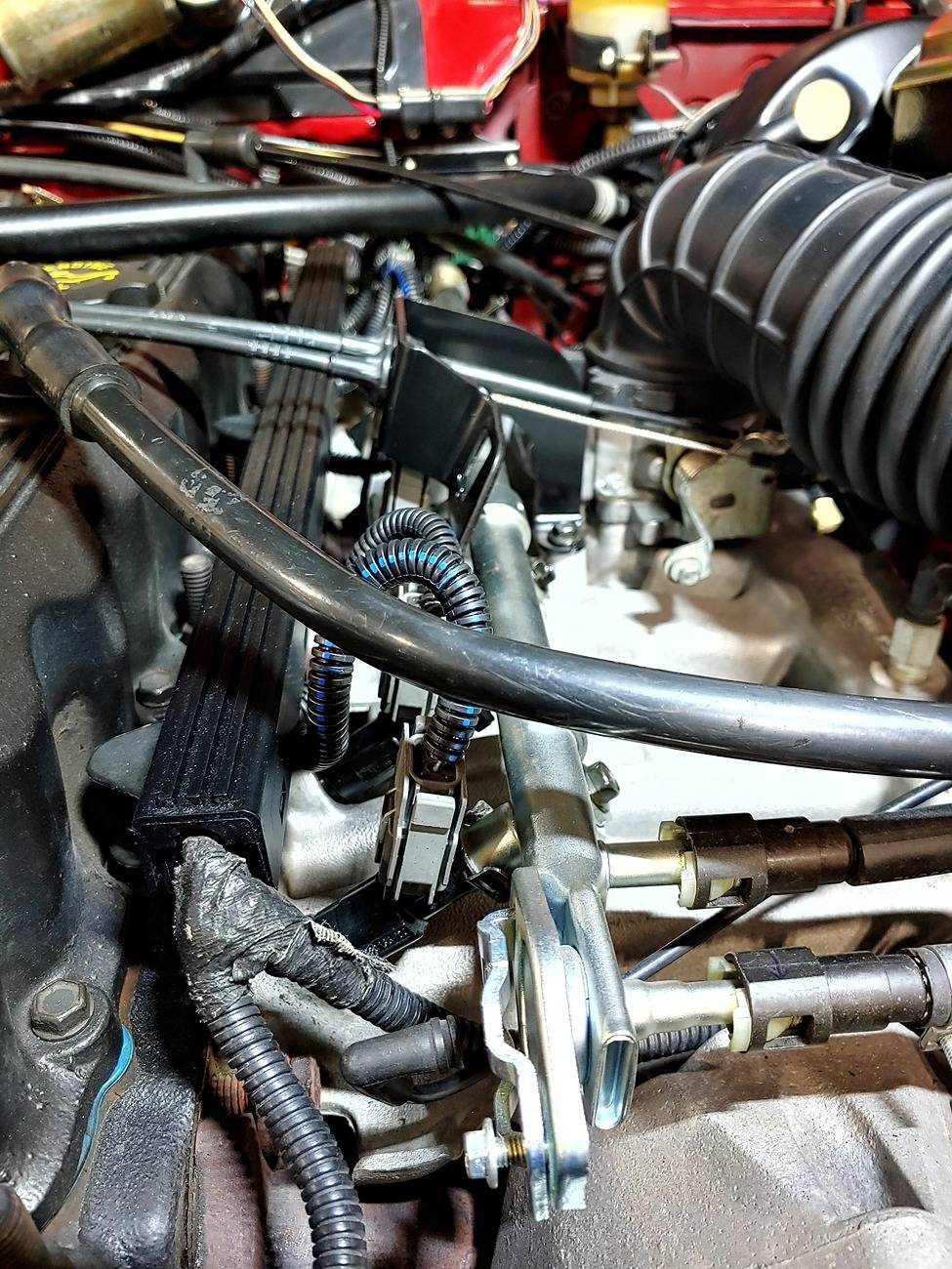

I've done the injector swap and found no difference in either power or economy. So far no one has showed any factual difference with dyno testing.
In theory, it sounds fine, but with enough turbulence of the incoming air, they shouldn't actually make a lot of difference.
This pic is right after I put on a newly restored fuel rail, new regulator, and the Ford injectors, but wasn't impressed.
I have an experimental aluminum head I may put on someday if I get the energy and time.
Already have a Comp cam and roller rockers so it should be ready for other upgrades.
