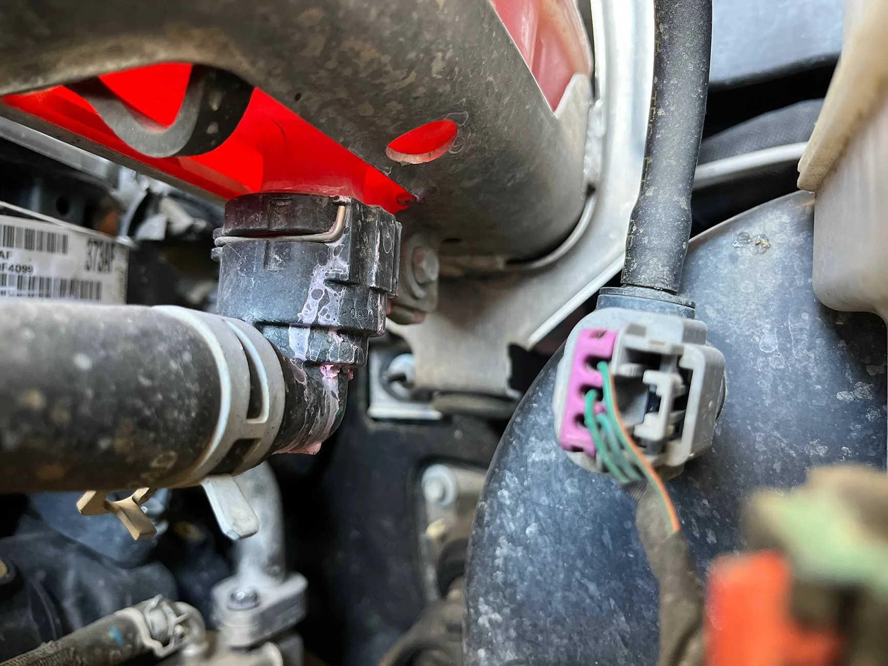

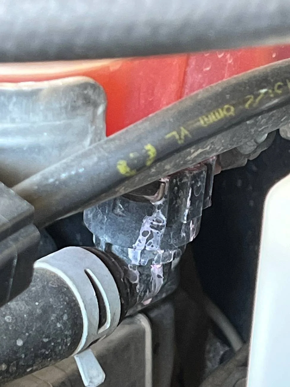

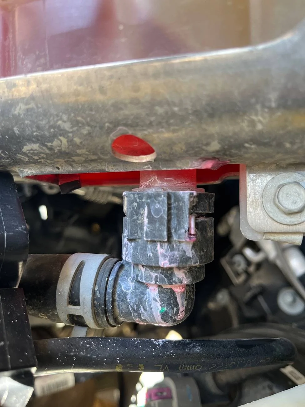

although i could smell "hot coolant"
I smelled ā€œhotā€ coolant on mine too for 1 solid year and couldn’t for the life of me, find it. I searched all over, would keep topping it up and even pulled the rad fan and grill out to have a good look at the rad and hose it clean. I would smell it again and wouldn’t you know…it was leaking at a place I didn’t look, and it was dripping down onto the exhaust and the smell was just always there. Check the hose connection on the bottom side of your coolant bottle. The connection bit that connects to the bottle was my problem and it was evident it was leaking. Upon further inspection, the O ring in the connection had a flat spot and wasn’t sealing, it wasn’t gushing either, just small drips.
Your pics show something that is too often brushed off - traces of deposits that should not have any. Any time you see stains or traces like in those pictures, there is a leak.
The drips that fall from that connector hit the frame and steering shaft and a harness. The splash will then also hit the exhaust.

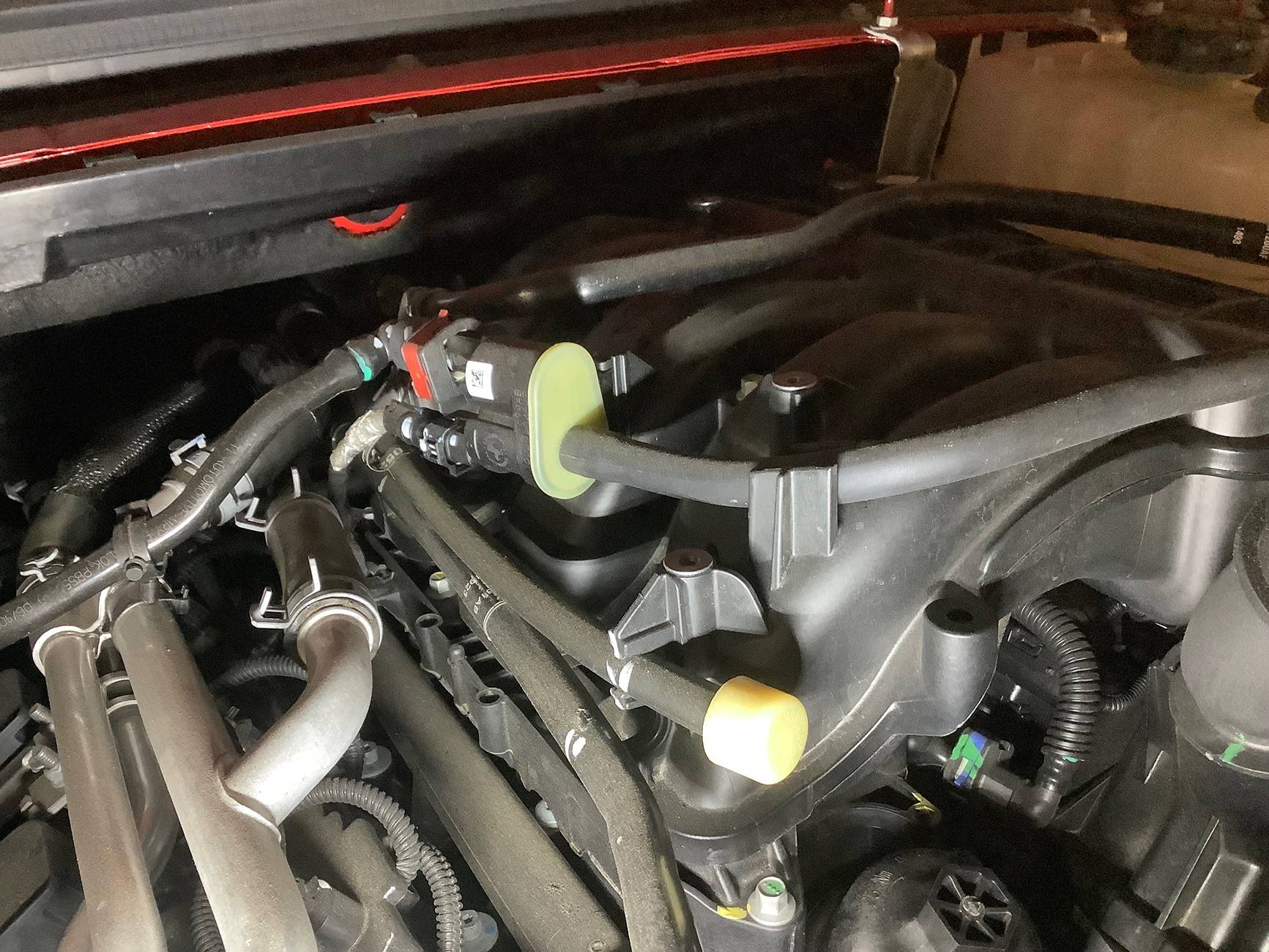

Anyone notice anything wrong in the photograph attached

Oh man...flaming mechanics!
Missing the breather end on the transmission breather tube and if you were hoping for the top heat shield for the engine, forget it, your engine doesn’t need a cover to trap heat in. I tossed mine.
Yep the transmission breather cap.
I have never had the proper cap off, is this what's normally inside the hose(just a rubber plug)?

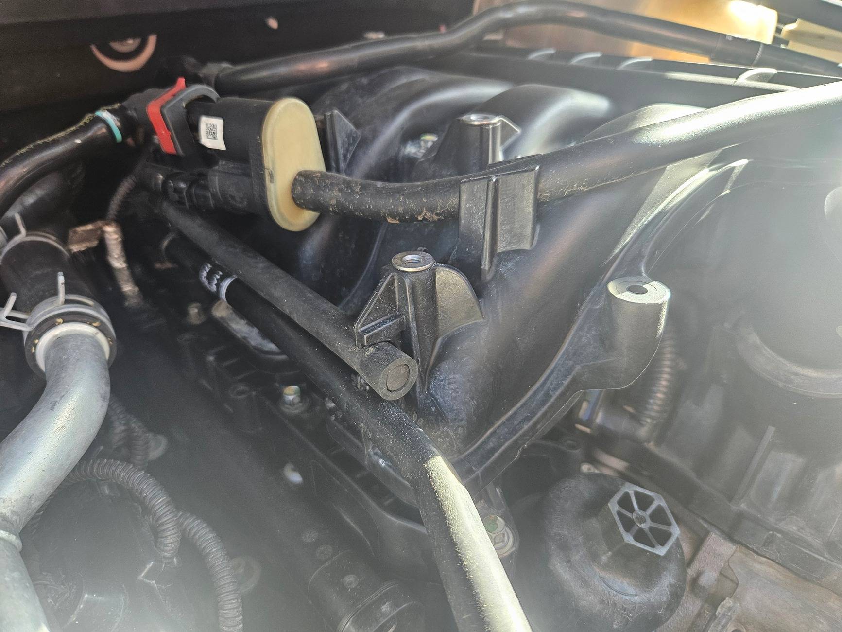

Got me, I’ve never removed it but I wouldn’t think thereā€˜d be a plug there. This is what mine looks like with the breather cap on.
