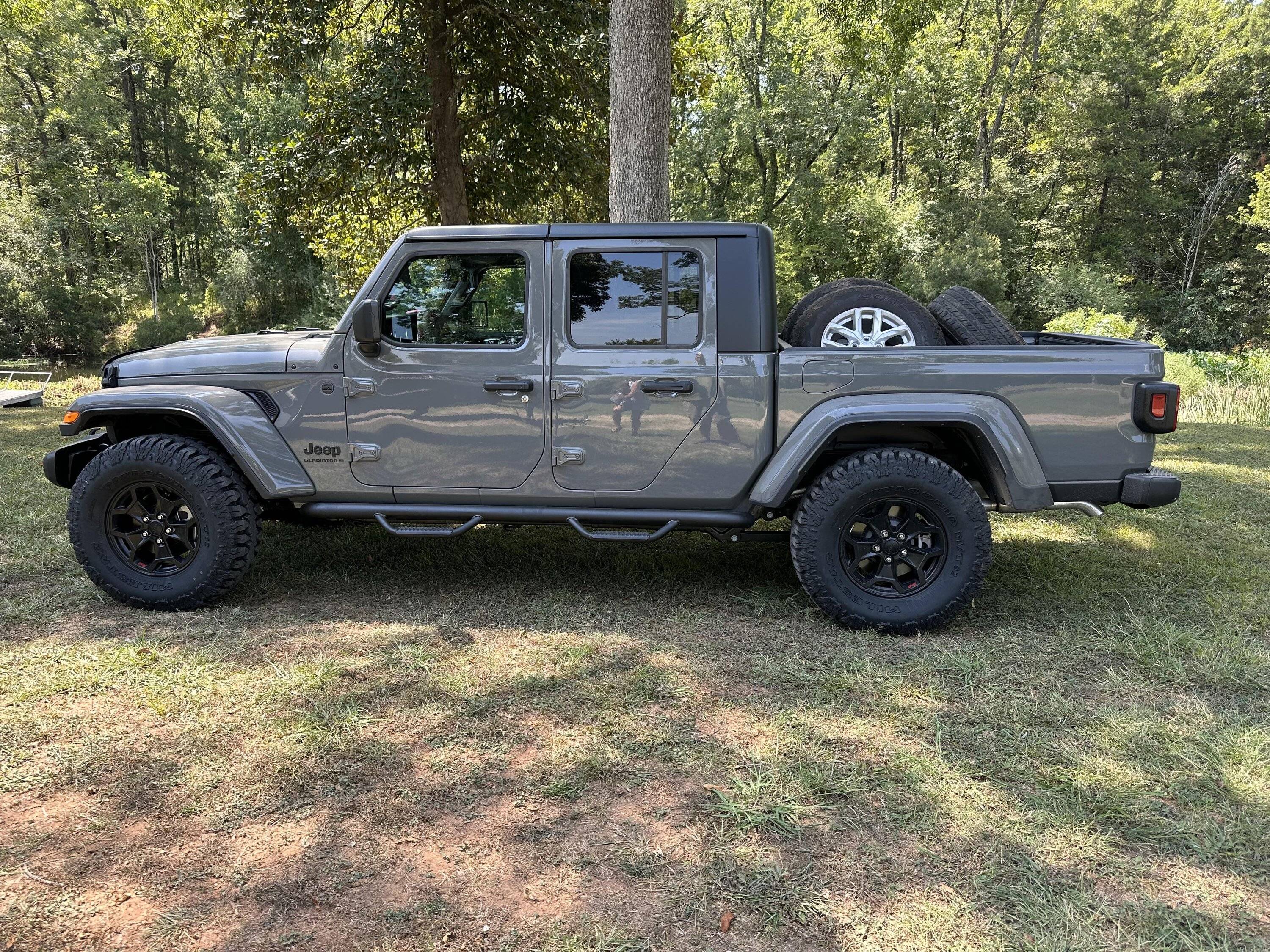

Ended up going with a little less lift so we could keep most everything stock and not compromise the stock ride.
1-1/2" Teraflex Level Kit
Mopar Extended Lower Control Arms
Milestar Patagonia 315 70 17 D8 Tires
We flexed it a little in my friend's yard and around the road ditch to make sure it doesn't rub. Definitely as much or more than she'll be doing.
Wife is very happy!
Jeep Gladiator My Lift Plan Jen's Gladiator Sport
Wife is very happy!
Looks great! I have the same leveling kit. Now I have an idea of what 35s would look like on mine as well. I've been thinking about hunting down some black Mojave wheels first.
