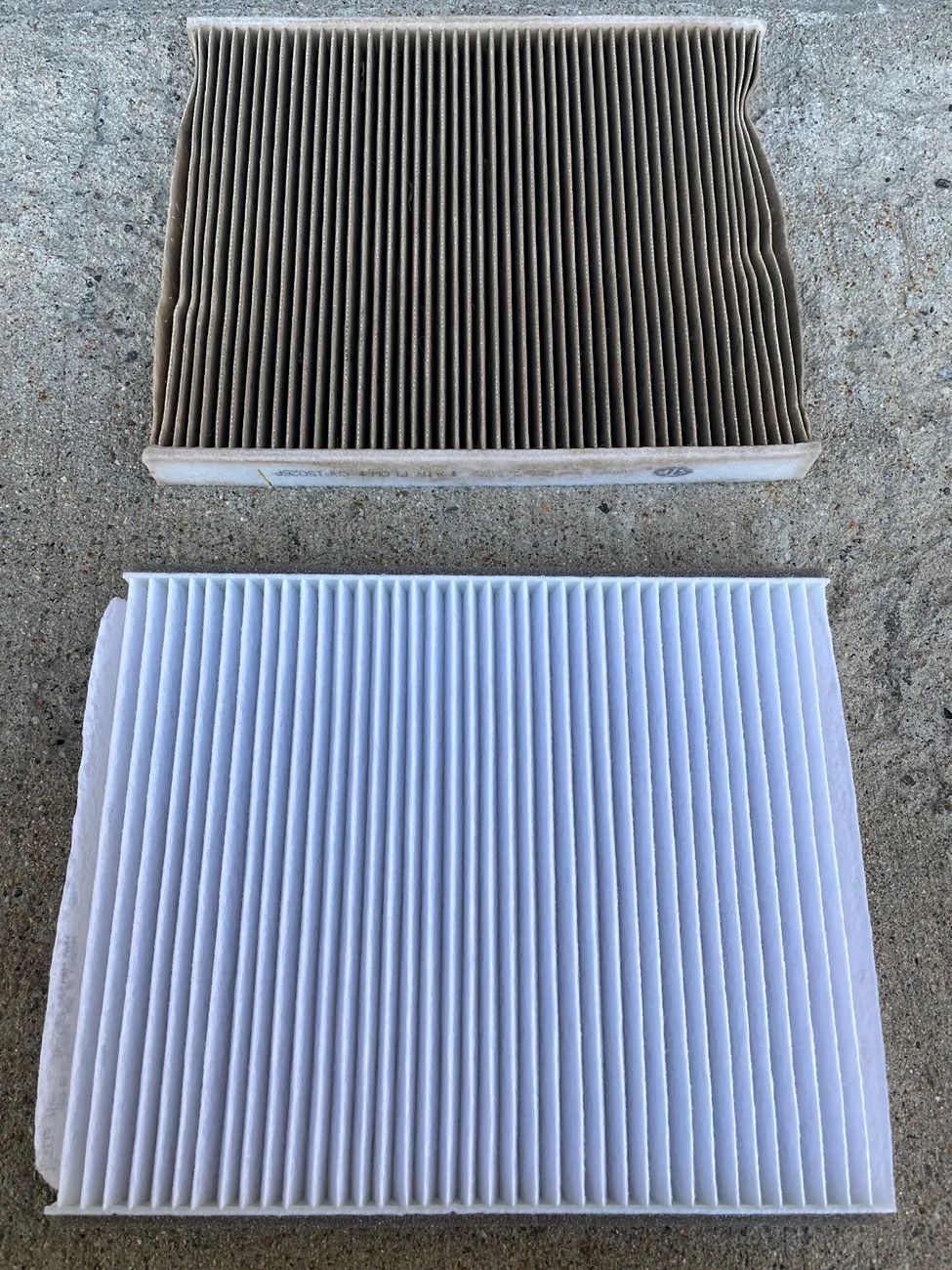

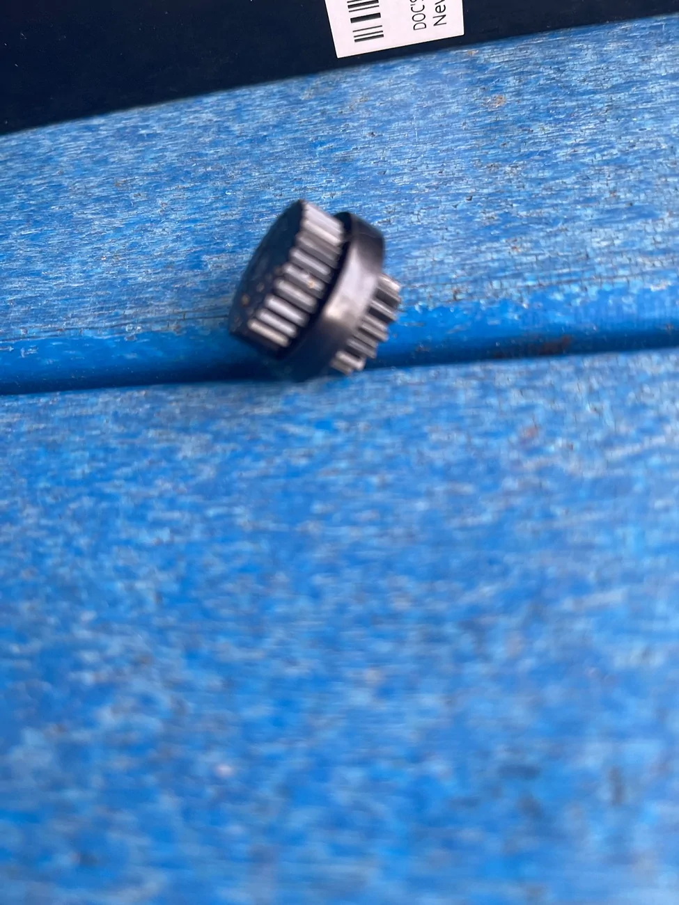

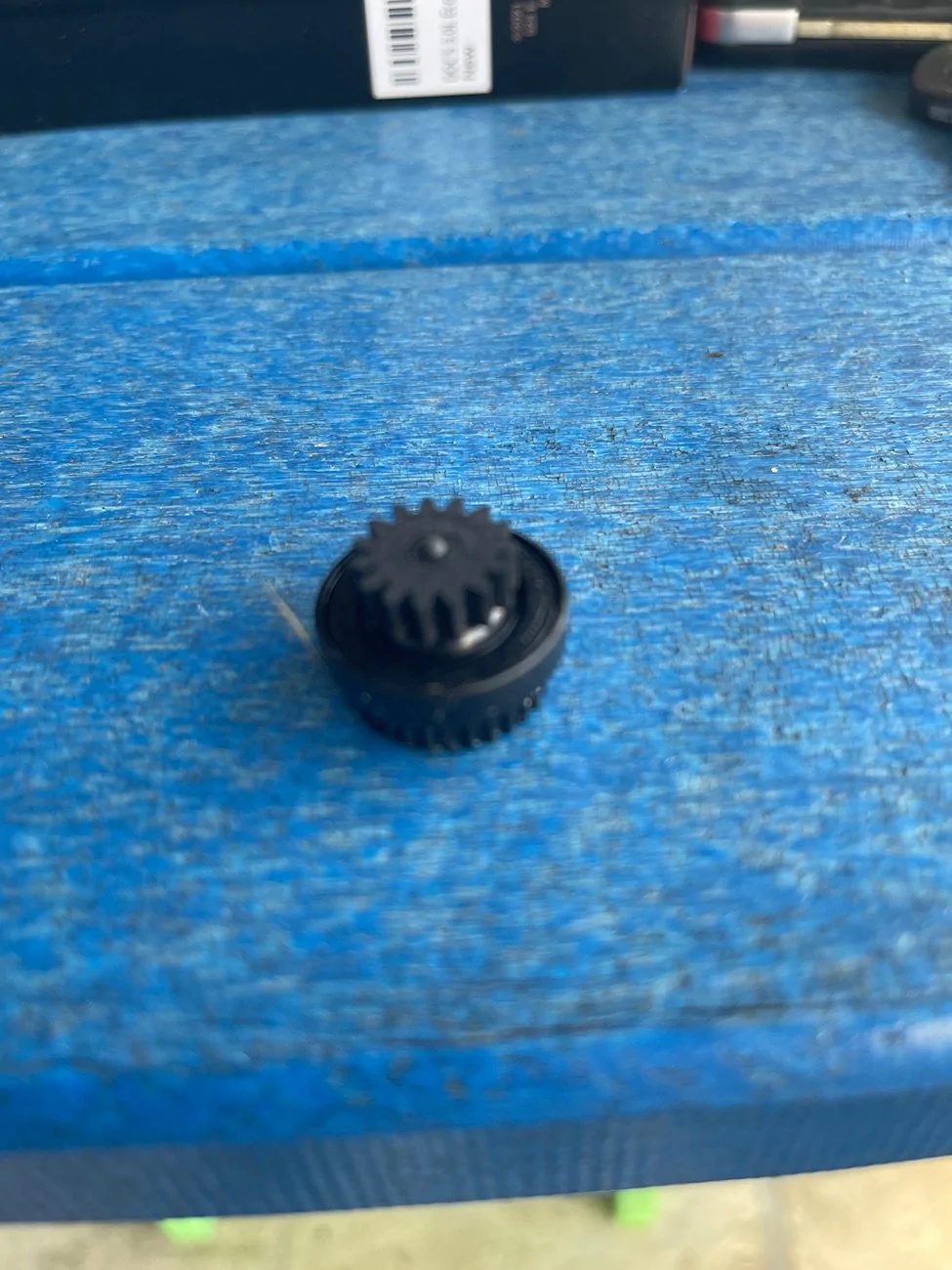

While changing the cabin air filter. This was laying behind the glove box.
Also when pulling the filter. There was only one filter shoved in it.

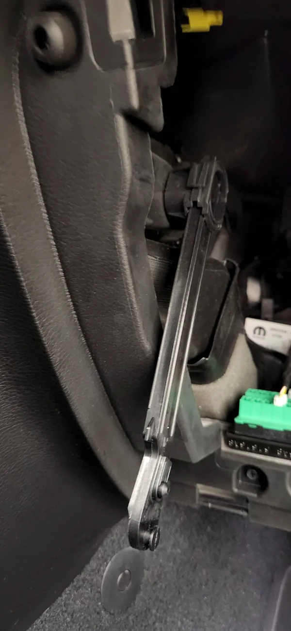

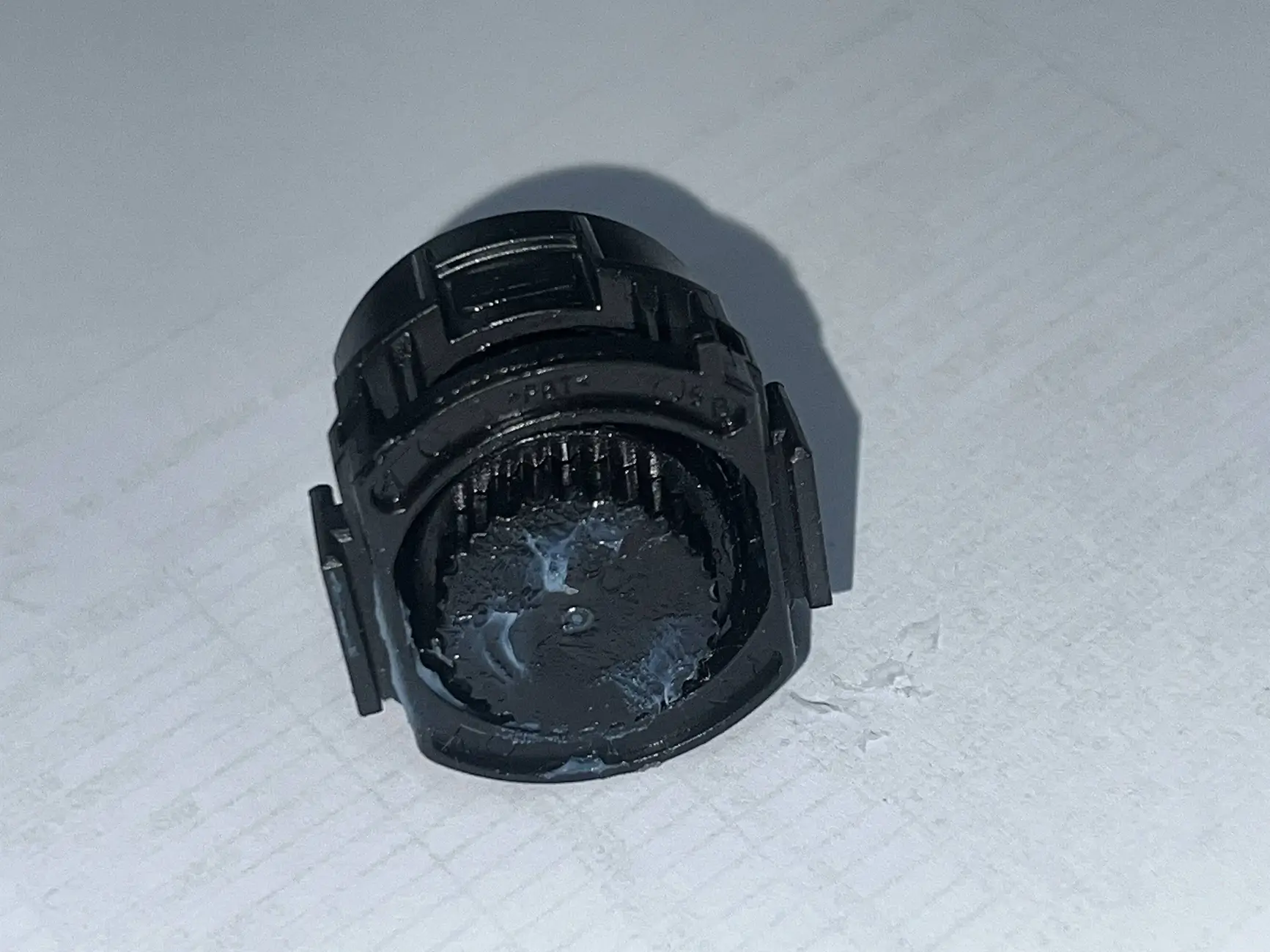

Check the left side of your glove box. That is the gear that allows the glove box to slowly open. It should go back into place easily.

Many thanks my friend. I never thought to look there

Good to know. Mine hasn’t fallen out, but now I’ll know what it is.
It’s normal for only one filter to get compressed and shoved in there. They didn’t do anything wrong in that way. I’ve seen aftermarket filters in two pieces, but I’d rather a single to prevent anything from getting through in between.

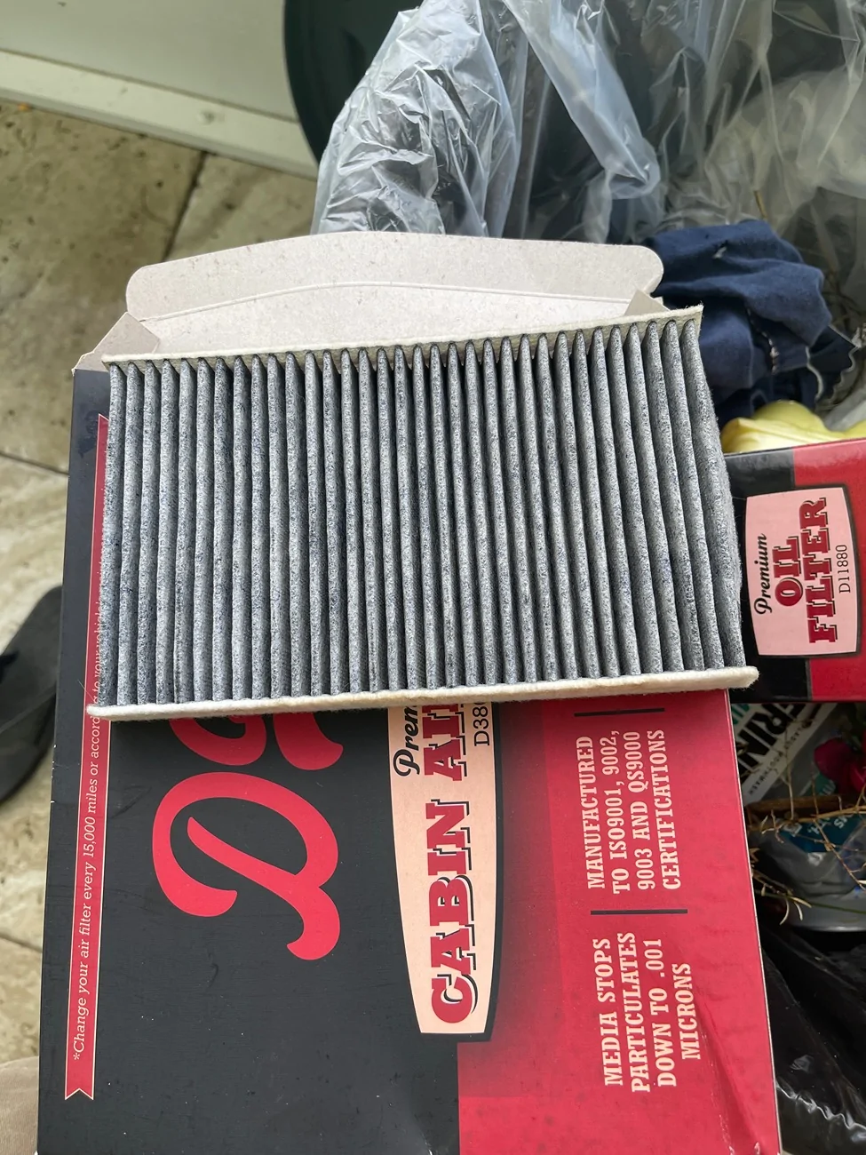

I may have said it wrong. This is all they had in it. That’s one of the two filters that is supposed to be in there

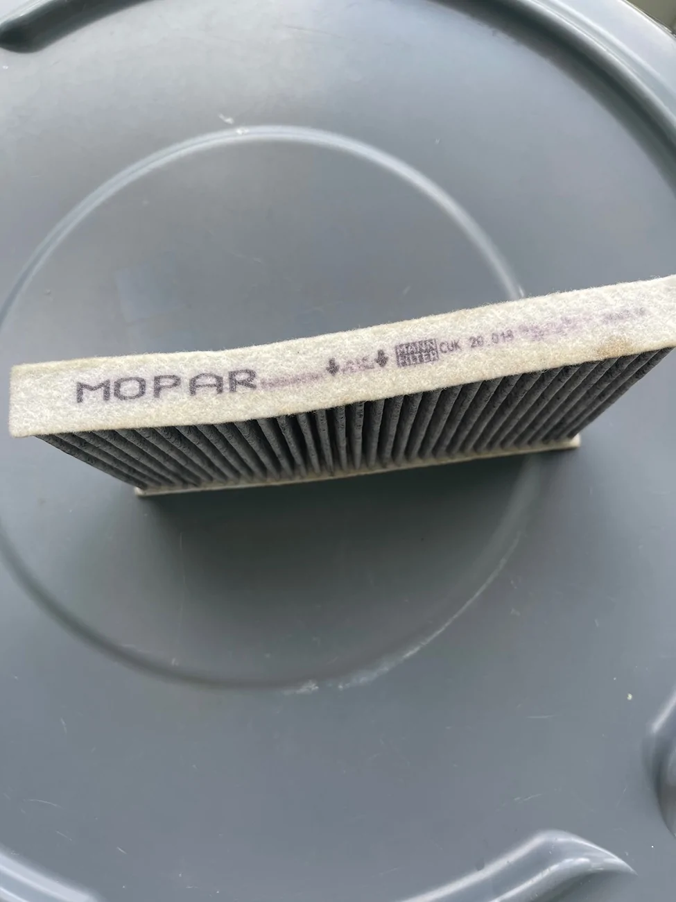

The oem filter is a single piece.

Found a picture.

Half the mopar filter.
Who knows where the other half they were charged for is.

Yep
This one didn’t have that
Very strange. I wonder if they changed this. I’ve done the cabin air filter so many times and I’ve never seen it in two pieces. Including the original one from the factory.
