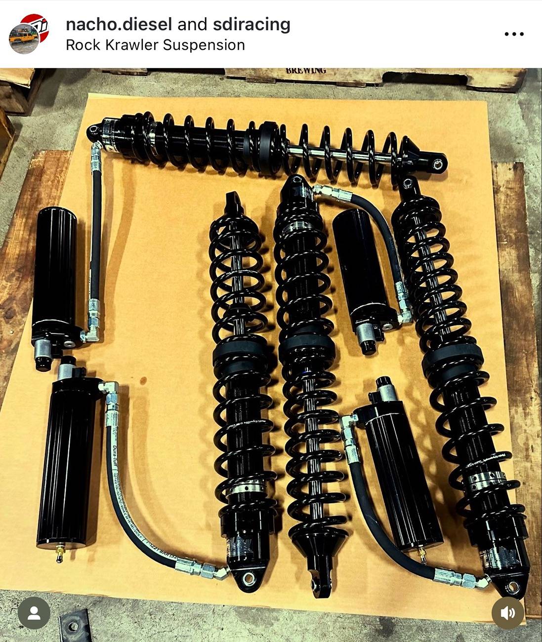

Real time adaptive valved reservoir coilovers going in.
2.625” bodies on the shocks
4” body on the reservoir
Will closely mimic the bounce control of a bypass coilover but offer an enormous advantage in roll control, handling and heavy throttle/braking events

Real time adaptive reservoir coilovers going in.
Those must be from SDI.
They are rockkrawler COs with custom value but they do use the SDI control box, tcase shifter control . Hoping to get a custom software overlay done but time running pretty short on that for now
It looked like their universal kit for 2.5’s. :) you’ll love it.
I spent a lot of time In a bronco this week running a regular midtravel version with the normal 4 link rear and for sure feels better on the road than my gen 2 raptor did. Im super excited to see what its like off road with 16-17” of rear and 14 in the front with perfect seperation and geometry

What axles and gear ratio you running?
Fusion 73.5” wide 4.88 Auburn ECTED with wilwood 6 pistons
Front is a kingpin d60
Rear is a d80
Apparently there was an issue with gear hardening during range of time mine were belt so I could be affected. Wont know till the end of next week. If I am, it’ll be 5.13 instead
Rear is a d80
Do you know how wide the stock Rubi axles are?

I think some people are going to be really impressed by the travel of the suspension. Making 42s travel as far as this will and not rub anything is no small feat. It’s gonna have air bumps and no additional bump above the brackets on the axles
and the fueling system is potentially the star of the show.
