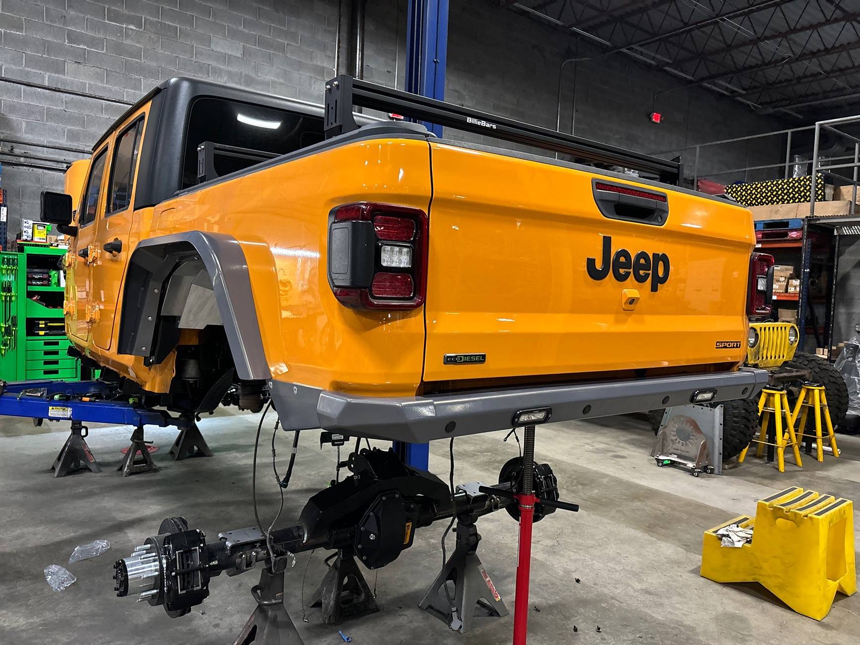

Bumper looks great but where is the license plate going to go? Frenched into the tailgate would be cool perhaps….Jack

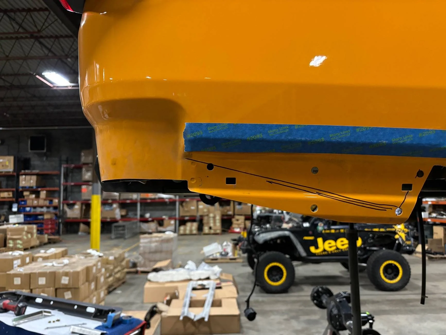

Theres a cool bracket that comes with the bumper for the plate. Its designed to go bottom left on the gate where the diesel badge is but I have another idea. gotta disassemble the gate to see if it’ll work
